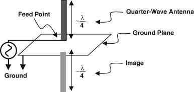

when it comes to 1/4 wave, actually electricity tuning can work the same. A radio tower is 1/4 wave monopole or 1/2 wave dipole tuned, just like sound resonators are, but the speed of electricity in the wire is way different than sound lol
I'm way off topic of thread now haha, I'm just saying like you are though it's sort of the same physics applied differently. 1/4 wave tuning works for electricity and sound both. Top pics radio towers, bottom pics sound tube resonators:

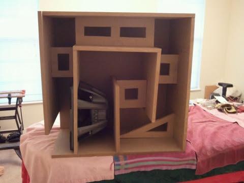

And, that's why we have QUARTER WAVE resonators!
My home subwoofer is a Tapered-Tapped Quarter Wave Tube/Pipe (T-TQWT/T-TQWP) or negative flare Tapped Horn.
Hofmann's Iron Law = efficient, low, small...pick 2.
I chose low and small.
Positive flare = efficient & low.
Straight flare = ease of build, no angles.
Negative flare = small & low.

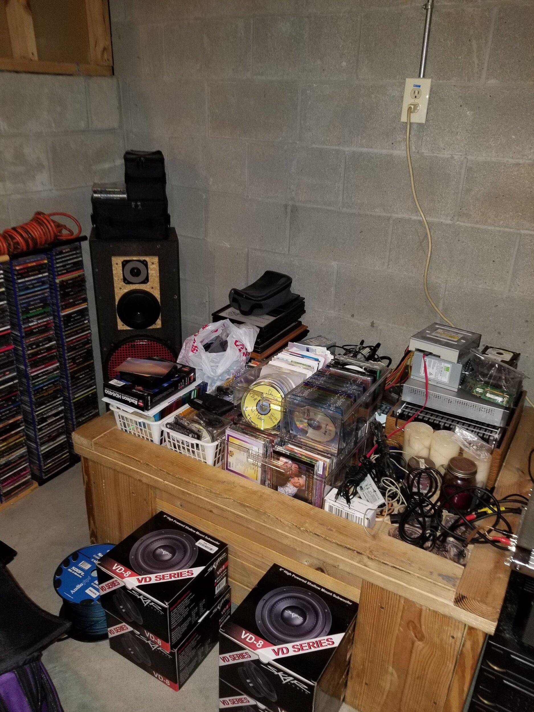

There is a 2 x 12" BP4 enclosure bolted underneath this coffee table. I built the table in 1998. I originally built the enclosure for 4 x sealed 12's for my brother's Ford Escort. 1 of these days I'm going to build another enclosure for the table, like a TH. The Lightening Audio 12's are making noises like the surrounds have deteriorated.
