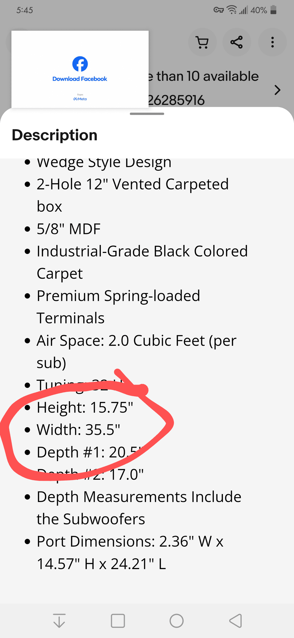

Does anybody have a way of finding out if skar’s dual 12” EVL 5000watt subwoofer is able to fit in a 2007 Saturn aura XR for me?
Probably not.
Mocking up an enclosure out of cardboard is easy, although testing fit may exceed most users nowadays. That said an enclosure of 4ft3 net with less than 35in2 of port may limit output imho. 23mm excursion and +1200w power handling? Prefabs suk... we all know this. Add insult to injury with 5/8" materials?
My Evl-12s were in 5ft3 net tuned 31hz with 80in2 of port. A pair of CAB 1600s strapped @ 1 ohm was enough to get rowdy.

It played pretty solid down to 24hz That Skar prefab Op is looking at is 4ft3 net supposedly with under 35in2 of port? That port area is under 9in2^ft3 and will likely limit output in my experience. Most likely the enclosure is divided internally and not visible because of a grille over the port and has like 32in2 or so of port for each 2ft3 chamber. I just tried to look at the website and the numbers don't jive with the screenshotted ones above so who knows?
