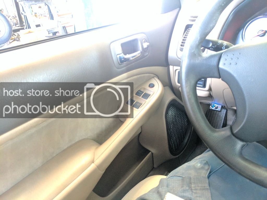

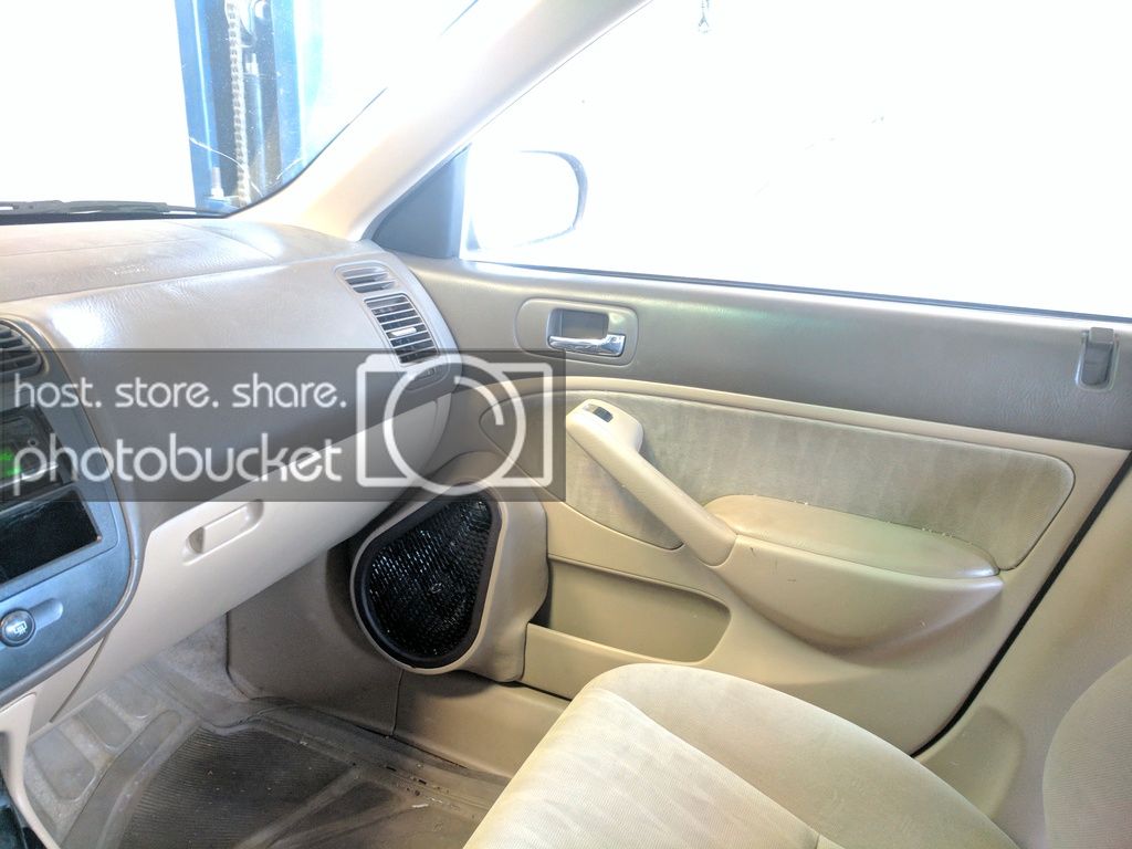

Upgrading the front stage some as well. Picked up a set of Crescendo PWX 6.5's and some Crescendo STS-1 tweeters. Having door pods built from them the week after next. I'm sure it still won't be up to par for the sub stage, but it should still help some.
