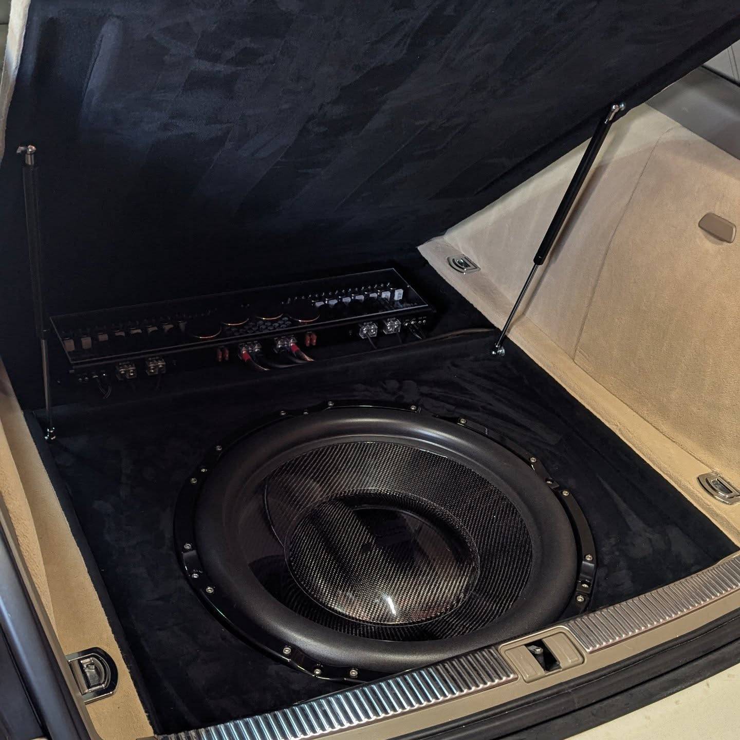

Featured '24 Civic 24" subwoofer
RIP CA.com.
10 pounds of shit in a 5 pound bag.

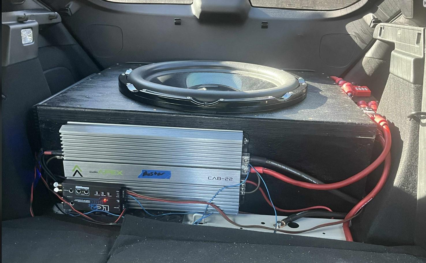

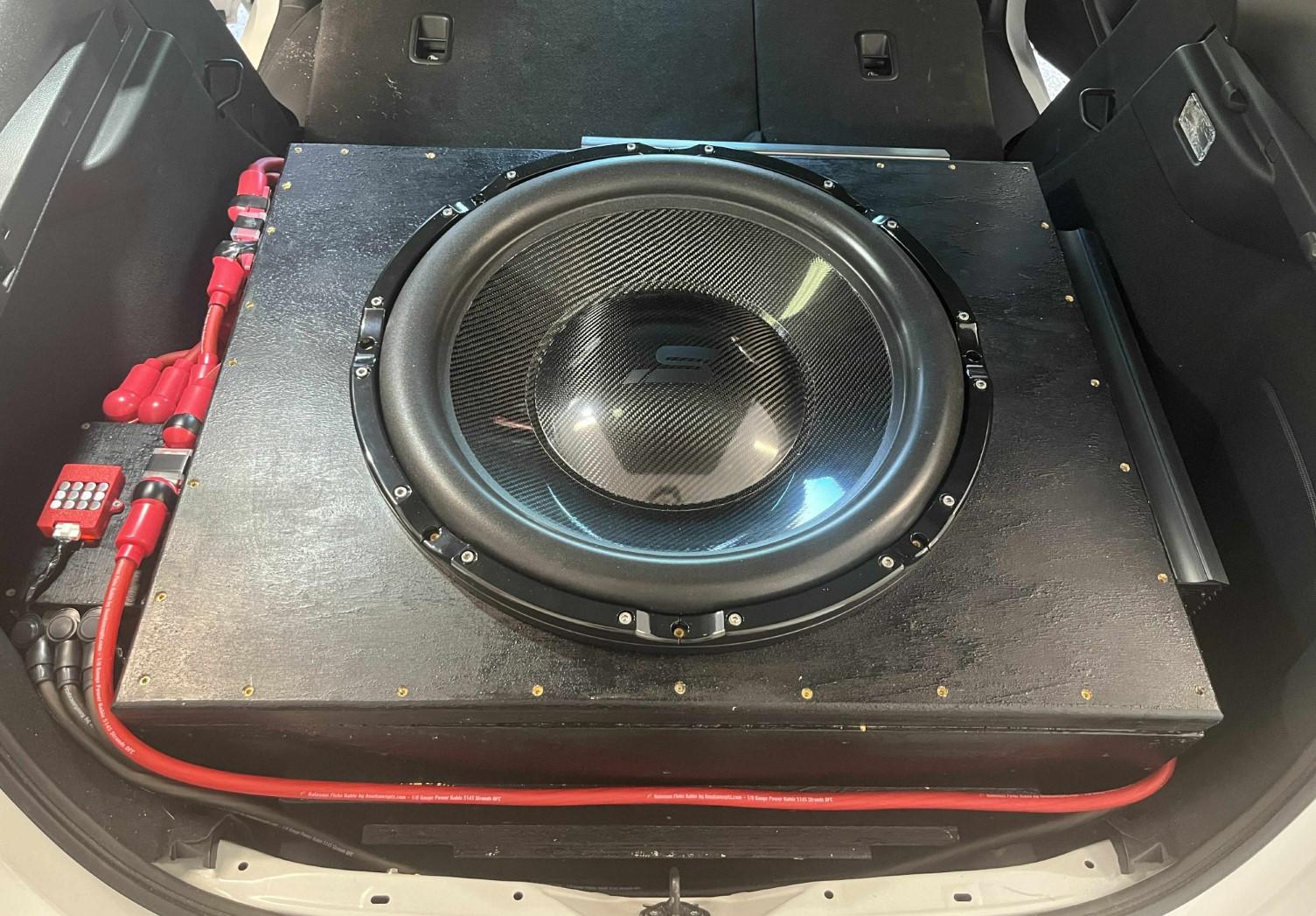

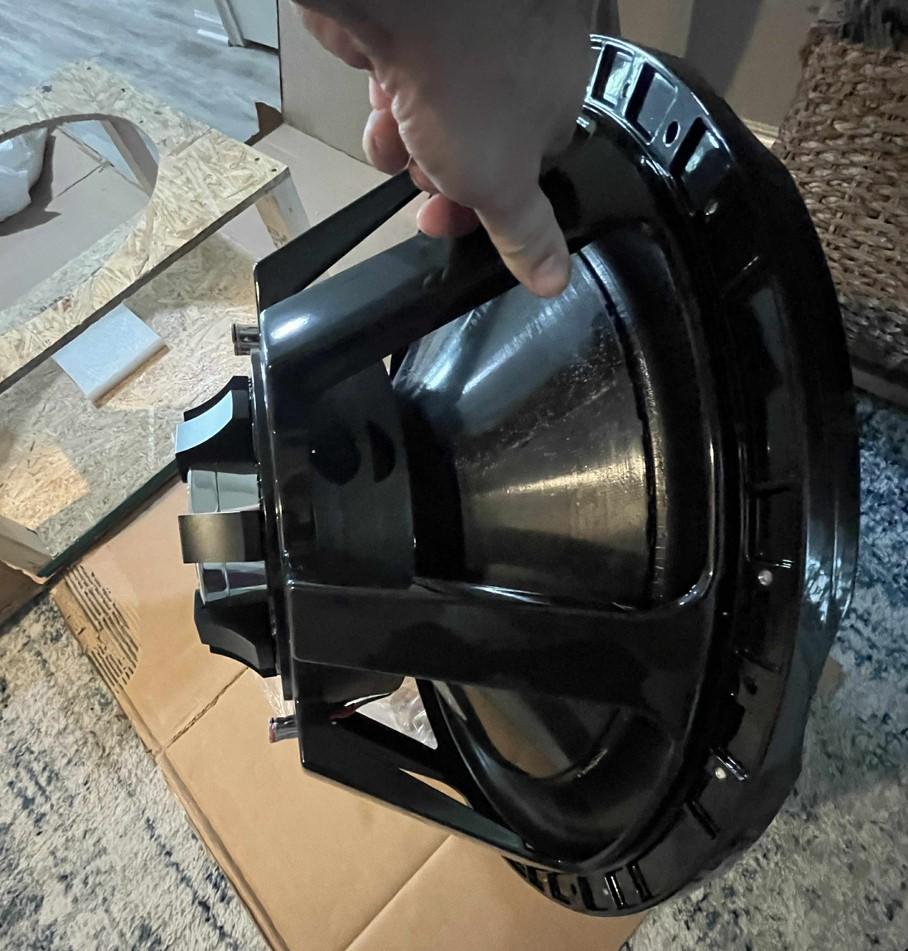

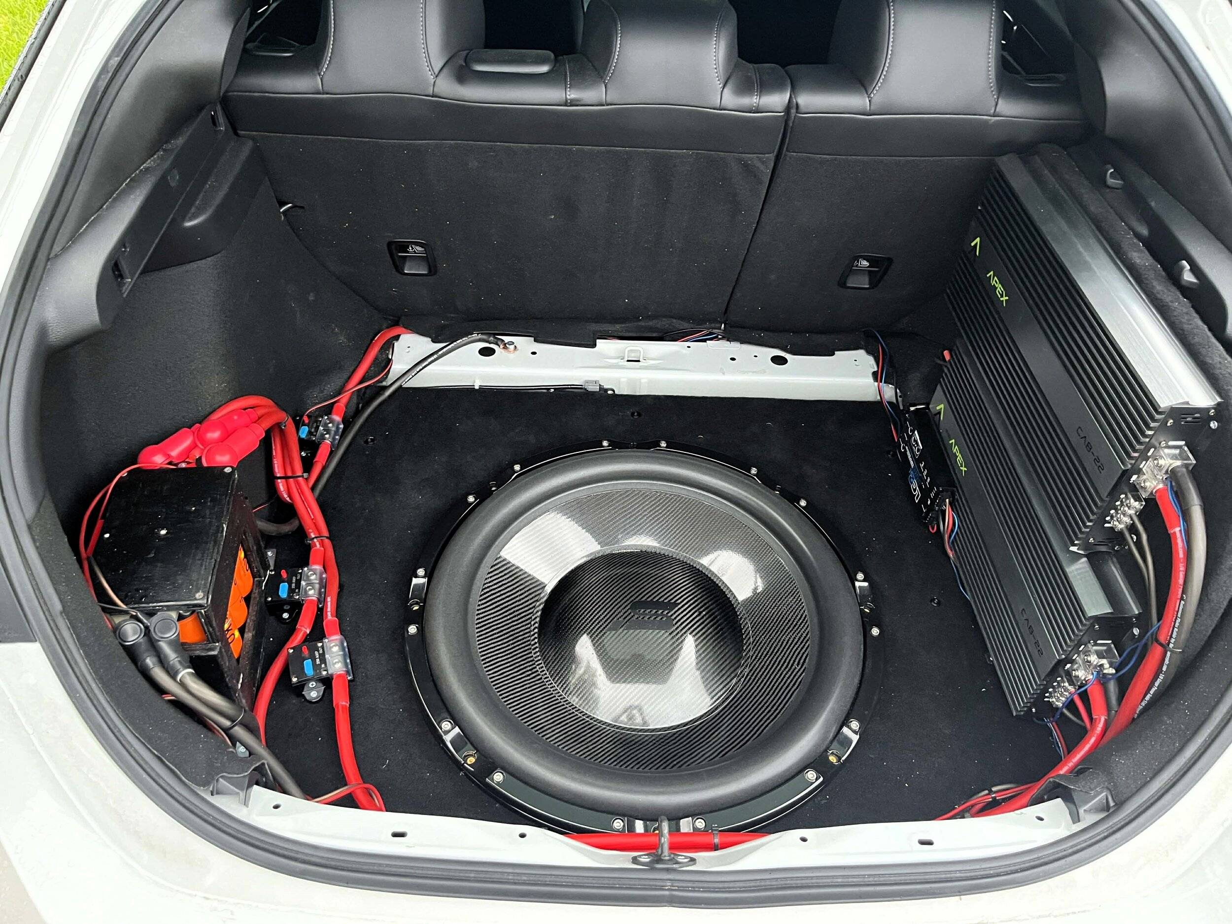

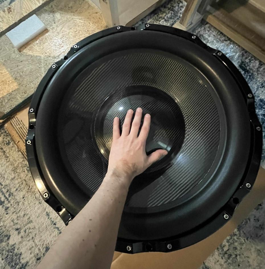

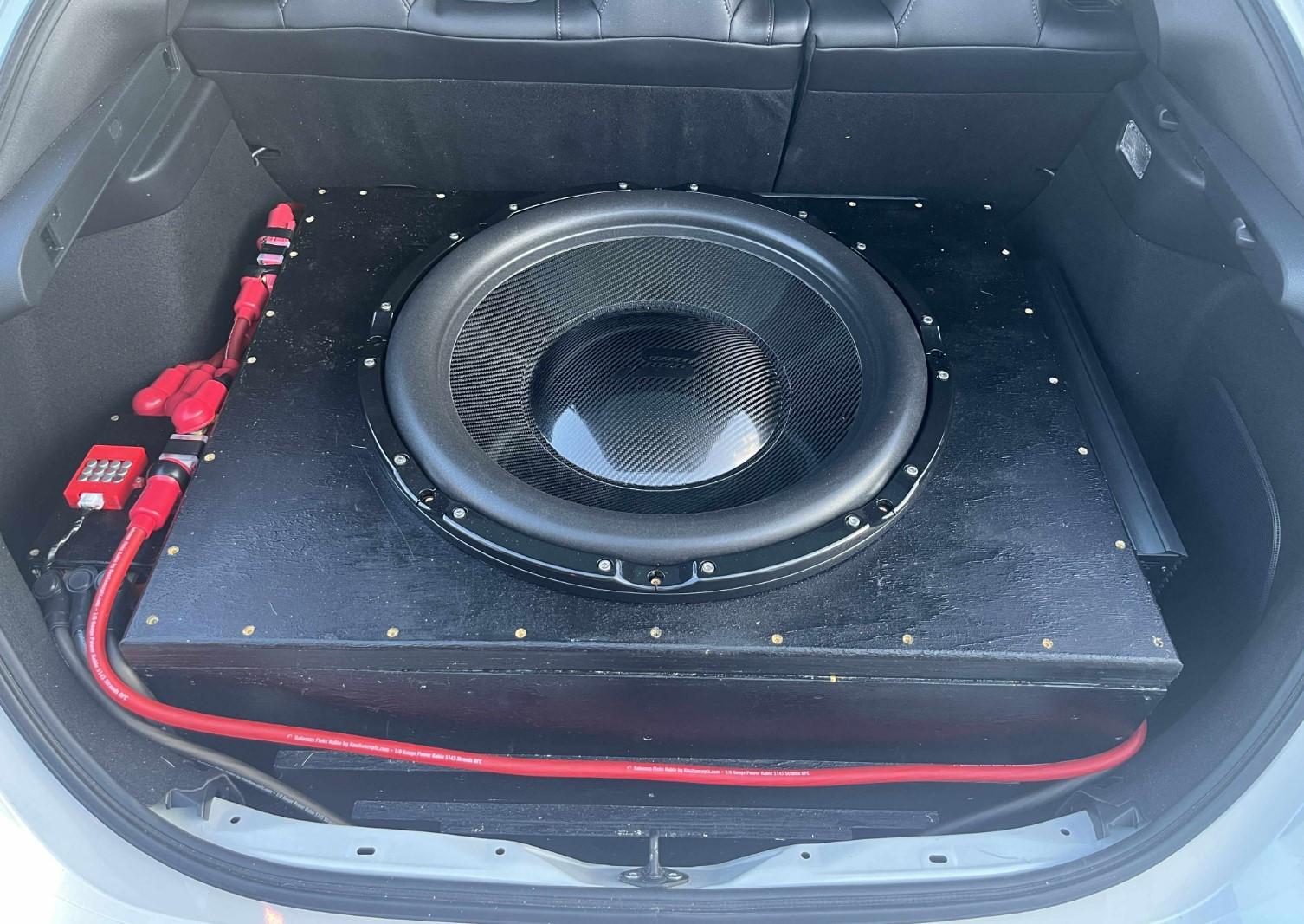

Stereo Integrity HFS 24" subwoofer
Two CAB 2200s strapped.
36ah of sodium lithium.

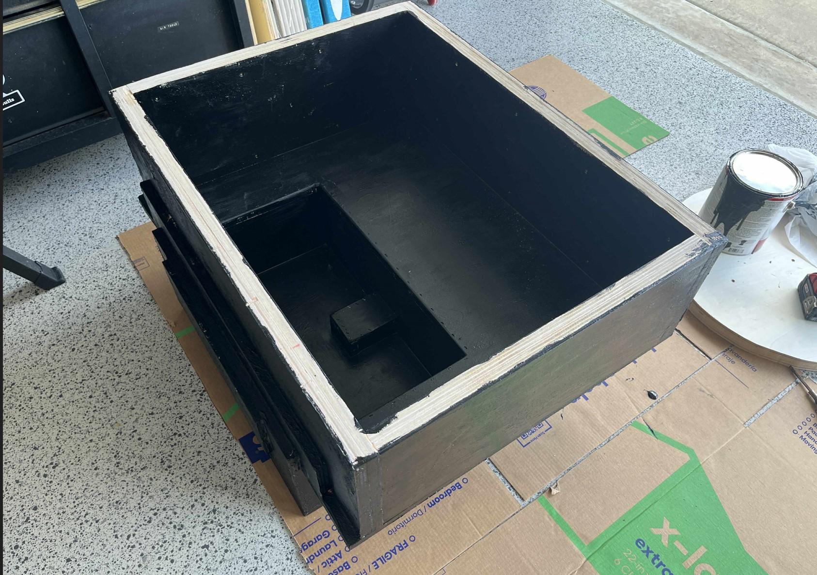

5.0 cubic foot net box.
Still have to clean up all the wiring and hook up a volt meter but it's in and playing.

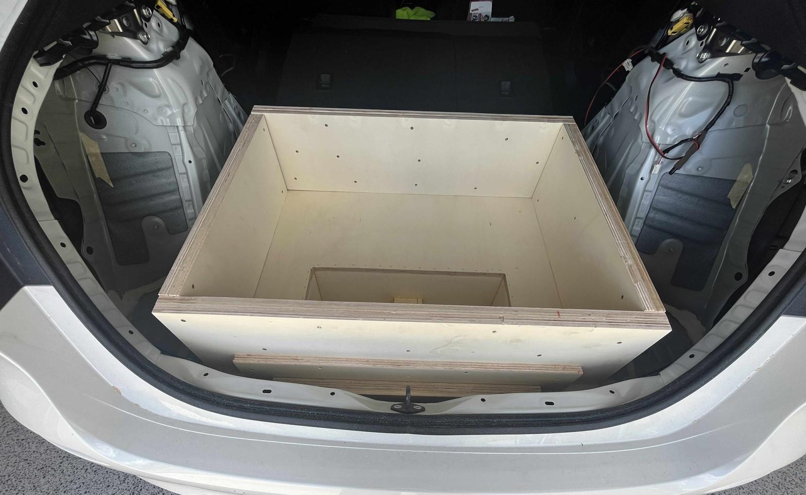

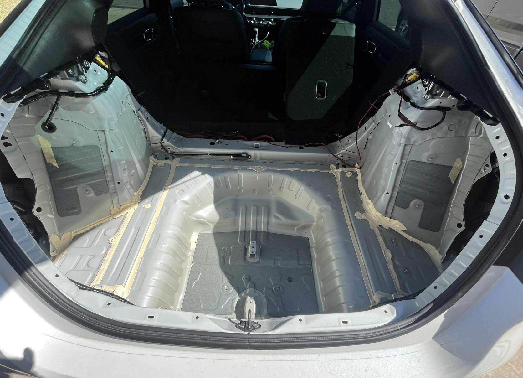

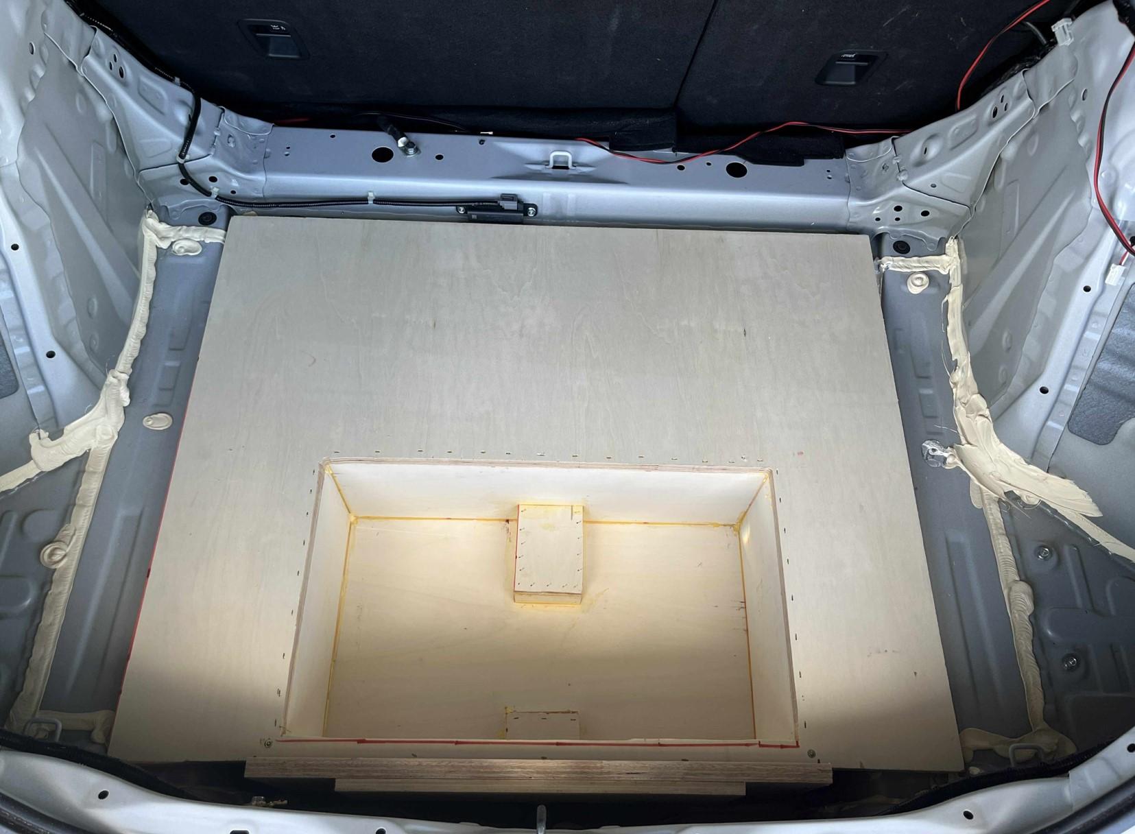

Got 1.25 cubes out of the spare tire well.
Mock up.
Very tight but everything fit behind the seats.

  1. Okay

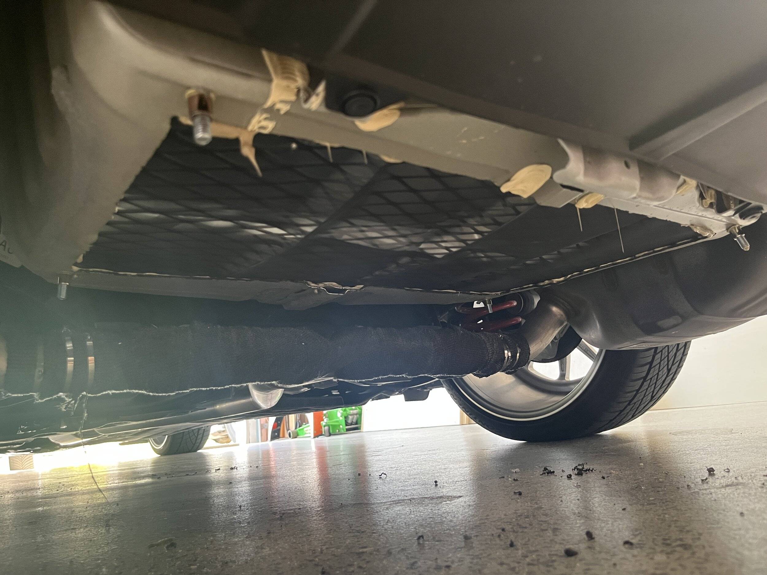

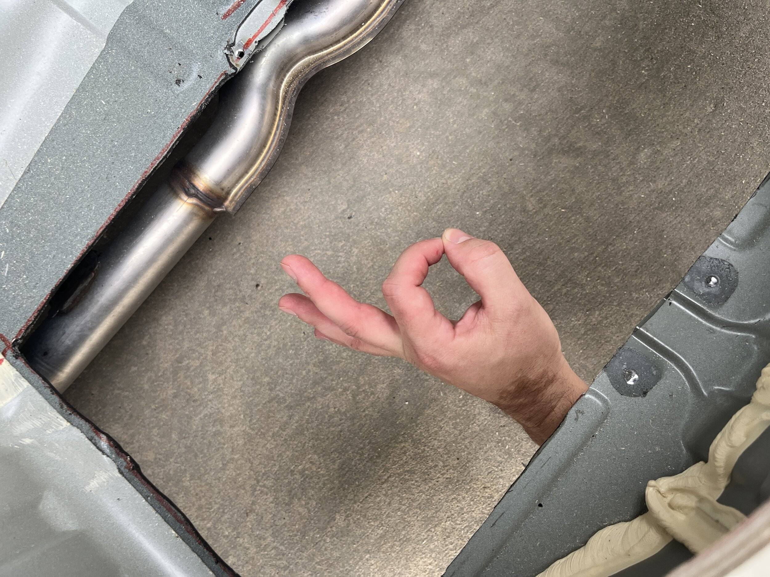

Update...

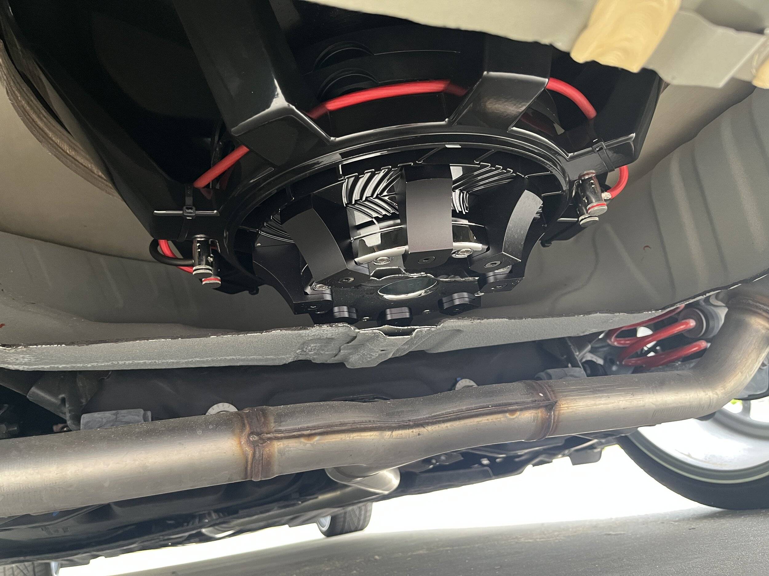

Hit 10k miles and decided to ruin the car.

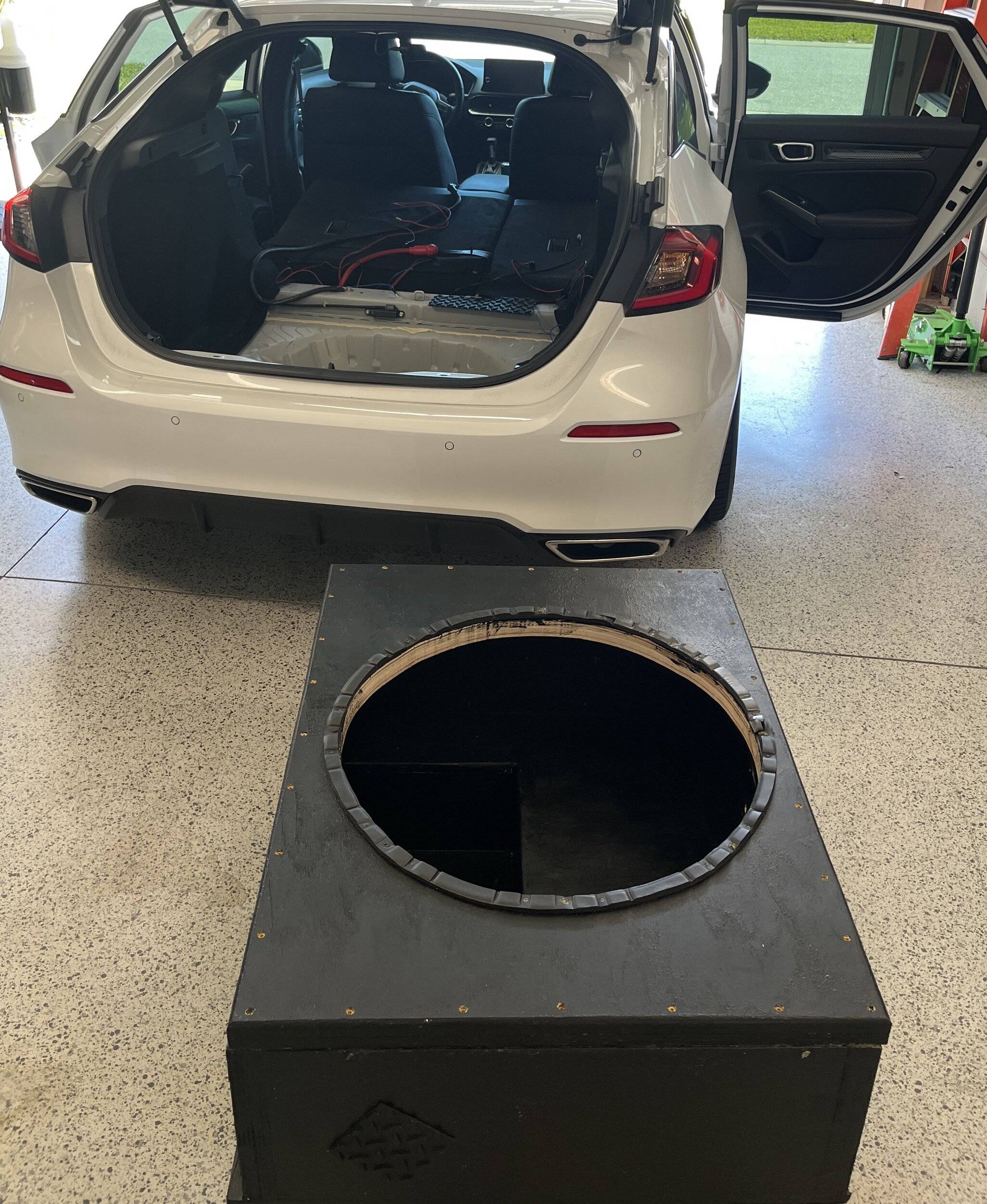

12x20" hole.
Hydrophobic mesh to keep out the rain. Exhaust heat wrapped.
Have to move the LC2i pro behind the amp rack and then build a false floor to cover the subwoofer like the Stereo Integrity Audi build.
