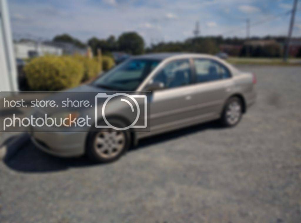

Been needing a cheap beater car that doesn't kill me on gas like my Tahoe does, so picked this up for $250. Yes, $250. Had to replace the cylinder head due to a broke timing belt, and a few other things as well. But car was otherwise in good condition.

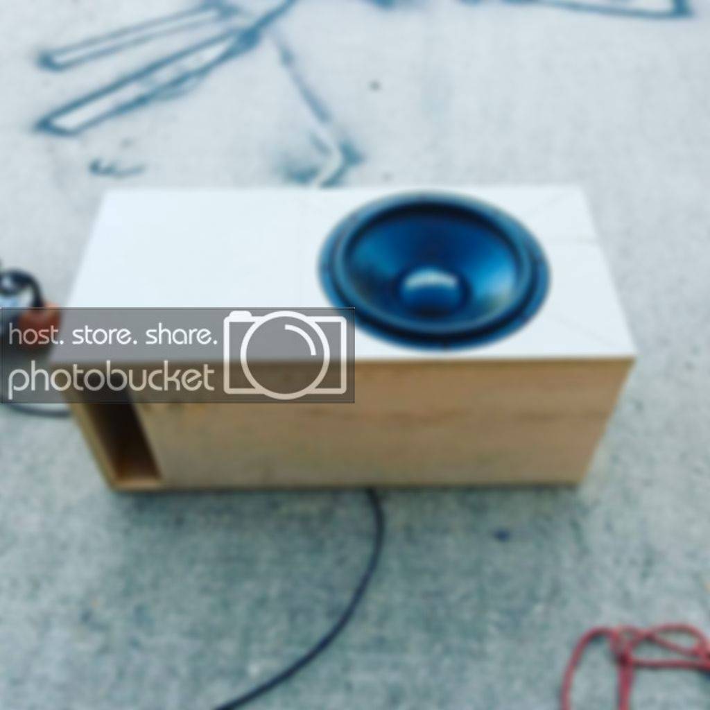

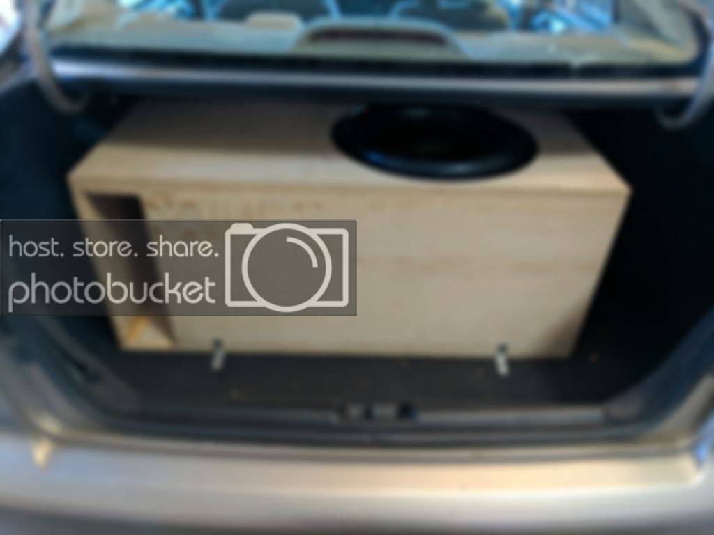

Originally, all I wanted was to take the Sundown SA-15 and SAE-1000 amp out of my Tahoe, and put it in here...which is what I did. Had a local shop build a box for me. 3 cubes @ 33hz.

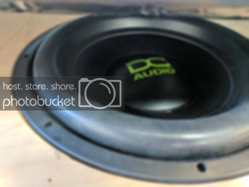

Picked up a DC Audio Level 4 15 and a DC 2.0k. Ran a run of 1/0 CCA wire, swapped out the underhood 51R battery for a Autocraft (Advance Auto brand) Group 34 AGM and added one in the trunk as well.

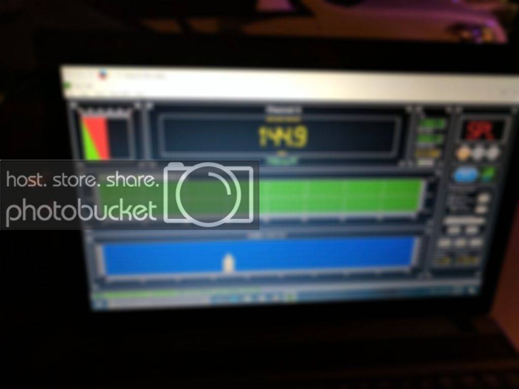

Back on the meter and got a 143.6 sealed and a 145.1 outlaw. This big of a gain made me want to shoot for higher numbers, and got me to thinking about 150.

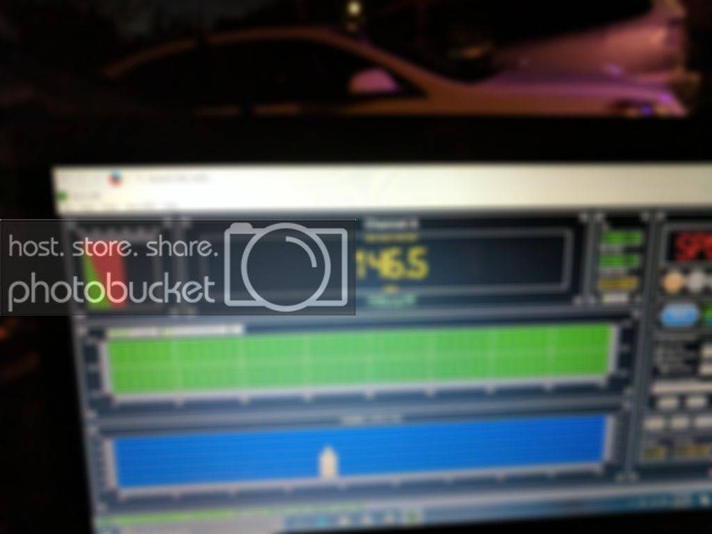

Ordered and installed a XL recone for the Level 4, with a d1.4 coil, wiring to .7 ohms. Put maybe 4 hours of play time on it, and went back to the meter.
With NO other changes other than the recone, I went from a 143.6 sealed to 144.9, and from 145.1 outlaw to a 146.5. I couldn't, and still can't hardly believe I got that much of a gain. I was HOPING for maybe a .5 gain, and expecting .3. But got 1.3 and 1.4 gain.

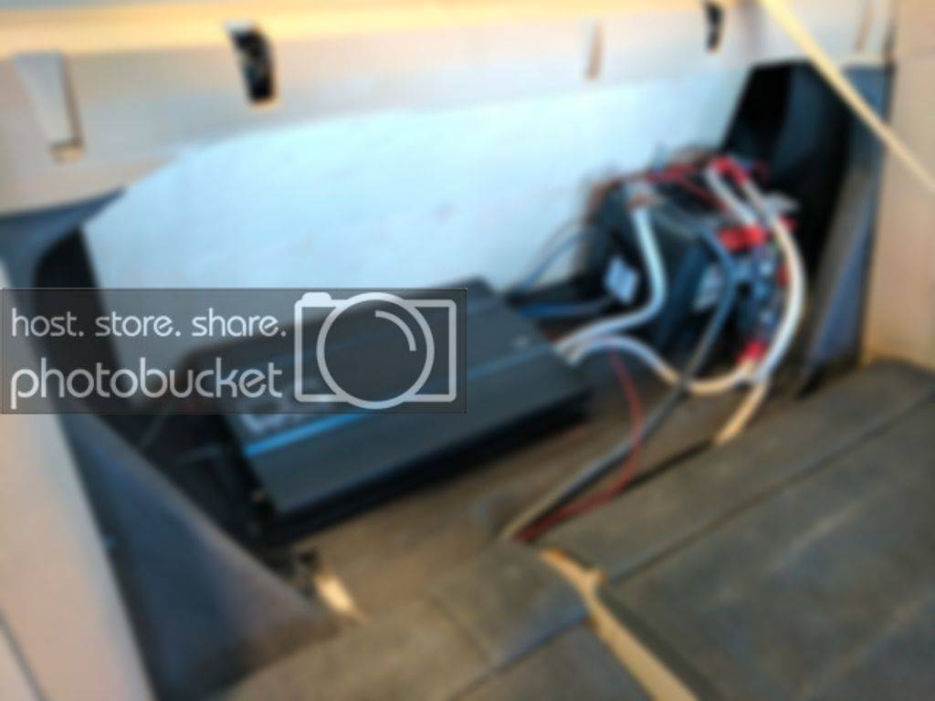

Still not good enough, I'm redoing the entire setup. Doing a new box. 3 cubes @ 32hz, but doing port/sub forward and sealing off the trunk, new 1/0 OFC wire, new RCA's, new amp rack and moving both amps to the rear, new mids/highs amp, moving battery to a different spot, etc. Tearing it down this weekend and will start putting it back together. Going to see how close to 150 I can get with the box change.
^Ugly wiring will be made less ugly when I rewire it all.

I'm pleased with it for the money. Well built (45s in the corners), double baffled on the sub, and braced. Can't complain much about it, and especially happy with the numbers it's given me.
