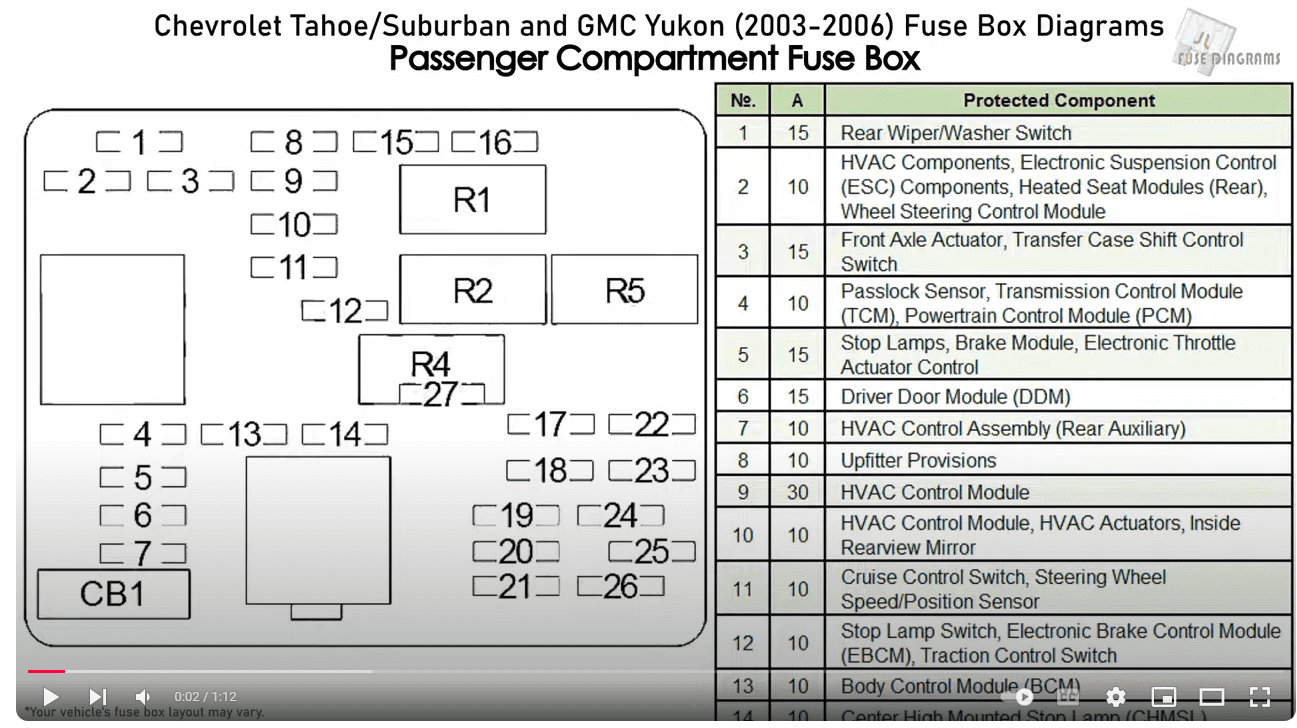

Check fuse 4 passenger side compartment for the TCM

back trace the harness to the transmission. Also, check your speed sensor wire. I'm not sure it would affect the power to the transmission, but it's the only wire that has any relations to the ******.
Low voltage can cause transmission issues. Autozone will test your alternator for free.
