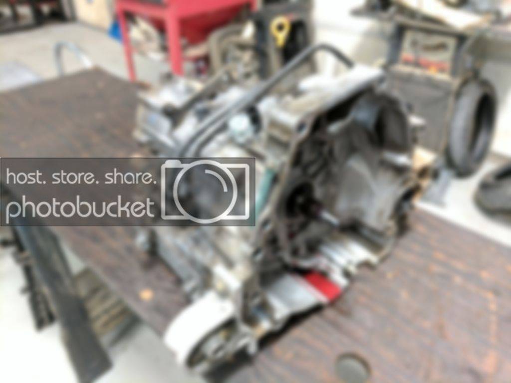

Got a few pics, but nothing special...
***** out of car...

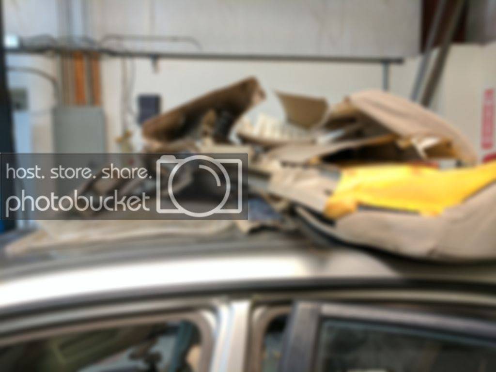

Pile of crap removed from car...

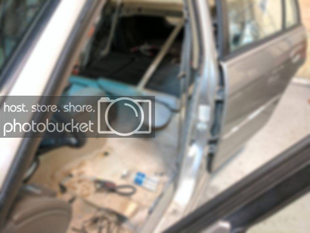

And the mostly empty car...
Not much to see yet. More pics to come once I get to the good stuff. //content.invisioncic.com/y282845/emoticons/smile.gif.1ebc41e1811405b213edfc4622c41e27.gif

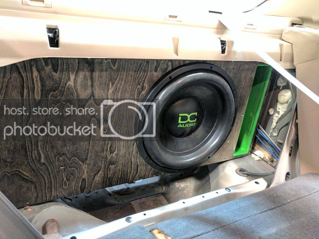

Stained the box today. Still haven't checked to see if it'll fit into the trunk assembled, or if I'm going to have to assemble it in the trunk, but I think the latter is going to be the case. Will know for sure tomorrow, and it'll be in the trunk then regardless.
More done today.
The box fit, but had to remove the false floor to get it in, and then build one around the box. That's far better than building the box in the trunk...

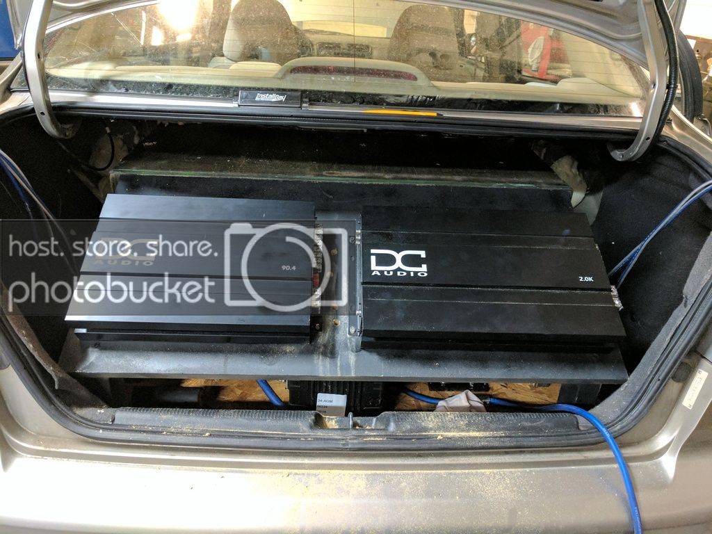

Built an amp rack as well. Not pleased. Needs to be about 5 inches wider, but it'll do the job for now.

This is the only other pic I have for now....showing the wiring done. I wish now I'd have done this (sealed trunk) to begin with. All the deadener in the trunk is just wasted money at this point.
