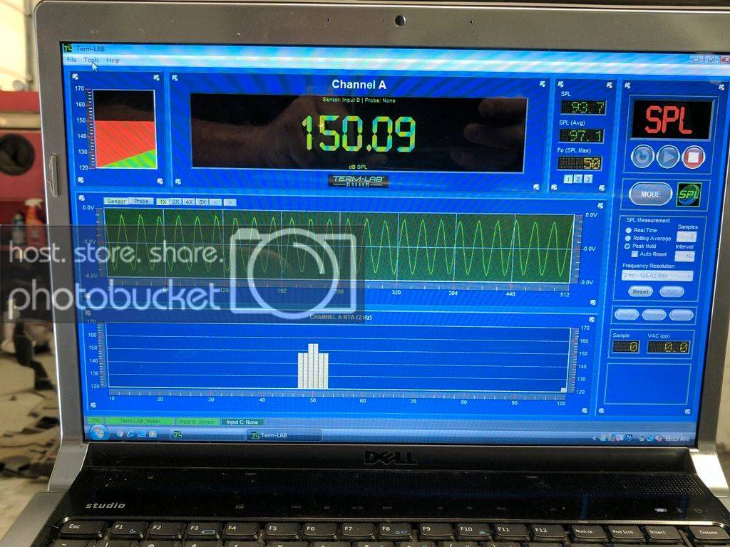

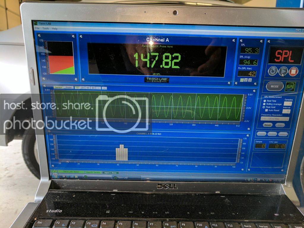

Slow afternoon at work today, so had time to do a little more testing.
Making the port 1 inch longer got me a .6 db gain sealed. Making the port as short as possible got me a .6 db gain outlaw.
Soooo close to 150 I can taste it!
Sub/slot port forward is off .2ish from my slot ported sub up port forward setup. That may be different with an aero port, but comparing slotted to slotted, it did not do good.
I've tried every possible combination except port into the corner of the trunk. Sub up port forward has beat everything by .1 to 3 full dB's.
Based on testing, just dropping box volume a hair will get me the 50. So will reconing to 1 ohm (.5 per amp).
Will be doing both of those soon. Shooting for a 50 sealed after I get it outlaw.

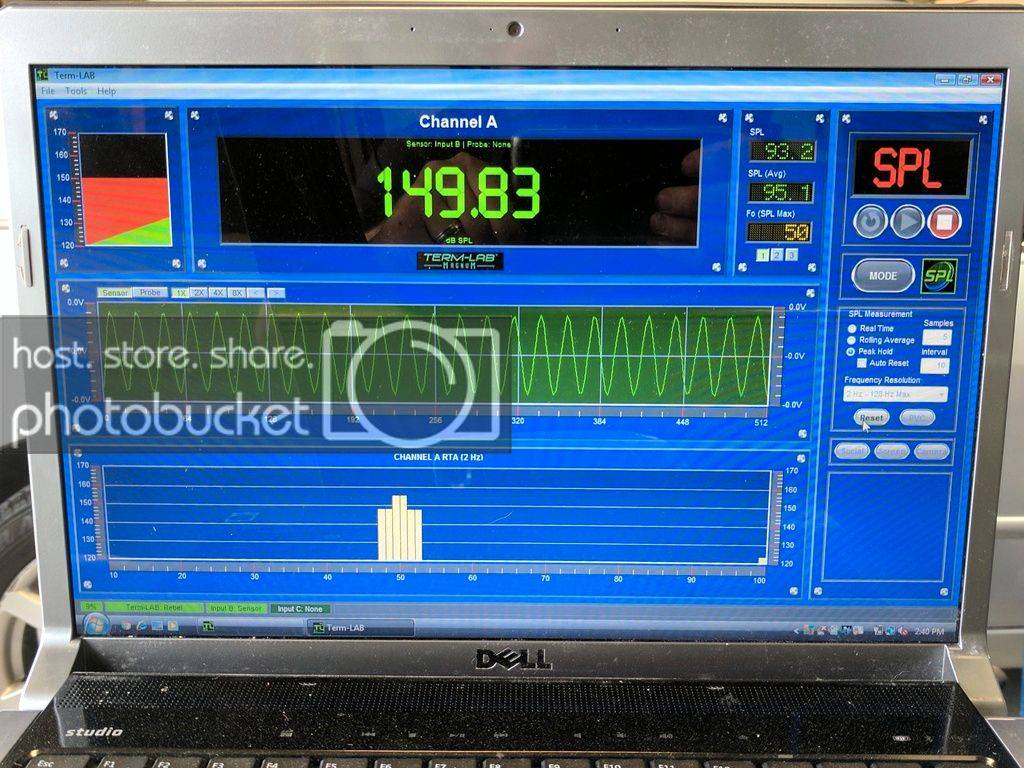

Went to my second competition and placed 1st in both classes. Trunk 0-2500 watts and Trunk Hardcore (outlaw class). In the 0-2500 class, on my first pass I broke out by going over the power limit. Got a retry and the tone ended quicker than I expected, so I didn't get to roll into it as much as I wanted. Scored 145.5 which was good enough for the win.
Hardcore, I beat the best score I've done with my testing by .1, and scored a 149.9!
