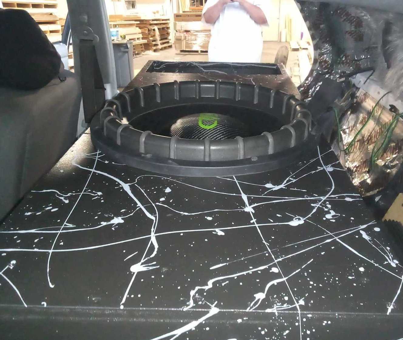

This is going in the backseat on a platform, I have ideas that may be implemented and the enclosure may become a 6th order eventually. For now its a low power (2K) setup being built... stay tuned.
A single JP23 for now...
Lets see if eventually we can make this windier than what it'll already be.

Everyone present had to hear it, the pedestal is ghetto engineered in there and it is underpowered but...
Tuned 30.5hz it slams as is, it needs mounted correctly and shelled in but for now on low power for the sub it is killing the car. Poor Crown Vic police interceptor, he plans to add power and do some cabin work.
Big ol' box and its only 6.5ft3 net.

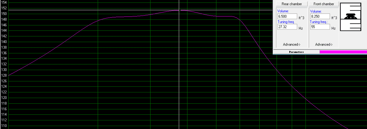

What's the volume going to be for the parallel 6th? Will you wall it off or add another driver?
That modeling I posted is a series 6th yes but it may not be possible. Space is less than what everyone thought. The box may get walled or shelled in to seal off the trunk as is. Too many things up in the air right now to say. The platform wasn't even built yet and they put it in there. Hearing it was their priority for now
Sorry, I didn't notice the volumes posted in the diagram. I was starstruck by the DD. I have the Z hoodie (my favorite) and would love to have a couple someday. And I will. lol
So ~15 cubes internal. In a crown vic you could wall it for sure. If I were to ever get off the IB bandwagon it would be for a parallel sixth or 4th order. When they are dialed in they sound so clean. At full send I have some small amount of spider noise from my subs but they are inverted facing in the cabin.
