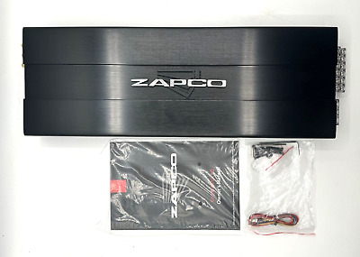

Or this Zapco
4 ohm tweets, 2x100
2 ohm 6.5's 2x150
2 ohm coaxials 2x150

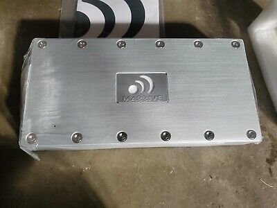

and one of these for the tweets
2 x 210 (crazy overkill but hey,it matches and is priced right

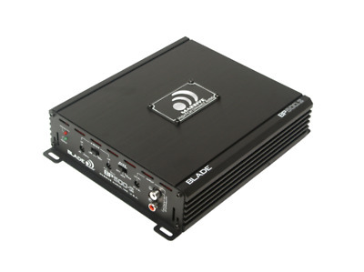

Keeping in the recoil family but anew mini offer from Recoil
2 x 200 bridged at 4 ohms (tweets)
