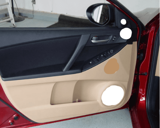

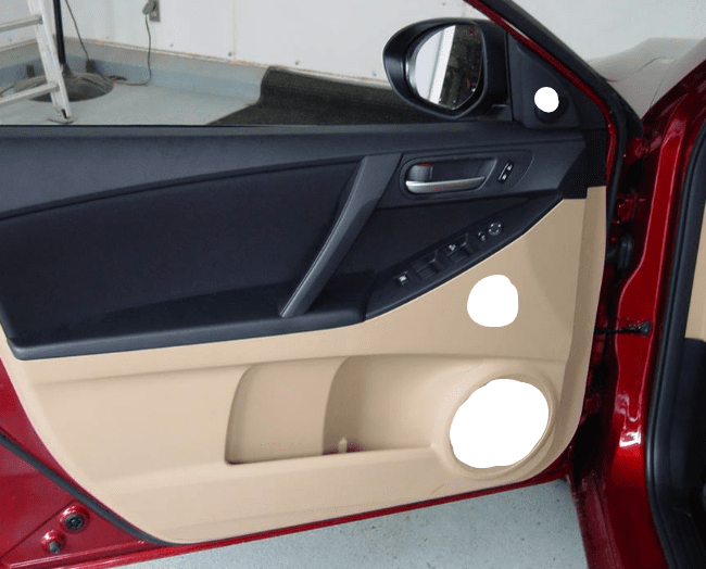

I think that's the last place I'd put the midrange. I'd consider the kick panel location or dash/sail panel.
Something like this maybe?
I think I could make this work... Angle both towards the center just aft of center between the seats, on axis-ish...

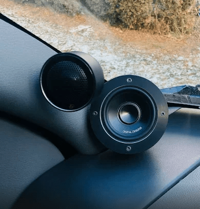

Ever contemplate using these kind of pods?

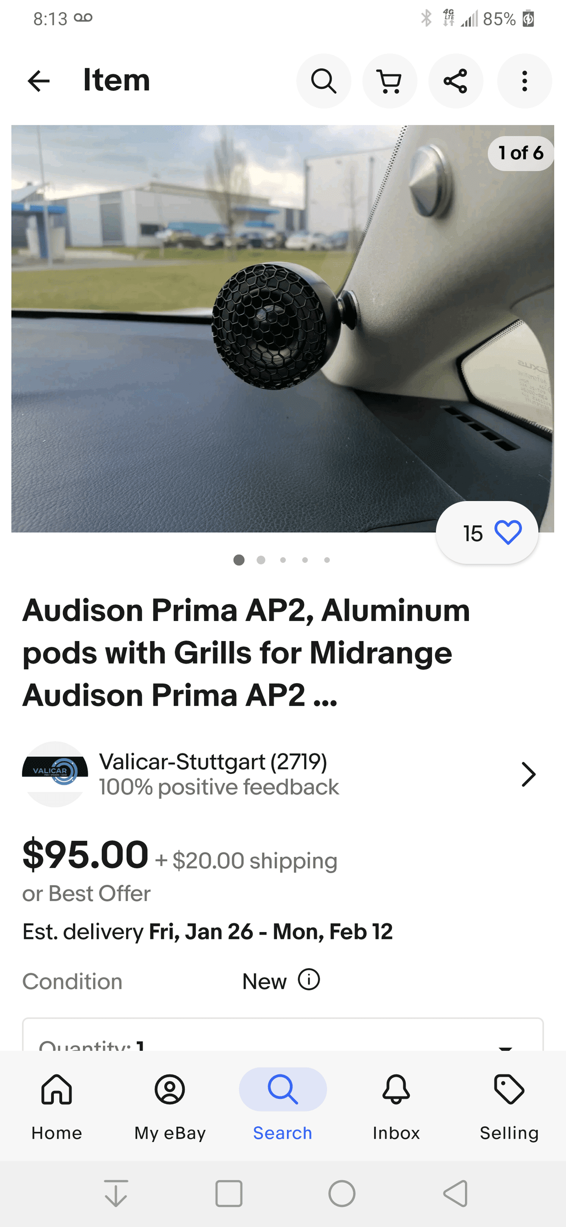

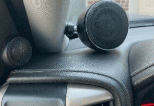

At this point, I think I'm going to build out the OEM location for the tweeters using the offset surface mounts that came with the CDT tweeters. They usually for mounting on the rear package tray, but if I glass them to the OEM location, sideways, would put them at almost the perfect on axis angle. I would then get pods like these or maybe that german company that makes them to order, an mounthm on the dash directly to the right, horizontally, angled the same as the tweeters, seems to be what I've settled on. It would aim both, on a horizontal plain, almost perfectly at the center headrest area right between the seats and would avoid reflections from the windshield, almost perfect. Like this but with the centers of the drivers on an equal line across (and at the same angle, in the sail panel)
That way all I need is the midrange pod and to build out the sail panel, should work out well. ALmost like this, but the tweeters in the sail location and a pod for the mids, about an inch apartm much closer than this but similar alignment.
I see. That tandem mounted set is what piques my interest. The more I ogle them the more luxurious they seem. For that, I would have to upgrade to 3 way front stage like you did.

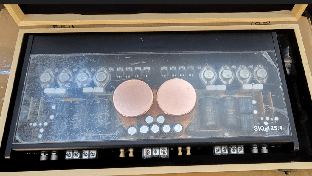

Just got this baby in today, can't wait until the thaw comes in spring.
A little overkill for mids and tweets, the thing is brand new and the price was really good! Could not believe how heavy it is, built like a tank(like 12-15 lbs). Sides are solid 5/16" billet anodized black aluminum just gorgeous! Now, what to do with the Helix B Four... I feel and Ad coming soon!
That is so niiice! It gots me looking around the house like a crackhead seeing what I can sell to get a hit. What I really should do is run through all my amps one more time then start setting them free. That would allay the guilt of getting one more amp... or two.
