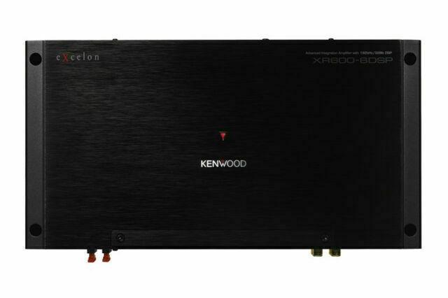

Not many that have any output comparatively. This Kenwood is decent at 75x6, $329
  • 6-channel car amplifier with digital signal processing
    -75 watts RMS x 6 at 4 ohms
    -100 watts RMS x 6 at 2 ohms
    -200 watts RMS x 3 bridged at 4 ohms (4-ohm stable in bridged mode)
  • CTA-2006 compliant
  • Class D amp technology
  • iDatalink Maestro AR amplifier replacement module included
  • 10-channel 32-bit 192 KHz digital processor
  • All controls and adjustments made via Kenwood DSP Control App via your compatible Bluetooth device
  • Selectable high- and low-pass filters (31-19,900 Hz) with selectable slopes (6, 12, 18, 24 dB/octave)
  • 13-band graphic and 3-band parametric equalizers
  • Time delay/alignment
  • Installer Mode accesses all controls
  • User Mode limits functions to selecting EQ and time-alignment presets and subwoofer volume
  • 4 processed preamp outputs
  • Fan cooling
  • Fuse rating: 40A x 2
  • Dimensions: 12-5/8"W x 2-1/16"H x 7-1/8"D
