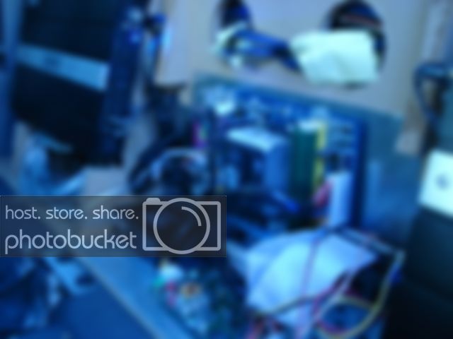

Spent much of saturday trouble shooting and making sure the computer was up and running and running consistently. Ended up that the mobo was bent and bowing directly under the ram chips and causing a no boot condition, so after re seating everything a few times I got it all set and installed firmly into the truck with the mobo nice and flat. I'm thinking this will give me problems in the future though with bumps and jostles //content.invisioncic.com/y282845/emoticons/frown.gif.a3531fa0534503350665a1e957861287.gif
Oh well onto the pics.
Removed the crossovers on the amp rack to go active and to give me some working room for the computer. Took me nearly 45 minutes before to connect the PSU to the mobo when the seat was bolted in and the crossovers in place //content.invisioncic.com/y282845/emoticons/mad.gif.c18f003ab0ef8a0d9c27ca78d77a6392.gif Much better now.

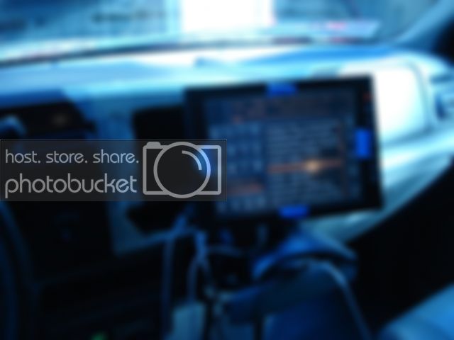

Like I said temporary trouble shooting session lol. I need to get this finished though, this temporary stuff and the tape on the dash is starting to drive me nuts.

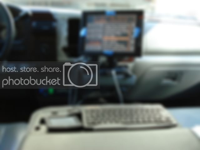

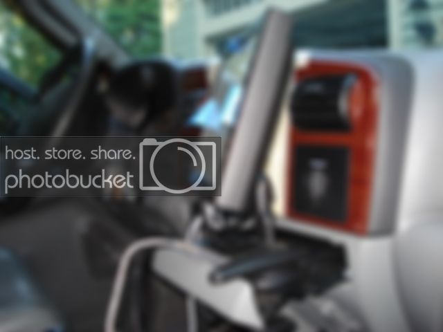

Killer monitor holder lol

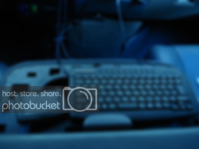

Mini keyboard and touch pad sitting roughly in their final resting position
I plan on build some sort of a flip open door on the console that will house the keyboard and touch pad. When close they will both be hidden and it will match the rest of the console, then flip open with a piano hinge or so revealing the keyboard and touch pad, as well as uncovering the 2 cupholders if I need them.

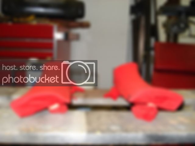

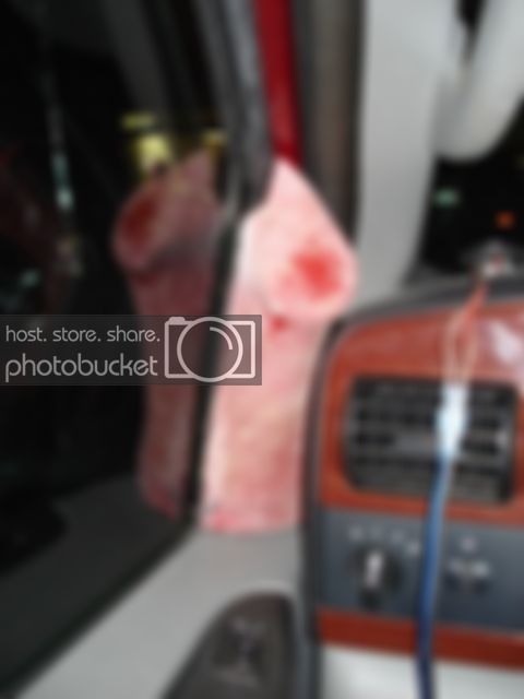

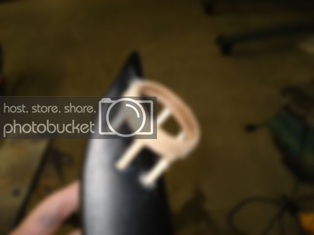

Did some more fiddling with tweeter placement and decided on going with on axis mounting to get the most detail from the tweeters. Also this will be the easiest position to return to stock if I decide to change things up which we all know happens, and quite frequently.

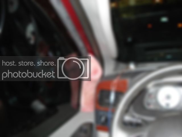

I got both tweeter pods aimed and mounted to the sail panels with some dowels and hot glue.

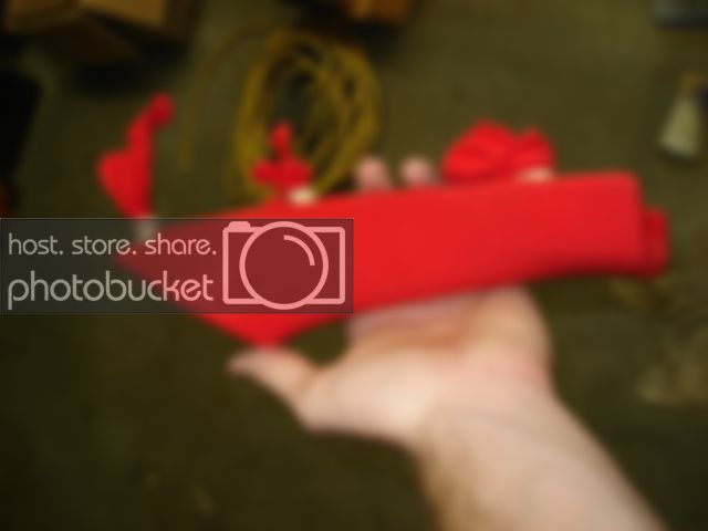

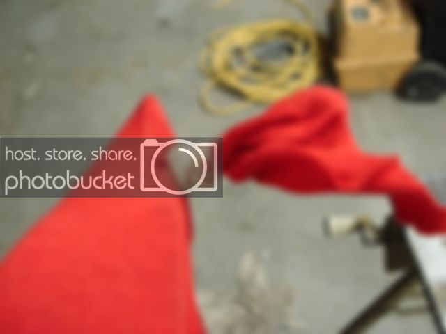

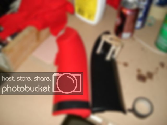

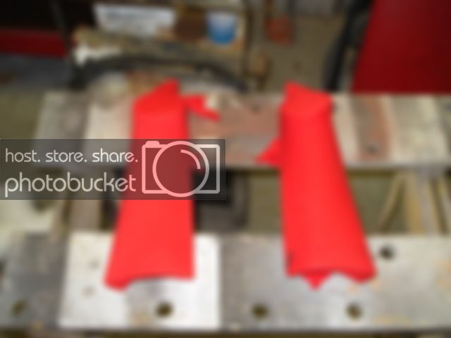

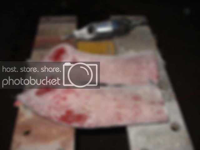

I learned a few things from reading on here and other forums and moved ahead with wrapping the panels with some pieces of t-shirt.

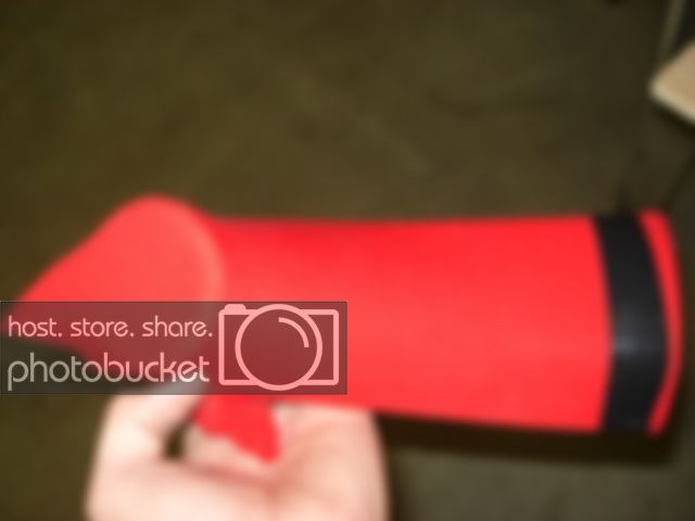

This is only my second time working with fiberglass and first time when wrapping something so it took me a while to get it just right and figure out how to hold it in place. I am still not too sure on how much I like the shape but I will leave my final opinion till I actually finish them and see them installed and painted.
I'm sure others know this trick, or have even better ways of doing this but I thought it was pretty good. There wasn't really any way of holding the t-shirt material around the plastic and keeping it tight. Then I found I could get it just right and carefully grabbing both sides twist it together and when its tight and just right twist an elastic band around the twisted cloth over and over again until there was no more stretch in the elastic. This worked pretty good and held it nice and tight

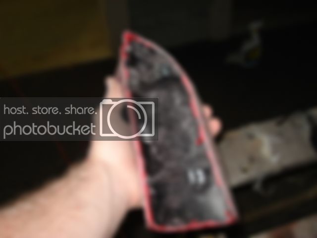

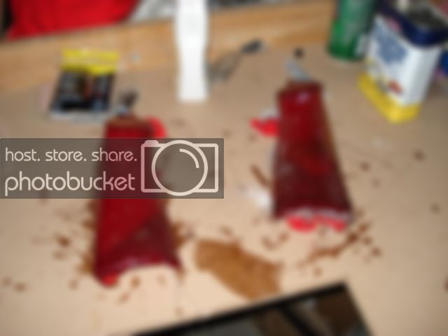

I only got maybe a layer or 2 of mat on them but they are strong specially with the continually curving and tight shapes. I will most likely add another layer and decent amount of resin after the first sanding I did tonight showed a few air bubbles and some other rough spots.
The resin isn't holding onto the plastic tighly. I suspect it would be good enough but I am gonna follow the advice of my dad and drill out some 3/8" holes in the sides and put in some pop rivets then resin/mat and finish over them to give a nice mechanical hold.
Installed on the door where it will finally sit.

thanks man. As usual things come up and I didn't even get to touch the tweeters all day saturday and most of the day sunday. But I got them roughed up and started to do the bondo/sanding process. Bit more work on them tonight with the bondo and lots of sanding and then get around to painting and finishing them up.
