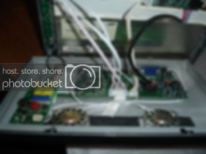

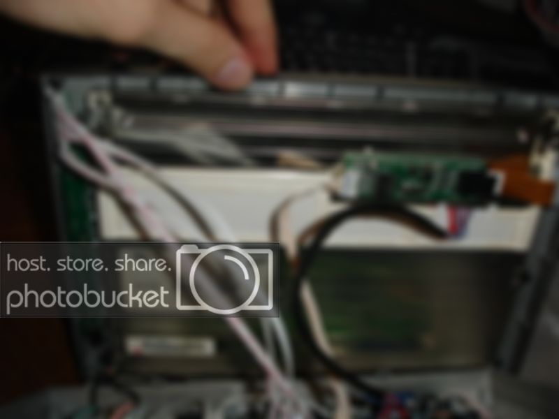

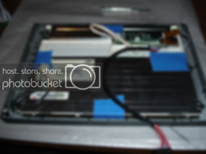

Here are a few pics of the screen from when I disassembled it.
Back side with the LCD control board and such
Front side with everything still intact
Front side with the cables disconnected to remove the actual LCD panel itself

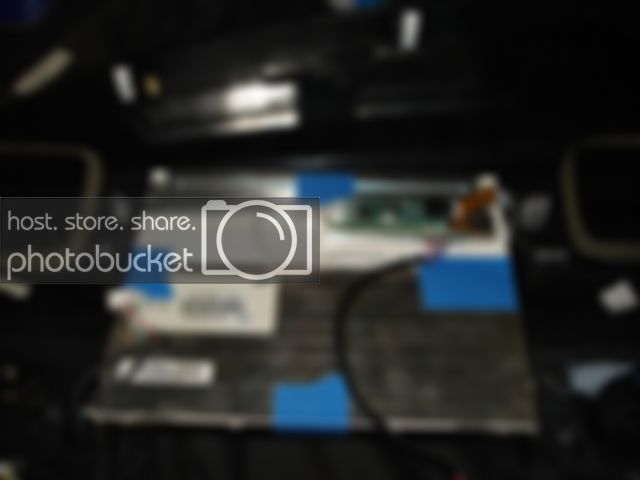

And here is a shot of the LCD panel resting in the back side of the dash
There are a few things I need to trim off the back side so that the screen can go up to back side of the dash panel, then I will put some padded double sided tape, bout an 1/8" thick to pad the screen from the dash a bit. Currently thinking of wrapping the screen with foil (as a release agent and to protect it. Then pouring fiberglass resin our maybe some duramix around the edges of the screen up to the thickness of the LCD panel, then using the metal tabs that were used in the factory bezel to attach the screen to the dash panel.
Let me know what your thinking, might work out better, and I am always open for different ideas.

let me try and explain my idea... if i have to, i'll draw it out and post a picture i will.
the same way you made that fiberglass piece that you mounted under your dash with the with the HU... make one that comes over the dash, and mount the monitor in that... you can attach it at the top and let the front part rest over the wood grain. i know it would not be flush mounted the way you wanted... but it's an option other than cutting the trough the wood grain and everything...
might be a dumb idea tho...

That is the way to go right there. I used to have a few 80-86 Fords that I went through and was always easy to get whatever parts I needed from the junkyard and even started to get some in stock just laying around. But this truck is too new I think for me to be able to find in the yard.
let me try and explain my idea... if i have to, i'll draw it out and post a picture i will.the same way you made that fiberglass piece that you mounted under your dash with the with the HU... make one that comes over the dash, and mount the monitor in that... you can attach it at the top and let the front part rest over the wood grain. i know it would not be flush mounted the way you wanted... but it's an option other than cutting the trough the wood grain and everything...
Okie, I got what your saying. I am going to keep it in mind. I'm not sure if I would be able to make it work while making it even resemble an OEM install is the only problem. I'm sure if I put the screen behind the dash it won't be all that OEM and trick people but I am gonna try.
Thinking absolute worst case I could send out my dash to one of the refinishing places and get a new wood grain applied to my newly formed dash, or buy a new panel (hopefully from a junk yard, but probable the dealer) and then drop down to an 8" or 7" screen which should install nice and easy.
