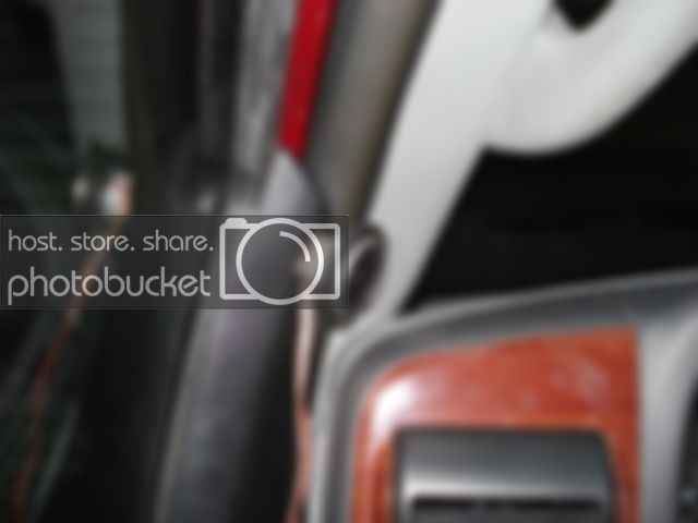

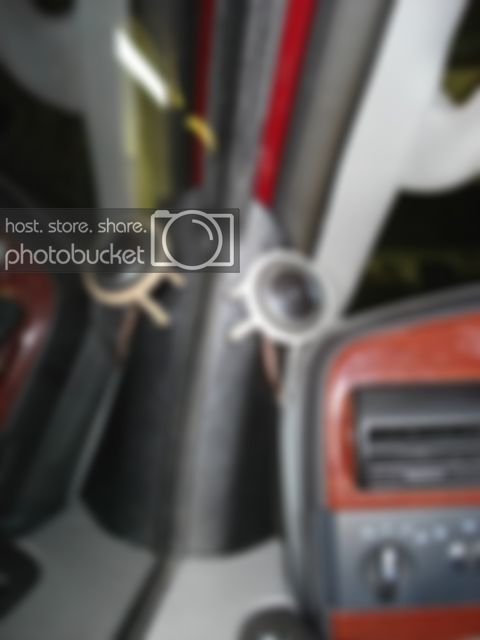

Got a little bit more accomplished. Tweeters are installed. What do you guys think...
Drivers side tweeter
how will that monitor be mounted (once you cut the wood grain... yikes...)do you have some kind of bracket that it came with?
I still have yet to 100% figure it out, but what I have in my head at the moment is to cut it JUST right lol. Only ONE chance at this, and the screen will sit behind the dash as it would in a standard bezel, then I will mount it to he back side of the dash piece either using the bezel it came in, or with some fiberglass or plastic build up around the screen and fastened to the dash as it is in the bezel which is by little metal clips screwed into the bezel.
Ok don't worry the tweeters aren't staying like that, but even with that horrible mounting it still sounded amazing. Get in the truck and crank the stereo and it was like you just put on headphones, the speakers disappeared and all you were left with was the music right up around eye level or a little bit lower (I sit pretty high up in the seat.)

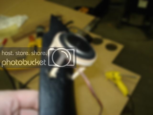

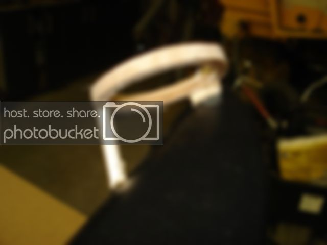

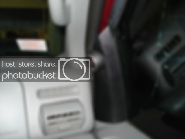

Here is what I did tonight, not much but got the tweeters aimed and into little pods. Later on I will go back and wrap the sail panels and pods and finish them up with some fiberglass then texture paint and black pain to try and match the OEM as best I can.
And here is the passenger side...

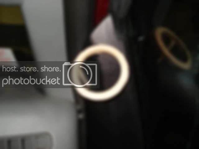

BEFORE: super crappy, but as I said it sounded pretty sweet lol, just lacking a bit of the highest highs. Hoping by aiming them directly on axis to each headrest that those highs will be brought out.

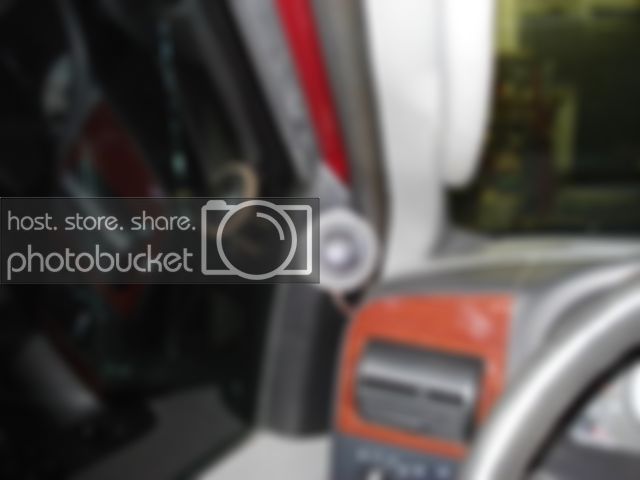

AFTER:
Not the greatest picture, but it is also now aimed directly on axis. The drivers side tweeter is at the drivers headrest and the passenger tweeter at the passenger headrest.
I haven't really had any time to sit and get an idea if this is any better or do any more tuning but I am pretty sure it will be better. If not I can always change it around a bit. The hot glue gun has become one of my most favorite tools in this install lol. I didn't have a laser pointer around anywhere so I tried to aim them as best as I could, hopefully it will be good. With the tweeters squared away I will be free to move onto deadening the doors to try and make a proper home for these speakers.
Any tips, tricks, criticism or feedback of any kind is greatly appreciated, specially seeing as much of this install is a learning process for me so far.
