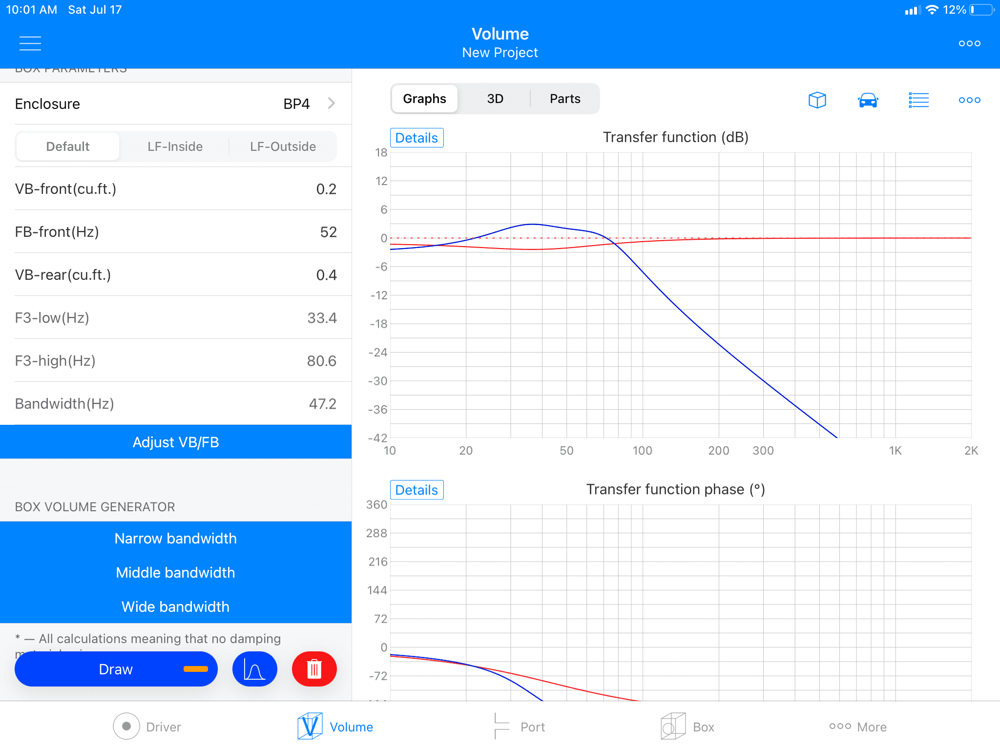

Yeah I've got the ultimax saved, but I can't find the 2 ohm DVC in stock anywhere currently. The power handling is also slightly worrying, and it's pricier than the soundqubed. Currently I feel like it's between those two subs. When you modeled the quebed, what size sealed box did it like?
I was actually modeling it for a fourth order more than sealed. This is my last progress when playing with the modeling.
