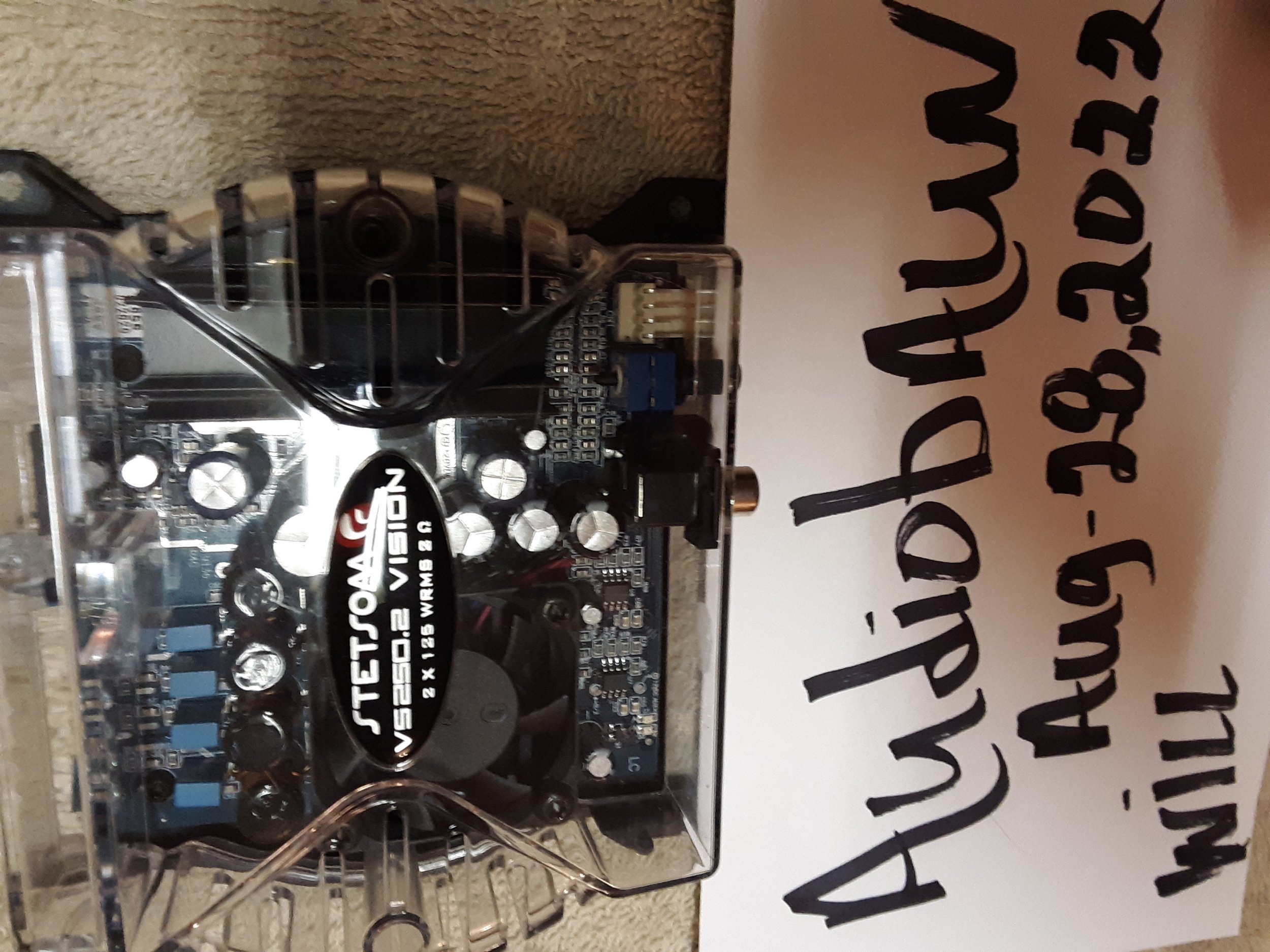

Sub will only work if I have 1 RCA cable plugged in.
Thats a nice amp man. Make sure you have the switch set to LO on the Input level and use the RCAs directly to the right of that switch that says INPUT White on top/Left and the Red on bottom to Right, should be same from the HU is common practice. MAKE SURE You turn your Gain down to about 9-Oclock position or lower if you did not place the Input level switch on LO, and make sure your Volume Knob on the HU is down to a low listening level also so you dont clip or blow a sub.. LOL

Specs.. What ohm load are you wired too? What brand and model are your subs
It's a 2ohm 10 inch sub currently. The Skar SK10TBV. Originally I tried using 2x Skar EVL-65 D2 6.5 inch subs in the rear deck, but I I think I prefer the 10 over the 2 6.5's.
The 10 inch sub only has one set of external connections, so the dual 2ohm factory config is my only option unless i break into it and change things.
Have youwent in on your HU and found to turn SUB WOOFER ON?
Yep, there is an on/off setting, and a phase setting. I tried both of those.
The *only* thing I can do to get the sub to work is unplugging one RCA cable. Very odd situation. I'll be trying another set of RCA cables tomorrow when I get my hands on them. Hopefully it's as simple as that, but at this point I'm not sure how the cables can be the issue if the cables can individually send the signal to get the sub to work, but when they're both plugged in, nada...
