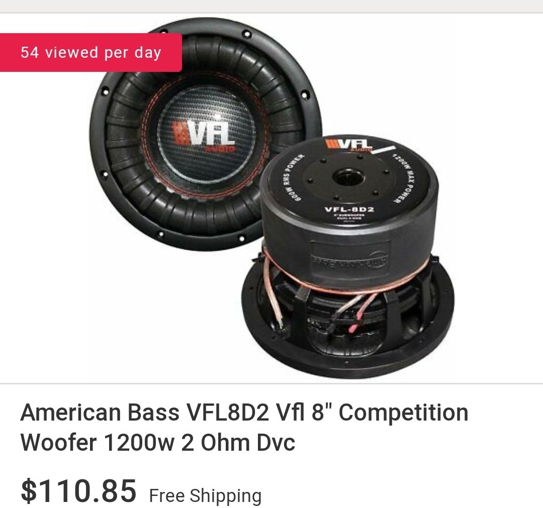

Could you source me an 8 that has less then 5in of mounting depth and doesn't need room for back venting. Im having a hard time finding subs that fit those guidelines. The sundown sld looks promising and would have enough airspace for 1 of them buts thats about it. Is one 10 ported gonna out perform 2-3 10s sealed?
It should be close to equal...and stronger low end ...
