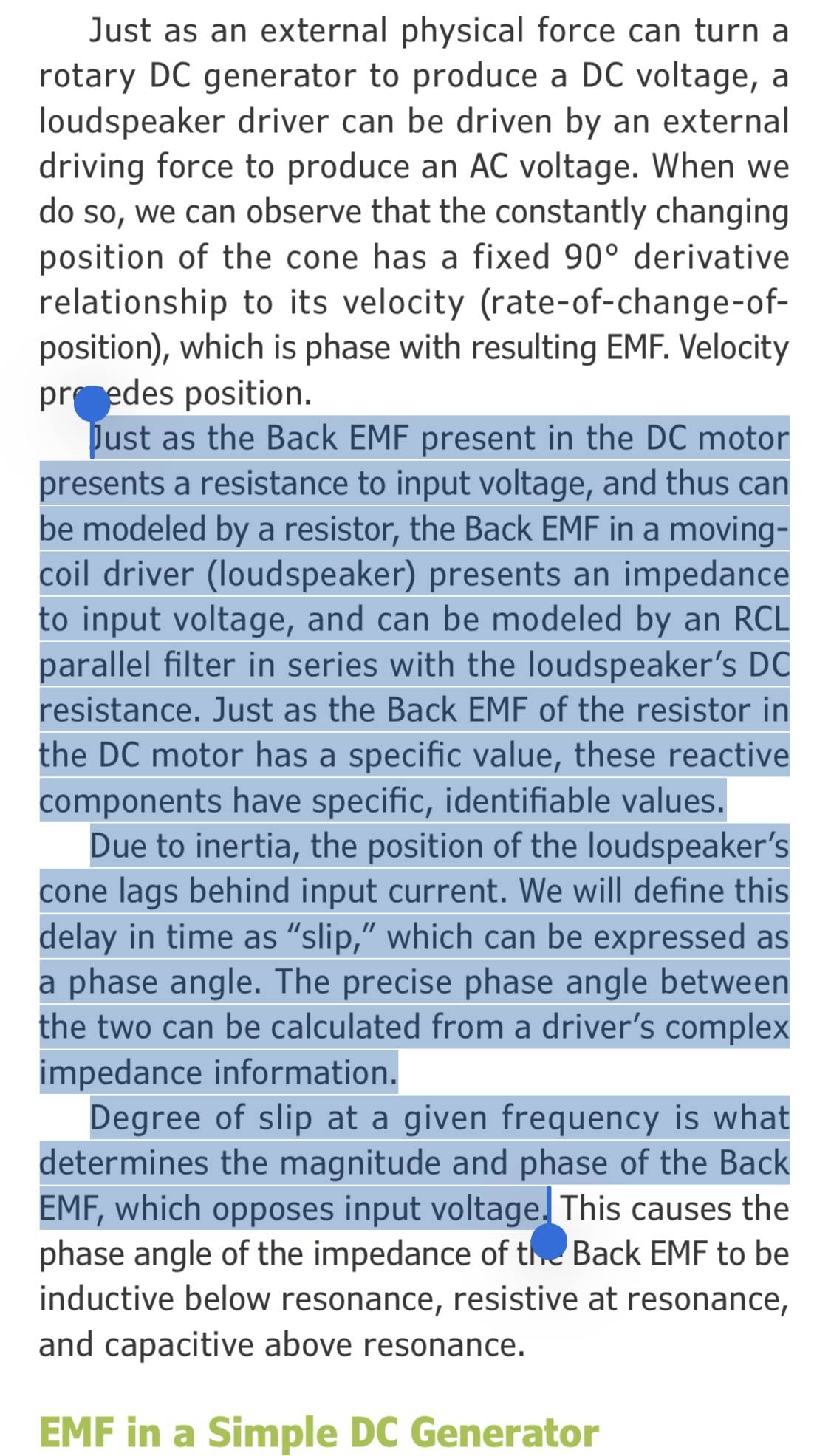

I once designed a box for 5 15 inch woofers each of which had a 45 mm one way X max, and a 4" VC with 800 MMS rated for 4500 W RMS. So that's 22500w rms. It wasn't ever built but just giving an extreme example- I can give other examples. I had to take amps into account with some designs. That system playing low notes where it's hitting high X max and shifting notes, there's a lot of back emf with that. The amp has to keep those big, super heavy coils under control under extreme xmax, and that would be an example of where 100 damping factor is going to hurt you. I can't imagine it wouldn't vs having idk 300-400-500 damping.
Sorry if I'm nerding out:
I def don't understand all of that in there- I just think it matters, the back emf, how the coil moves, and the relationship to damping factor. Basically seems like too low damping factor then the amp gets overloaded by back emf and can't control woofer as well.
