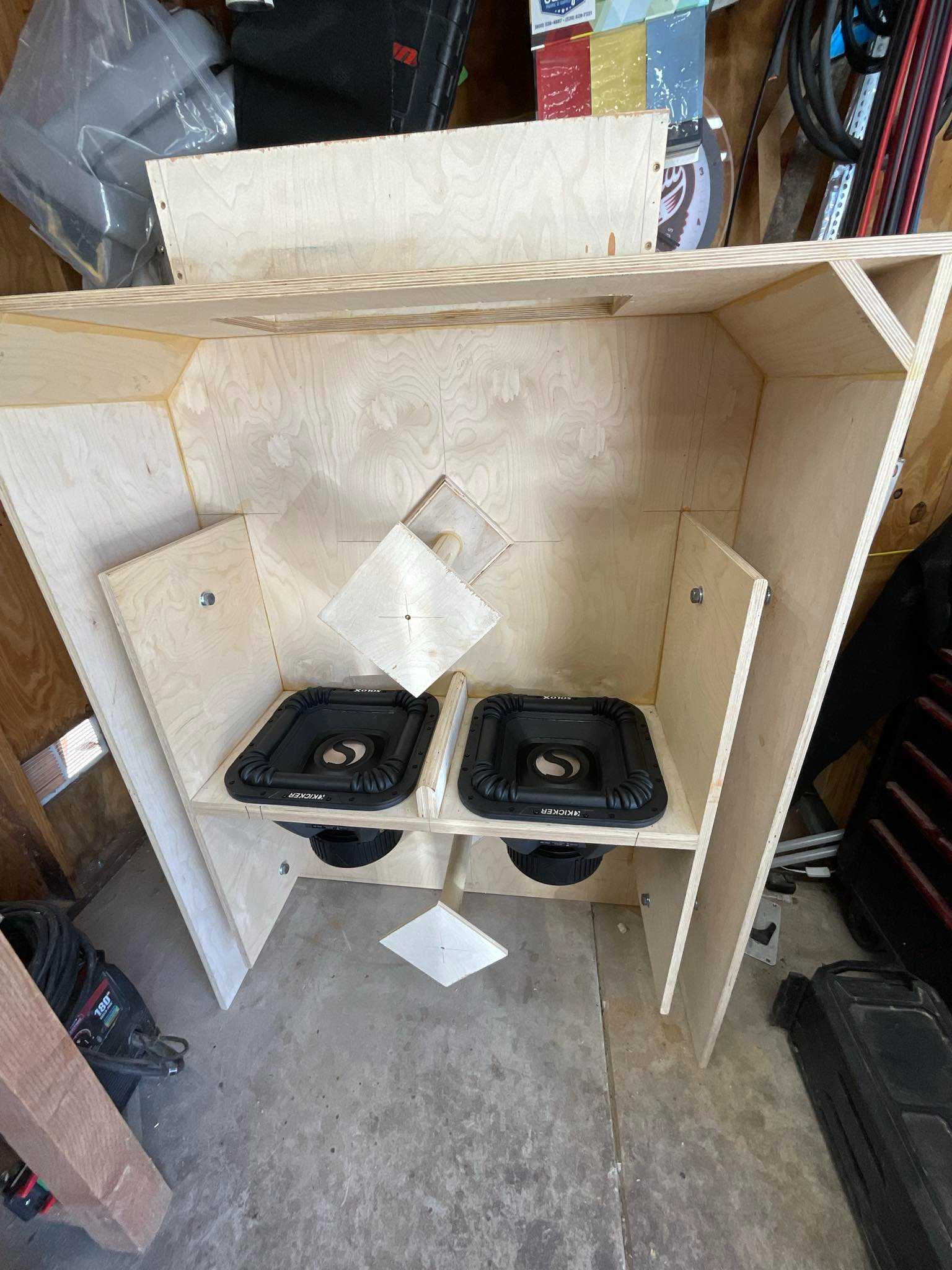

My role in this build is only a supporting one enclosure designing, knowing the quality and attention that will sweated into this before it is finalized I asked permission to be a fly on the wall and share.
This was done for an extremely talented fabricator, installer, gearhead etc... that happens to be a friend.
Someone who constantly hits it right outta the ballpark.
Sometimes I overbuild designing, when using premium materials I can revert to my instincts getting max performance from minimum materials. I should have stayed in school my engineer brother says.
I like it simple and effective.
In my locale blowthru's seem to be very popular, I've designed literally hundreds. The guy I designed this for happens to be a big reason for that. He has left installing for a shop as a job, started a new career and this is for his personal truck. I'd say no holds barred but we all have a monetary limit after all, so call it 10K invested... so far... haha. Most everything has arrived so it'll come together quick now.

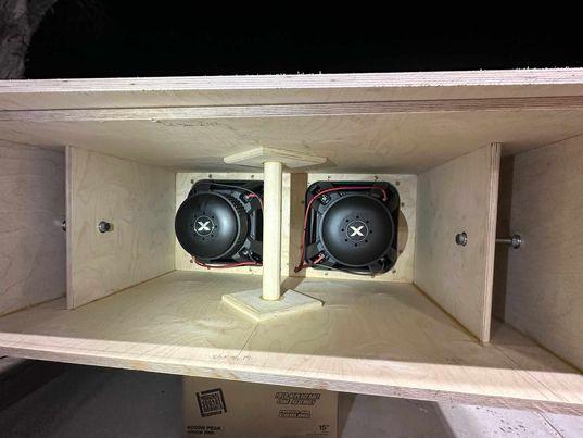

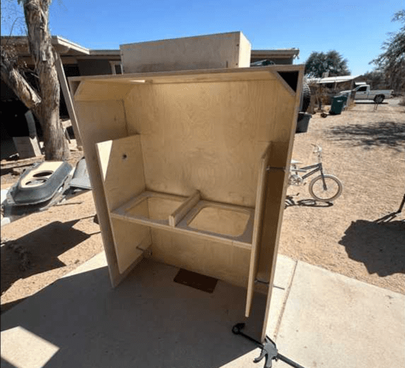

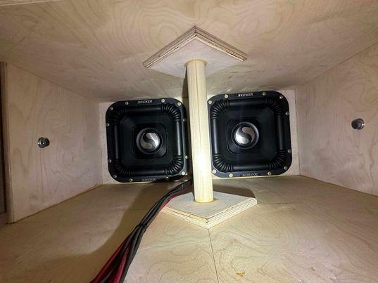

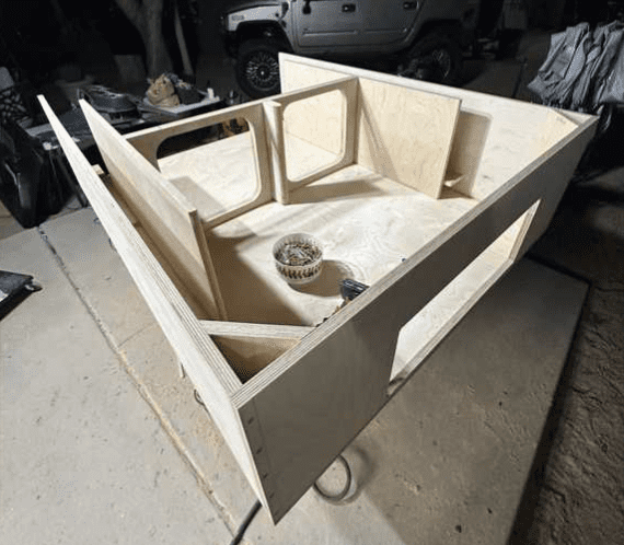

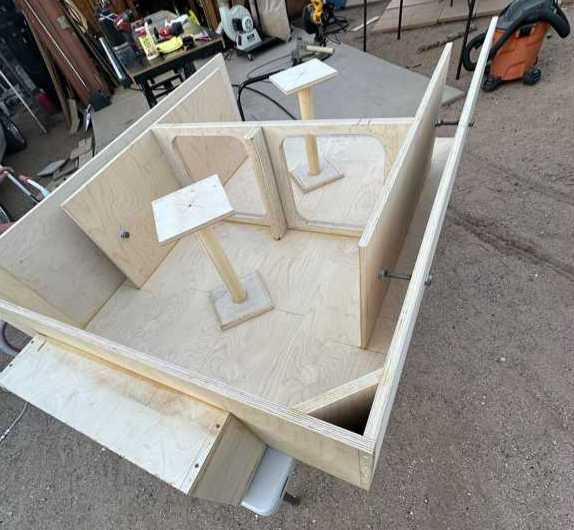

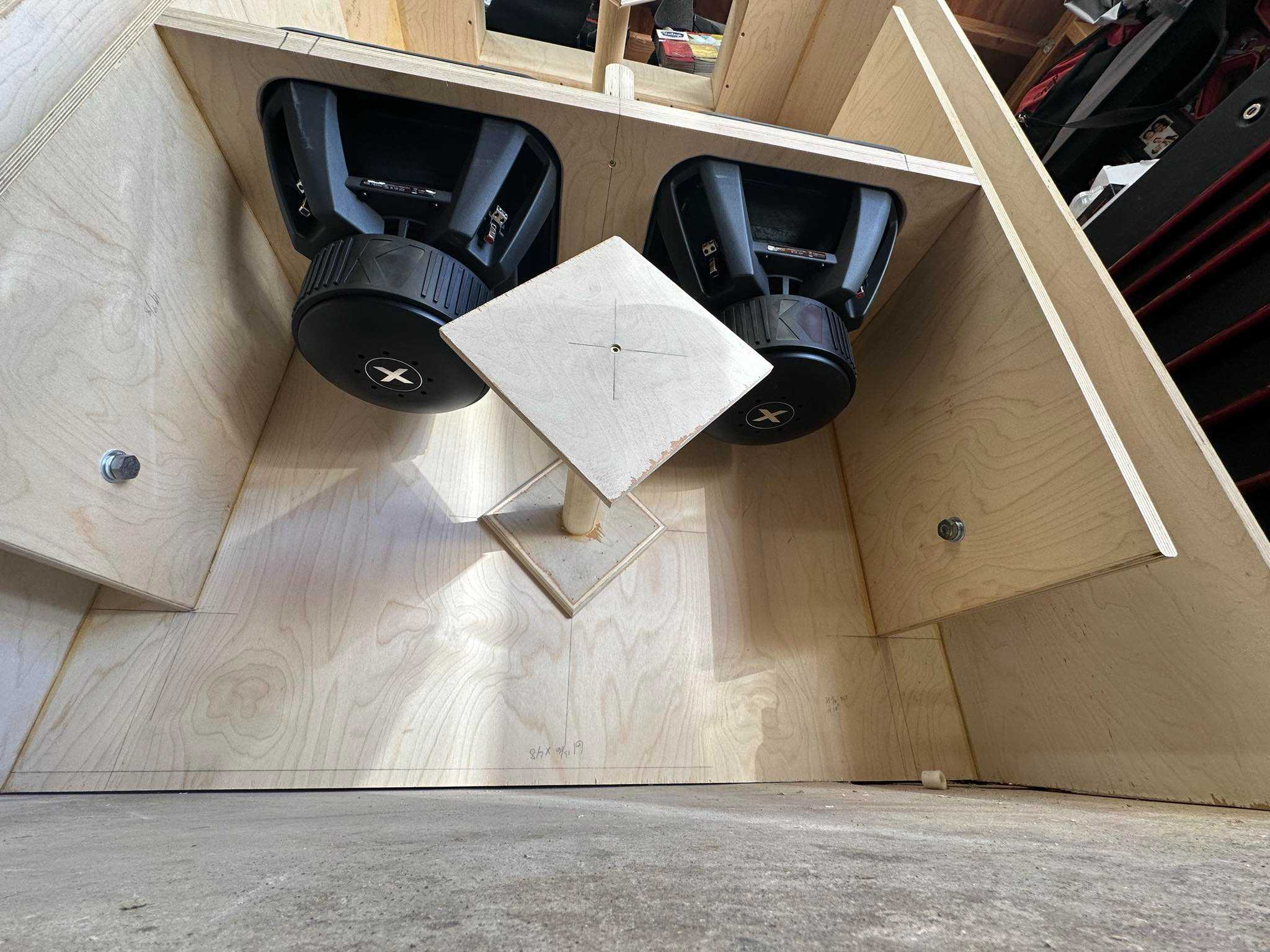

13ply Baltic Birch throughout, single ply... it'll be A-OK. Premium materials allowed more airspace and a less complicated build. Lexan rear panel and some allthread to brace the sides.

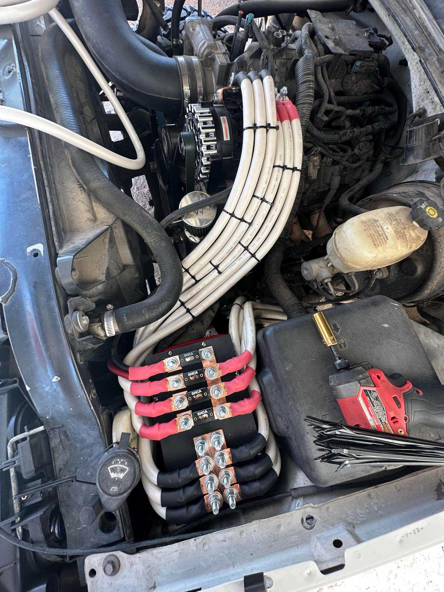

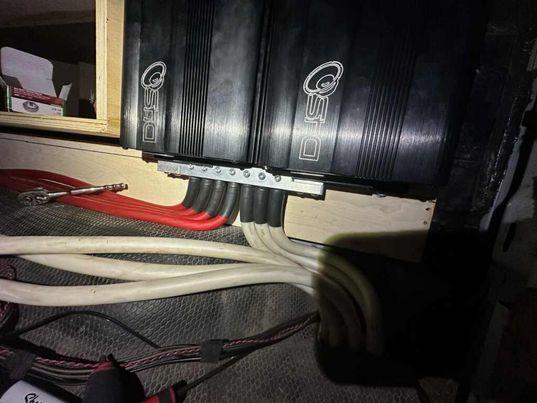

I've been asked so many times "how loud will it be?". This one is going in a single cab /w/ steel plate on the rear cab wall, heavily deadened with tons of electrical on some "JP" amps. "How loud?"
"We'll see"...

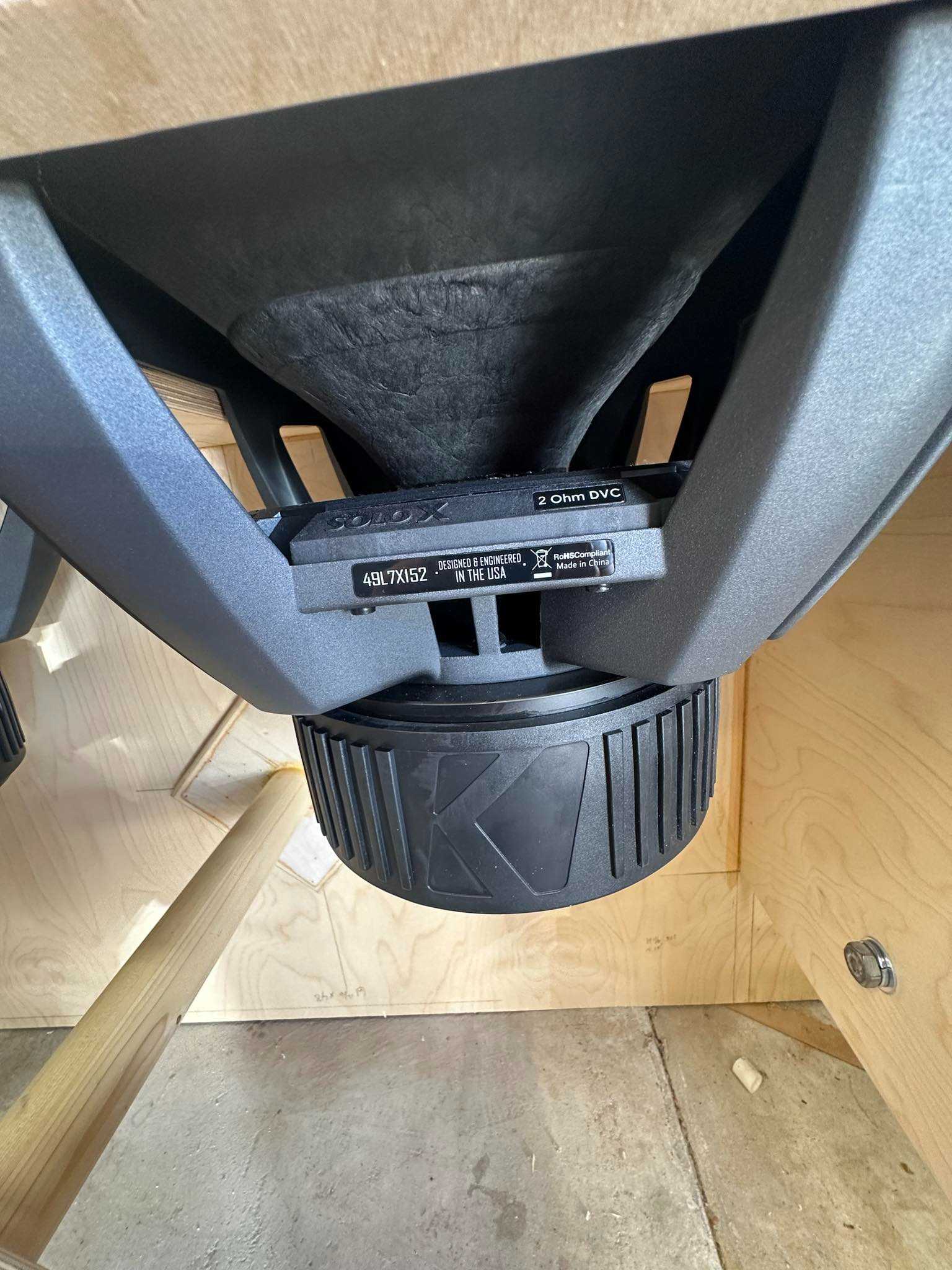

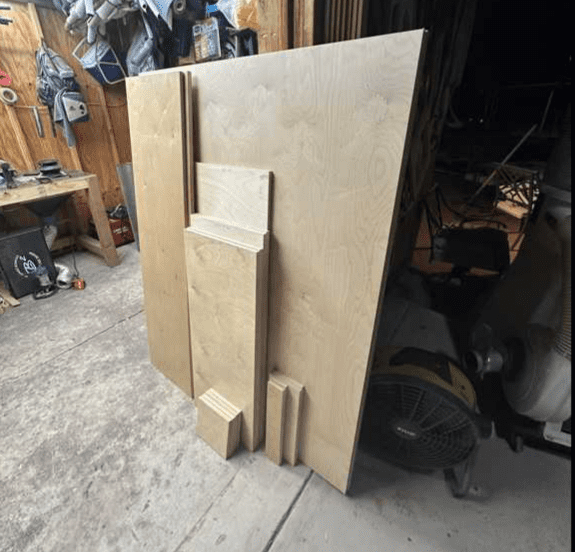

Are those door panels in the background of the 4th pic??? If so what speakers does he plan to cram into the door?
I'll be adding to the thread with details and photos soon. idk what that is exactly myself in the background he has so many projects going on constantly... haha.

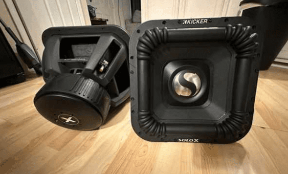

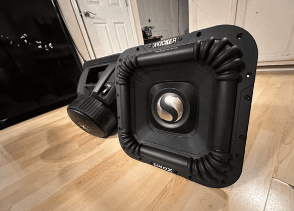

In the 1st pic those SoloX-15s look like 10s in there... haha
Yep... they're 15s

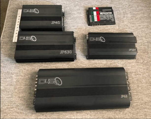

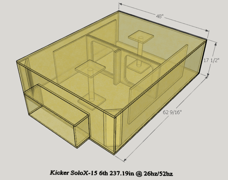

This'll be 2 or .5 ohm depending. On a Jp63... good times
10ft3 @ 26hz/ 12ft3 @ 52hz tuning /w/ 238in2 of port up front into a single cab heavily reinforced /w/ steel plate on the cabin rear wall etc... plus more more Russian to trim everything in.

Heat shrink and wire mgt takes effort, when I hear soon I hear tomorrow on something like this.

Yikes... it looks flat within bandwidth to me and that is a BIG bandwidth, loud on what I think that amp on his electrical can deliver. Stay tuned...
*Edit* Look at the predicted SPL and bandwith then read post #10

No pics of the rear wall, he's still needing to add a little bracing back there as it flexes a little over an inch where the double wall is.
The video is .5 power on a Jp63. I think he's going to put a terminal in there so it'll be 2ohm daily and .5 when he wants to tax those subs.
