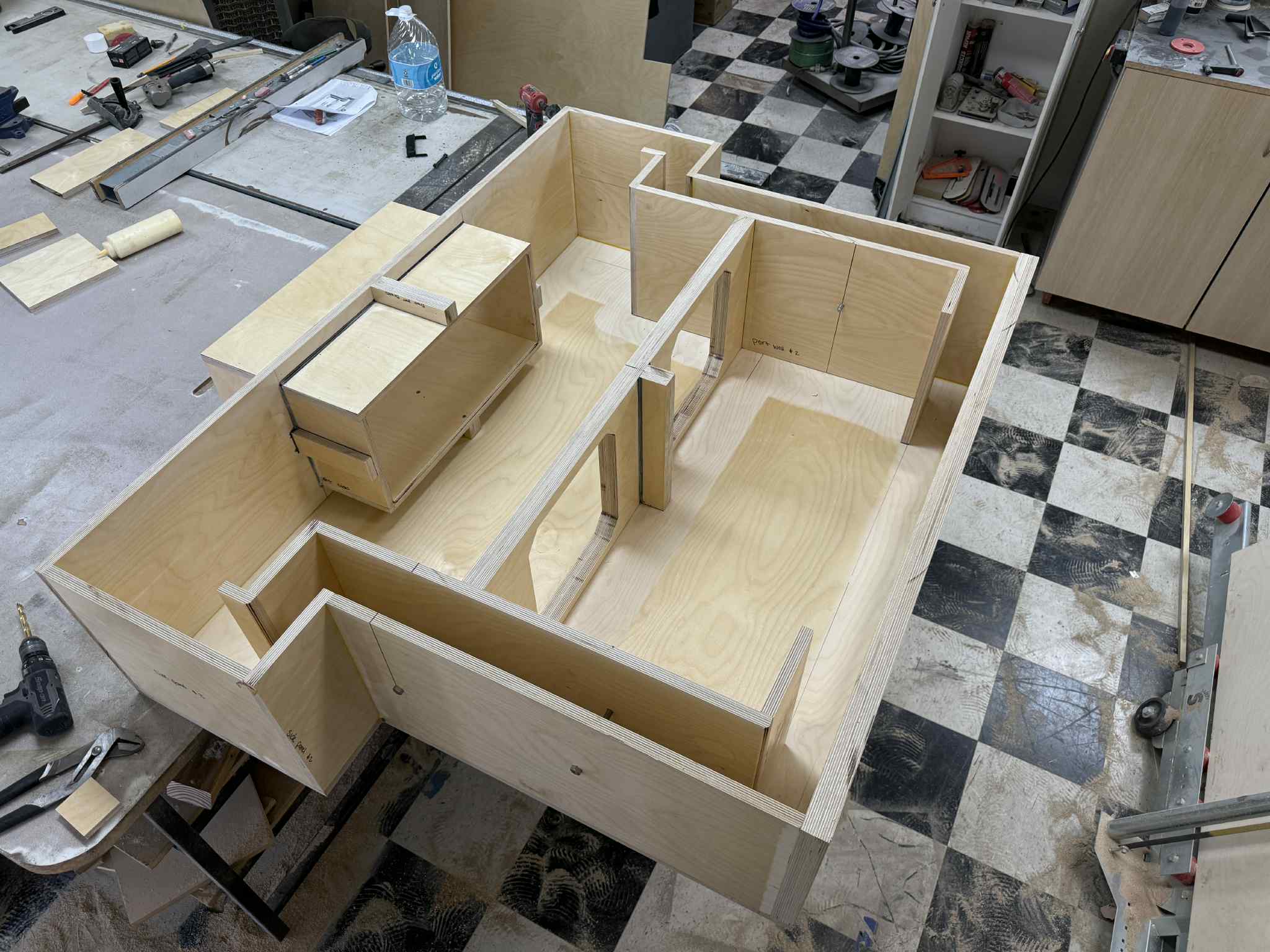

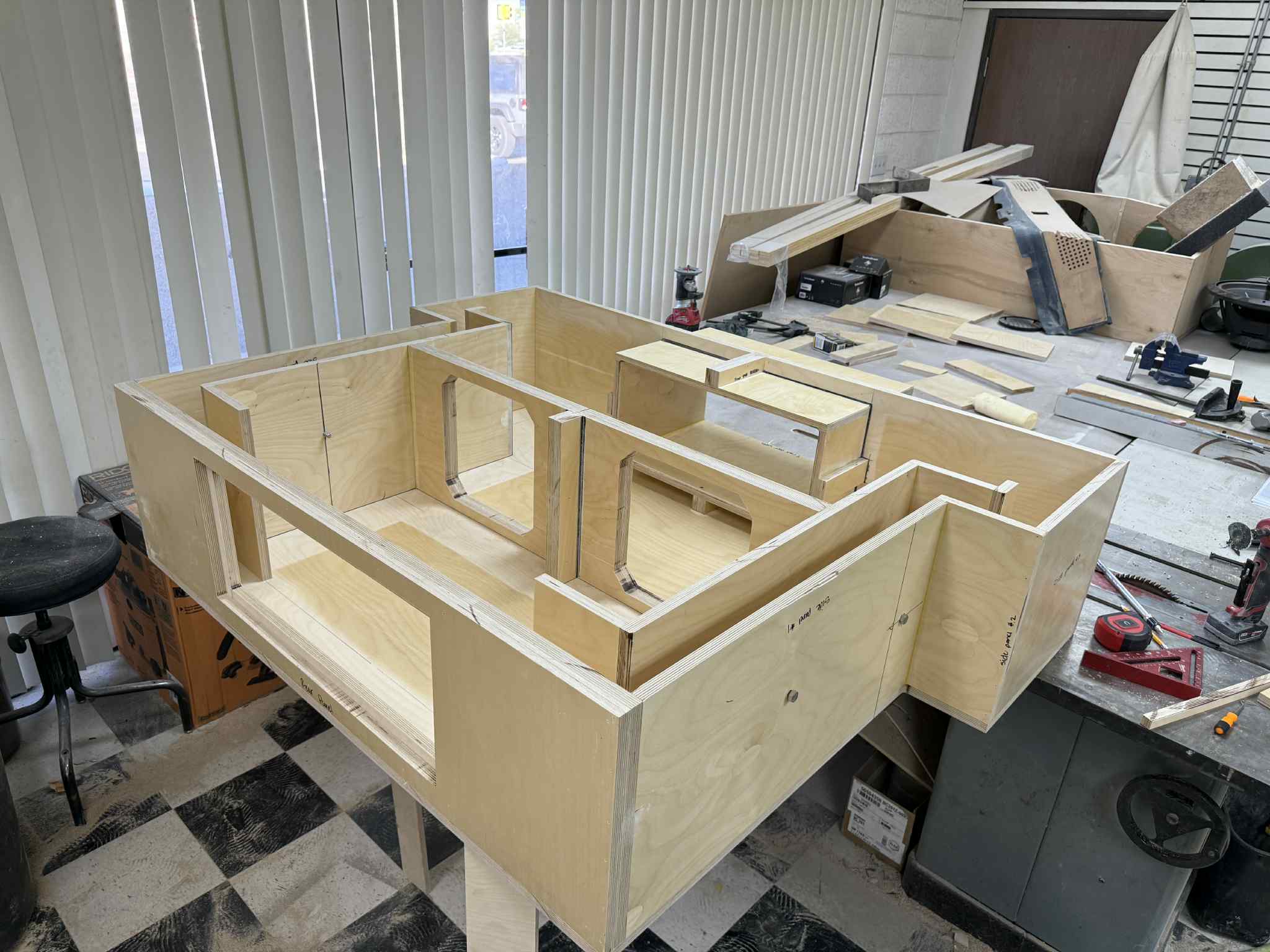

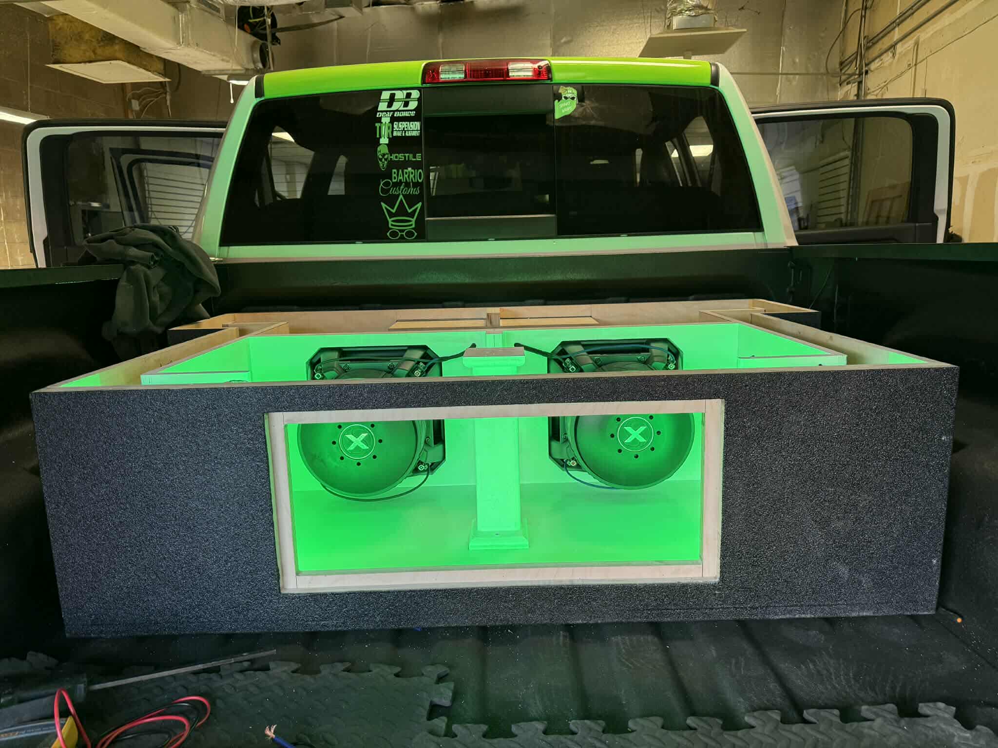

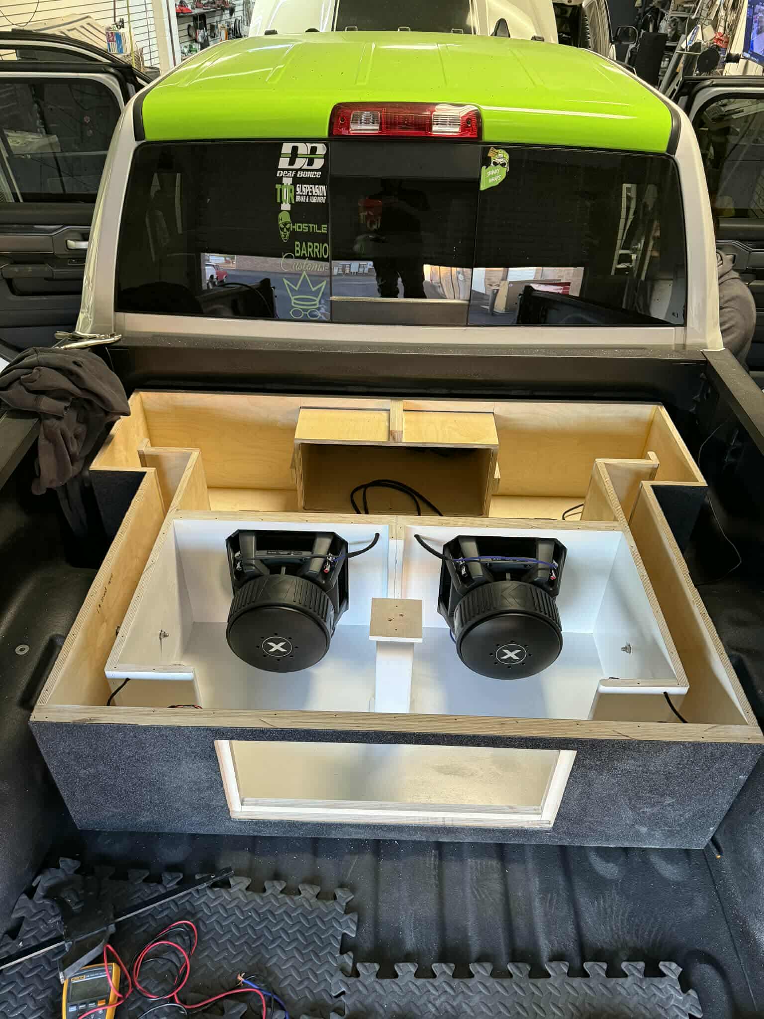

185.67in2 tuned 27.3hz/54.6hz, Baltic birch /w/ stripper poles for the top panel and allthread for the side panels eventually. Acrylic window and removable top panel too. For now a DB 7.5K @ 1 ohm... lets watch the user upgrade like crazy to find those limits... haha. I'm just the monkey on the keyboard who designed the thing.
Younger guy built it, I like his work I've seen so far. The shop owner is OG and I threw it out there that the owner should let said installer take this one on.
Looks pretty good to me so far...

Just my experience but there is a huge difference in output from a fullbridge @ 1 ohm and something legit /w/ the same rating that can be wired lower. We'll see what route the user takes.
I'm fishing for the usual responses btw. Once again those who know... know

So is that a series tuned enclosure? What is it going in?
Dodge Ram, I still am trying to clean my hands after measuring the thing... haha
I'm a big Dodge fan obviously.
At least the body is solid and should take deadening well, I'm a Chevy guy but in this case I just focused on his gear and goals. It should perform well.
Monday I'll drop in over there and be a pain just to add my worthless .02
It turned out well so far so I'm stoked

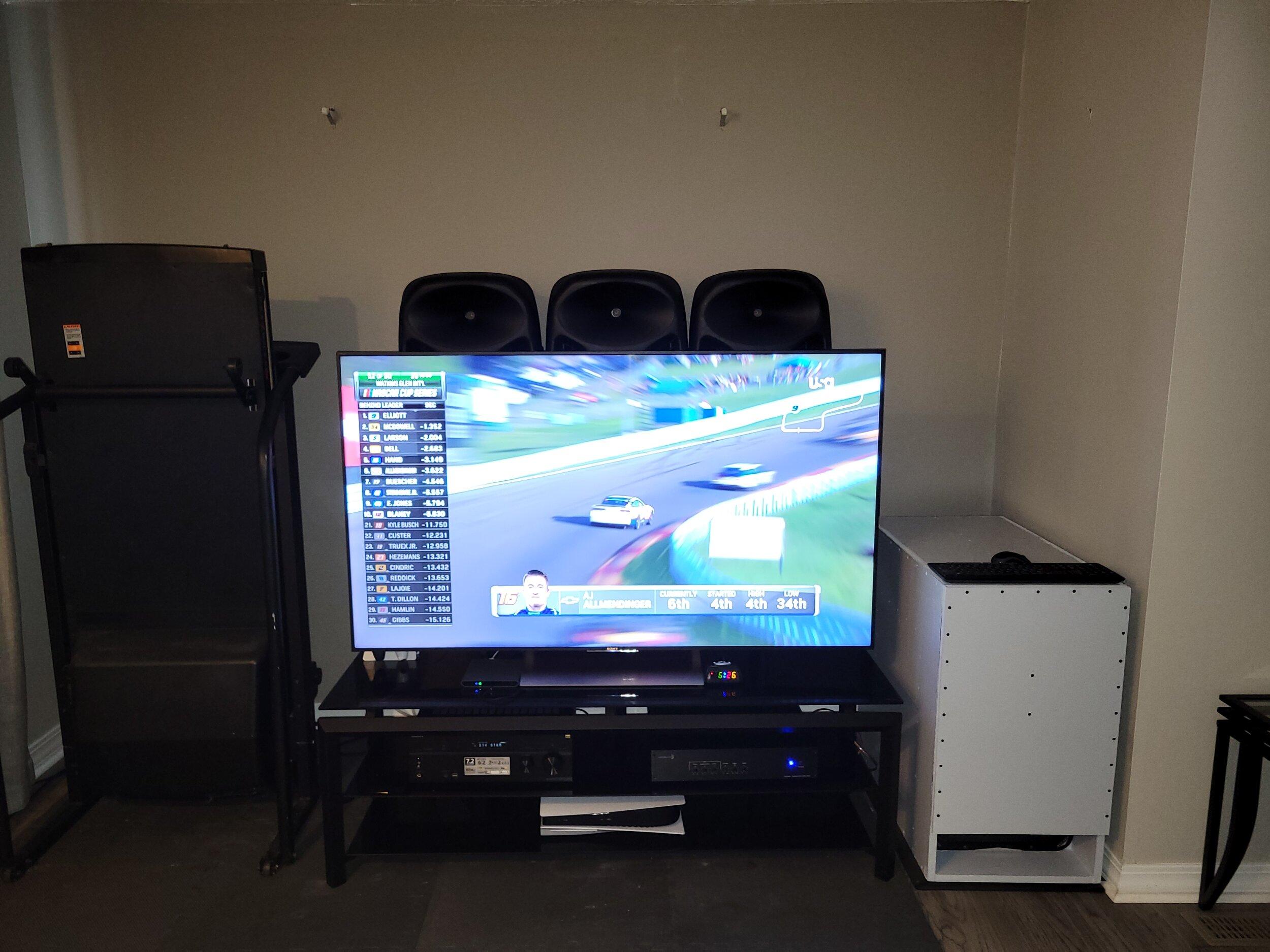

I want to say 700wrms. I cracked the walls on multiple floors with 200wrms from a Yamaha HTR-5730 in 2 channel mode. It's running off a Dayton Audio SP1000A now because Kylo Ren's force was shutting down the Yamaha at my reference listening level.
View attachment 69160View attachment 69161View attachment 69162View attachment 69163View attachment 69164
That's awesome man, I was working on developing my own way of doing those but got sick, that's my goal if I get better is to figure out a solid way to do those consistently. I feel like boxes like those are the way to home audio, line enclosures.
Thanks guy! Hornresp is your friend. It's the best FREE speaker enclosure modeling program on the planet.
