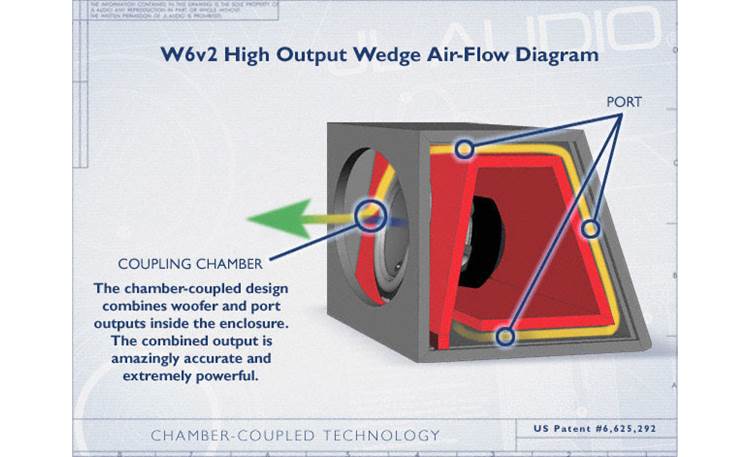

That all makes sense and then I see the JL HO enclosures... where the port meets in front of the woofer in the "coupling chamber" and it makes me think "what if there was a coupling chamber in the 6th order blow through?" You follow?

That's what the front chamber is. Basically the front chamber is just a resonance chamber you're adding inside of the rear port, with a series 6th. It's just a chamber to store energy at a different (higher) frequency that's in line with the port, as in the front port is actually just all a rear port where you tap or add in a chamber that can be charged with higher frequencies, so you can like double-pressurize. That JL box, you could like put a plate on that face and make an Aeroport front port or something and that would be a series 6th. I mean it's very close to a series 6th the way it is.

Like with the coupling chamber thing, this is basically a series 6th but where the sub radiates into the cab instead of into the "front" chamber. So like it's the same math pretty much, but my point is you can disappear the front chamber and it's just a ported box, so the front chamber is sort of like an add-on resonance chamber that is part of the rear port. This was built and I was told worked well:
It's basically the same thing with a series 6th, front chamber is actually part of the rear port, you can sort of think of it like that, so you want to make sure the whole port-system pressurizes properly in regards to port placement, optimally. And yeah today's subs in a series 6th would be stupid fun.
