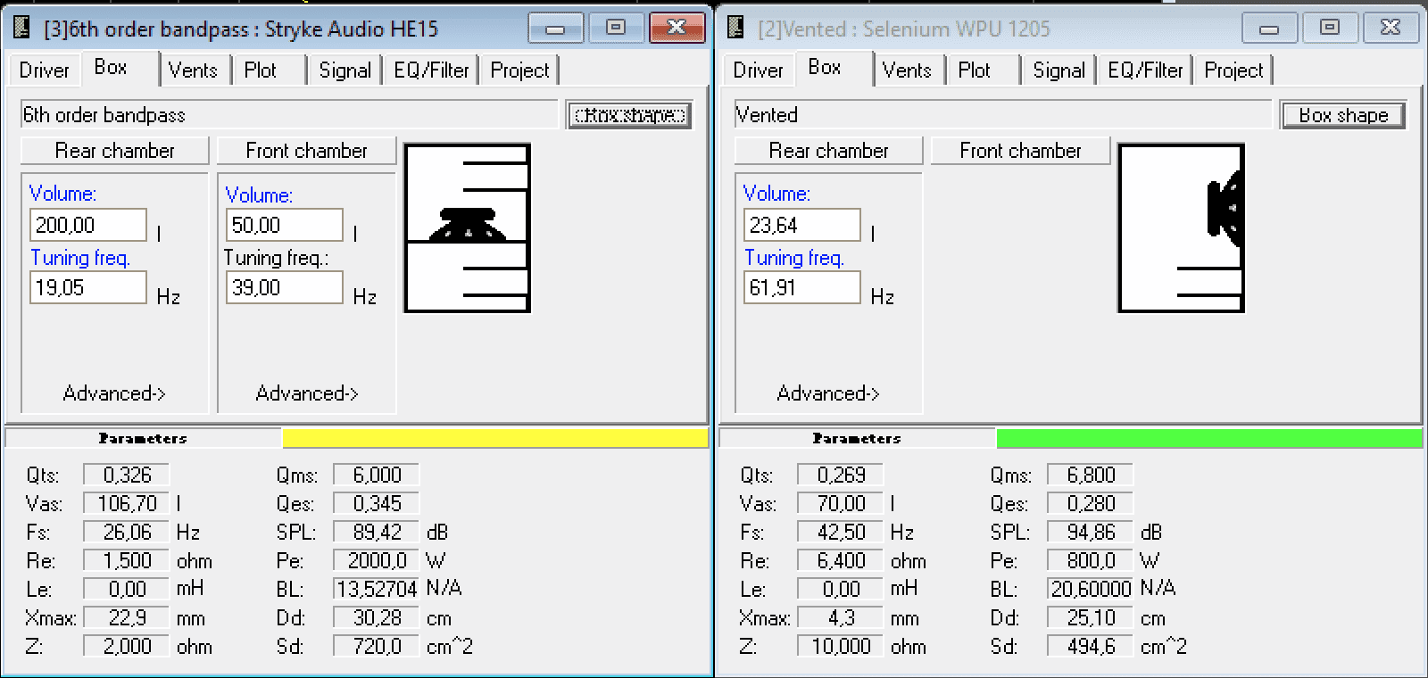

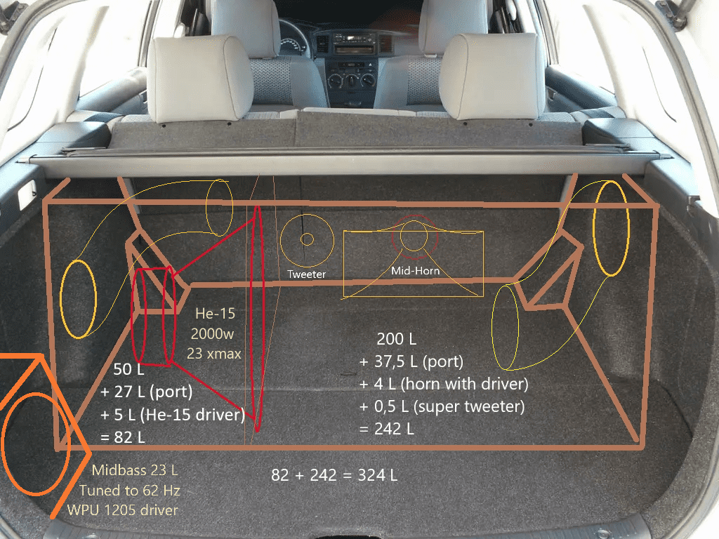

Hi everyone. Following my passion for real bass (20 Hz - 40 Hz), I'm designing a bandpass 6th-order dual-reflex box that may take up a lot of space:
Final estimated volume 324 L plus the volume occupied by all the wood, including the bracing
Trunk size: 450 L
DriverRange it will coverEfficiencyPower needed
(to reach 120 dB)
Stryke Audio He15 (23 mm xmax)20 Hz - 60 Hz89.4 dB/w2000 w
Selenium WPU 1205 (4.3 mm xmax)60 Hz - 500 Hz94,9 dB/w400 w
Selenium Neodymium Driver + Horn500 Hz - 5,000 Hz110 dB/w10 w
Selenium Supertweeter5,000 Hz - 20,000 Hz110 dB/w10 w

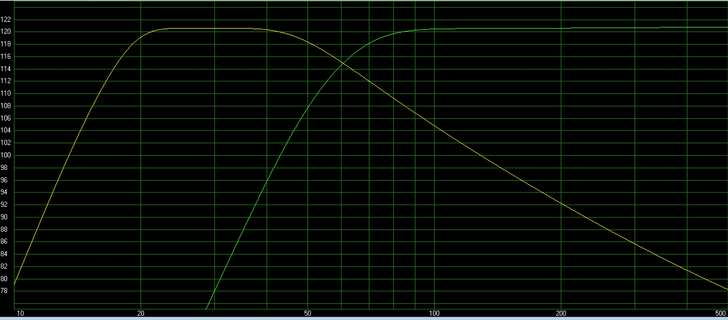

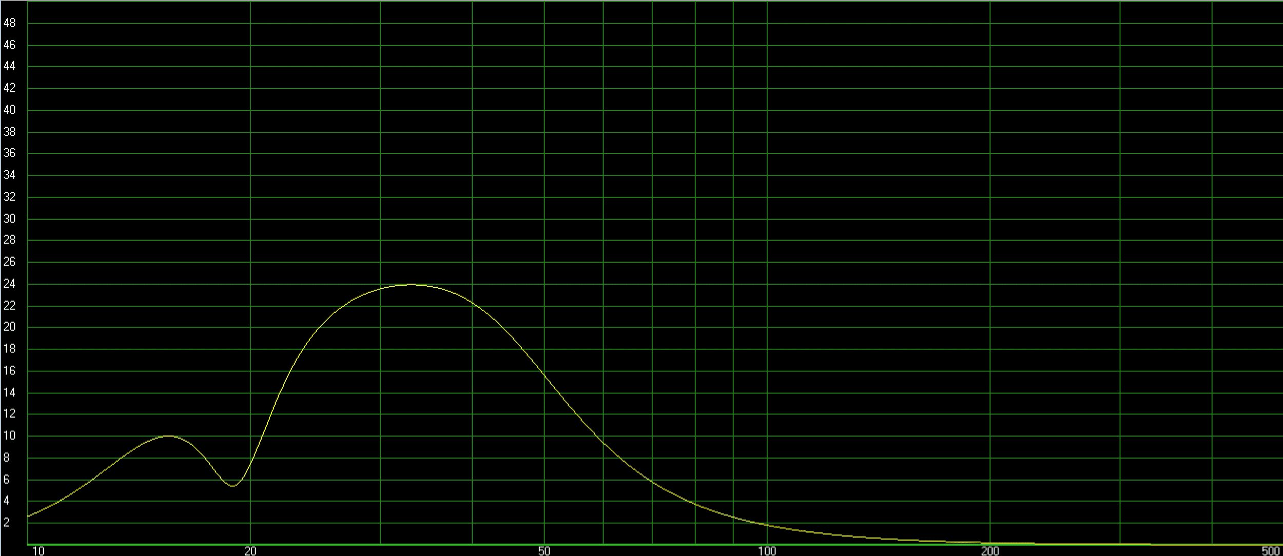

This is my first post, but not my first project. After many years of simulating and building subwoofer boxes, I figured out that nothing beats the BP6 box when we are targeting the 20-40 Hz range. This can be proven by this WinISD simulation which shows it can hit 20 Hz at just -3 dB from the speaker's reference efficiency:
SPL response:

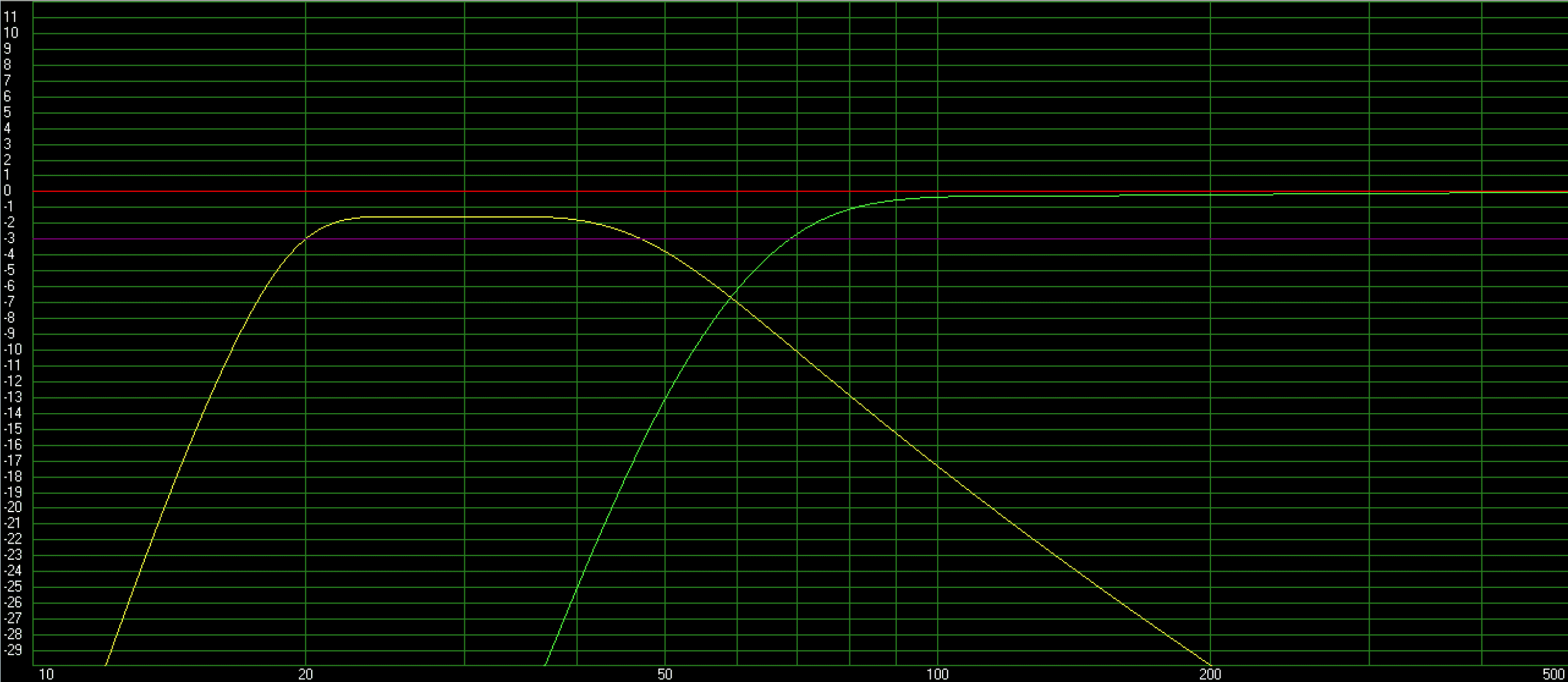

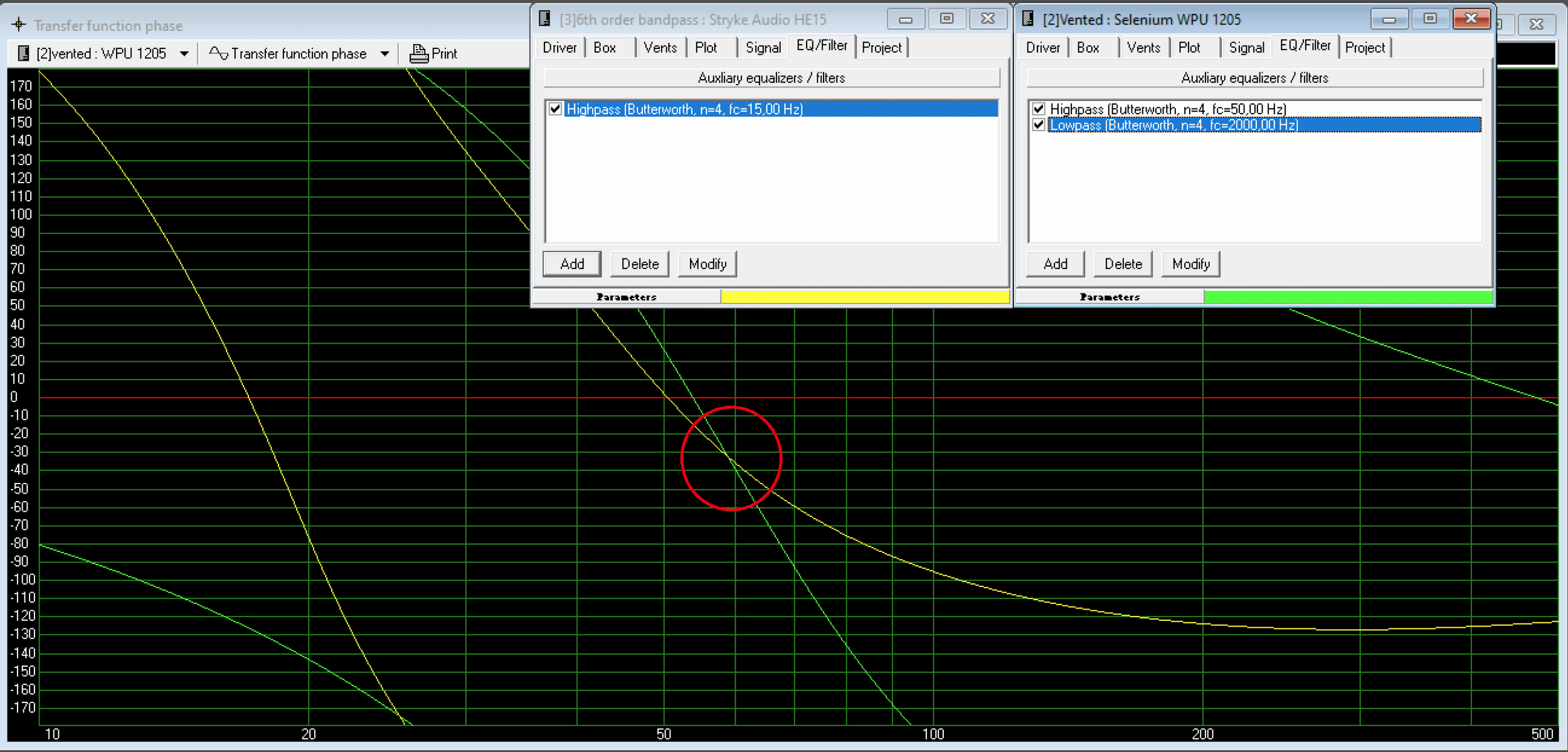

The phase responses of both drivers match at 60 Hz, so I can expect a 6 dB gain at that frequency, which will cover the -6 dB drop shown in this graph at 60 Hz.

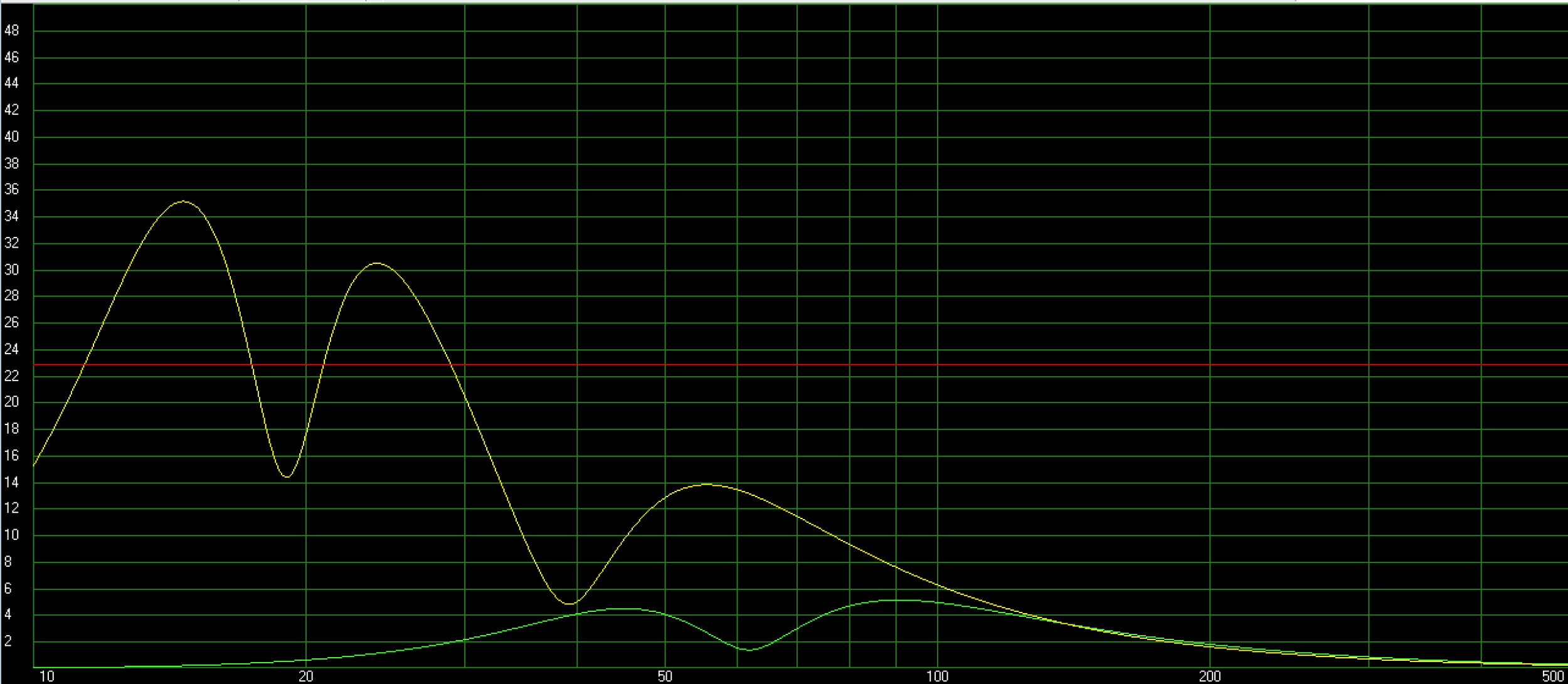

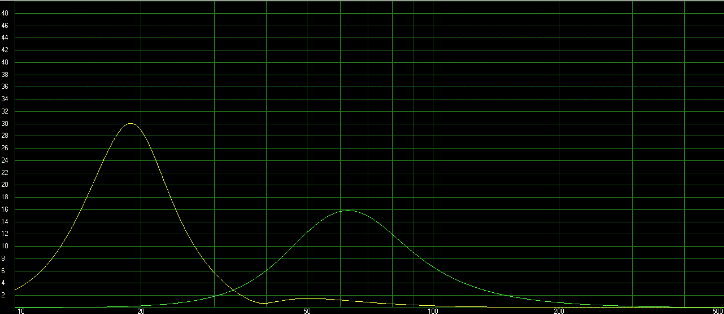

Cone excursion is slightly above each driver's xmax at peaks (23 mm vs 4.3 mm):

I have already built an experimental BP6 box covering that same range. It was a cheap but special 12" driver which had a very low Qts around 0,21. It was tested over the back seat along a 50 L bass reflex box tuned to 40 Hz that was on the trunk. The result was the most pleasurable sound I have heard in my entire life. I had placed the BP6 box over the back seat. The challenge now is to make one much bigger that fits in the trunk.
The former experiment was designed to produce about 110 dB of 25 Hz. Since the car gain gives +12db/octave from 70 Hz down, the bass was probably hitting 120-130 dB at 25 Hz. Yet, since our ears are very unsensible at that range, I felt like having the bass much louder would be even better. So my target now is 120 dB flat down to 20 Hz. With the cabin gain, that would perhaps hit 145 dB at 20 Hz. That's something a normal decibel-meter won't be able to measure, but the sound would be indistinguishable.
Those are the potential issues I have with my current design:
  1. Installation: I need some sort of screwable window that allows me to access the driver He15 to install it after the box is already in place. Because the mounted box can get too heavy.
  2. Bracing: The box has very big walls, so it may need too much internal bracing. That may take up too much internal space and add too much weight.
  3. Other parts: I need to plan some space for the amplifiers and the supercapacitor (such as Xstatic Batcap).
I'm open to suggestions and all types of constructive critiques.

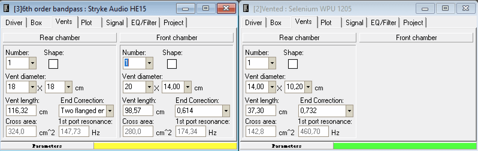

Quick and dirty assuming a 2K sub with 23mm xmax I'd say both chambers are severely underported. All your assumptions about in car response and how it'll all come together I'll digress about.
It appears to me like it'll be severely output limited as is.
Maybe its all those metric units throwing me off?

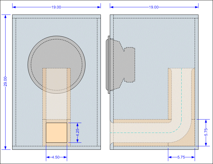

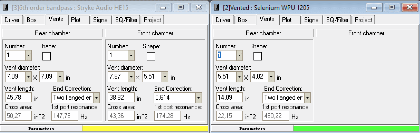

Hi. Below you'll see the same port specifications that I have shown before, but now in inches:
Since the graphs seem to be OK in terms of SPL curve, cone excursion, and air velocity, I can't figure out what you mean by "underported". In case you are talking about the port frequency, the He15 is a special driver that features low Fs and low Qts. Those aspects shift down it's ideal tuning frequency. Added to that, the BP6 box requires tuning into a lower frequency when compared to ported boxes.

It WAS the units in metric, that front port length tho... Good luck
Are you talking about the port of the BP6's front chamber? Are you talking about its size?

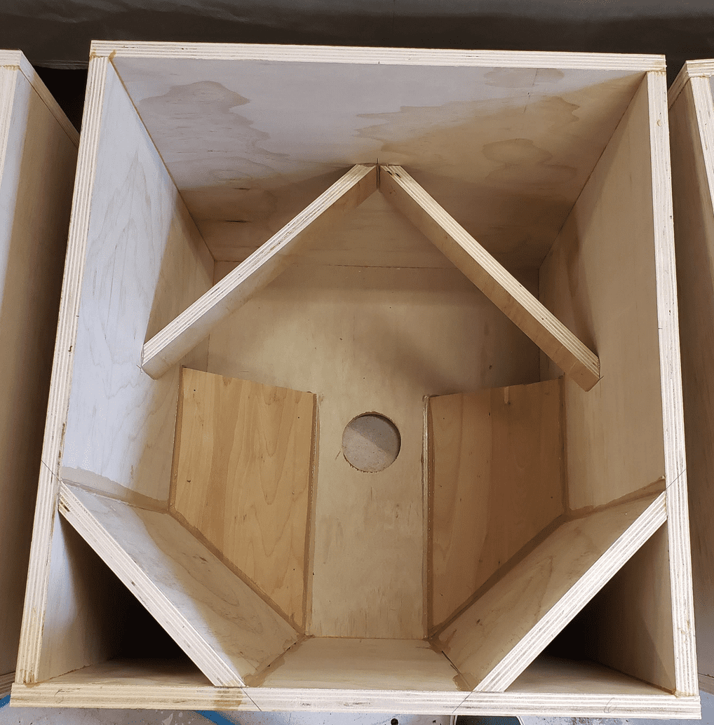

Both ports of the BP6 are of similar size, about one meter each. The drawing shows a flexible tube, but that was just for illustration purposes. Usually, we use a labyrinth of wood in BP6 designs, just like this one:
I'll probably use the ports as bracing, similarly to what was done in this image:
But I think it's more effective for bracing to do something across the middle of the wall, like this:
Source: https://techtalk.parts-express.com/forum/tech-talk-forum/30344-square-port-good-or-bad
With enough woodwork, I could add a big flare on both ends. I have done that before and I know it's not easy, but doable.
