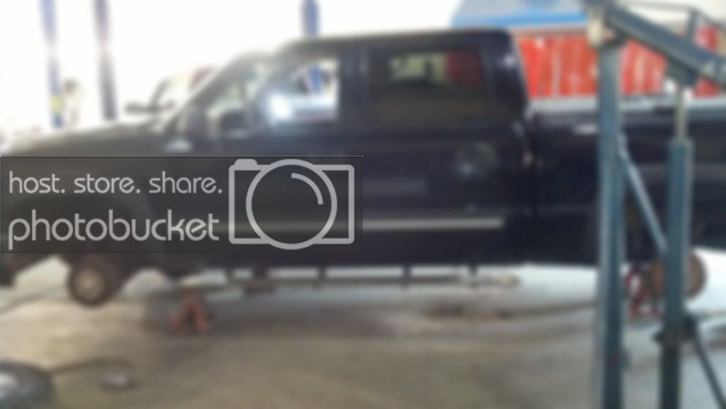

Got my new tires on her today in shop class //content.invisioncic.com/y282845/emoticons/smile.gif.1ebc41e1811405b213edfc4622c41e27.gif
Her name is Gertrude //content.invisioncic.com/y282845/emoticons/fyi.gif.9f1f679348da7204ce960cfc74bca8e0.gif

Looks more like you just got jacked.

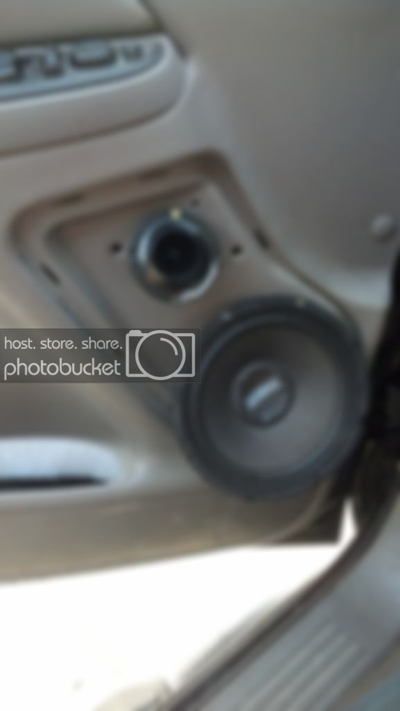

I ran wires through the doors today and it was a pain in the ass!!!!
Didn't have time tonight to make the baffle or pods for the door.
I hooked that **** up and just screwed it into the door so I had tunes tomorrow.
Sooooooo ghetto //content.invisioncic.com/y282845/emoticons/fro.gif.c695f1f814b01c4ad99fe7f8cccadd29.gif
Already punched in the dustcap too....
Got them from the Sundown Yardsale for a fraction of the price. Got 4 minty ones and two with pushed in dust caps
Some sticky tape or a vacuum hose can often pull those back out. If there's a pole vent blowing really hard into the pole vent might pop it back out as well. OR a very tiny pin bent into an L shape plus a drop of glue.
Yeah, I may try that later on. For now, these are temporarily mounted and I don't have to worry about messing them up.

i got lucky or something because my kick panel polk speakers did the same thing and was punched in, came back the next day and it was back to normal lol.
