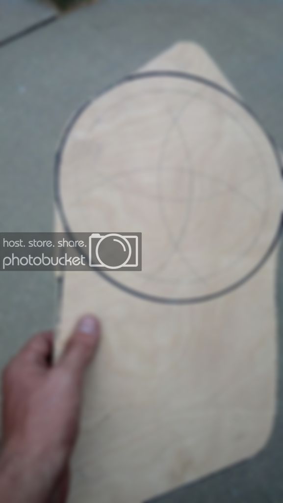

Did some Illuminati shit that I learned in geometry class to find the center of the circle

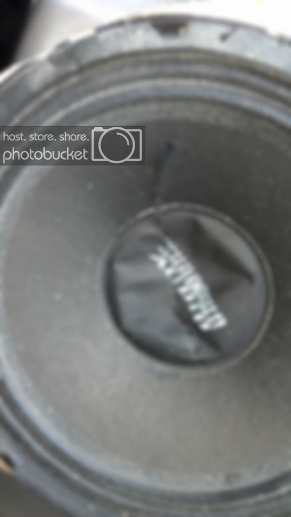

Mid fit
I used a hole saw to cut the tweeter mounting hole. Mistake to leave the mid mounted in the baffle. The edge of the blade bit wrong and skipped onto the cone of the mid. Tore through the dust cap and part of the cone //content.invisioncic.com/y282845/emoticons/crap.gif.7f4dd41e3e9b23fbd170a1ee6f65cecc.gif

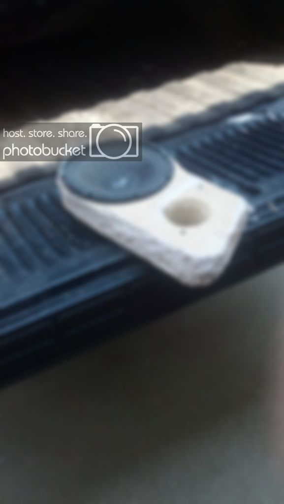

Now I got a stencil for future reference..

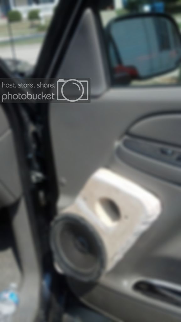

Here's everything mounted in the door. Probably going to bondo the edge of the plywood layers and then wrap with fabric

I had to space them out from the existing speaker holes. I think stock was 5 1/4. Otherwise, it wouldn't fit
i could swear all our trucks were 6.5 in the doors but they have tiny mounting diameters on stock speakers or something, it was hard to fit a 6.7 in there.
