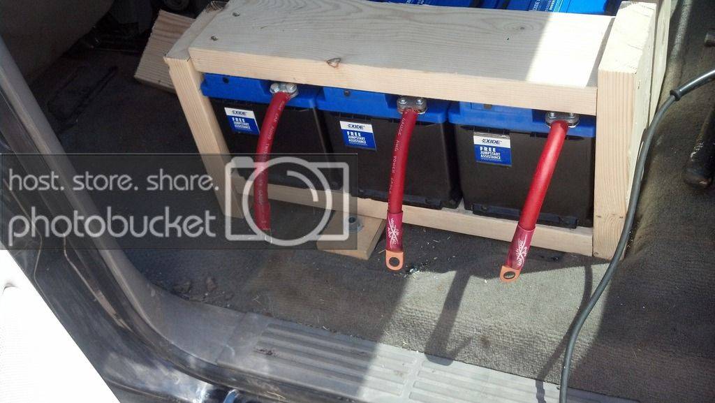

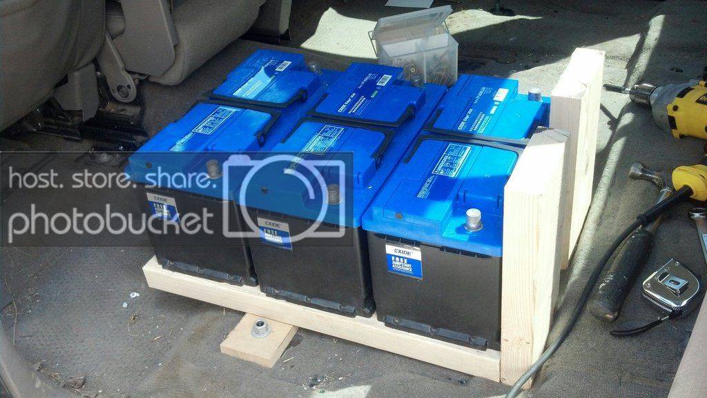

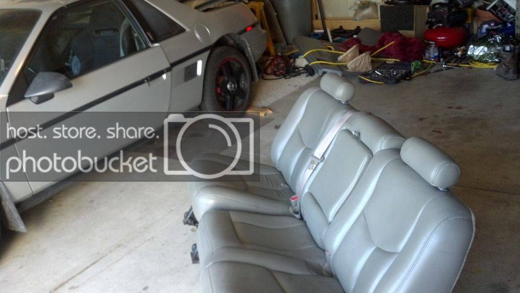

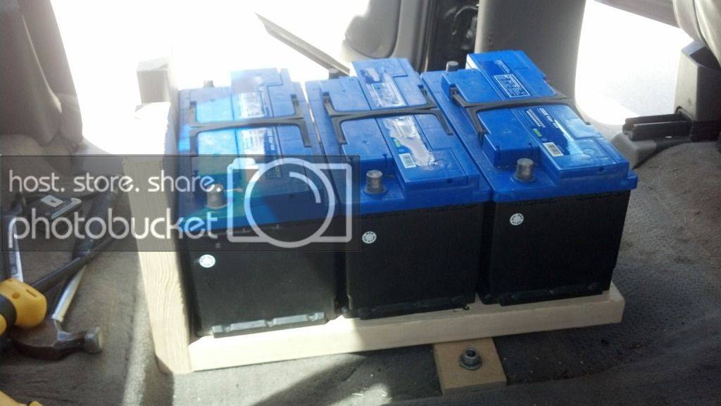

So far, I just got the back seats out. Going to start on the battery rack in the back today too

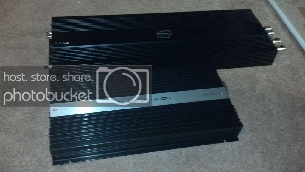

Amp is a Taramps 20.2kw

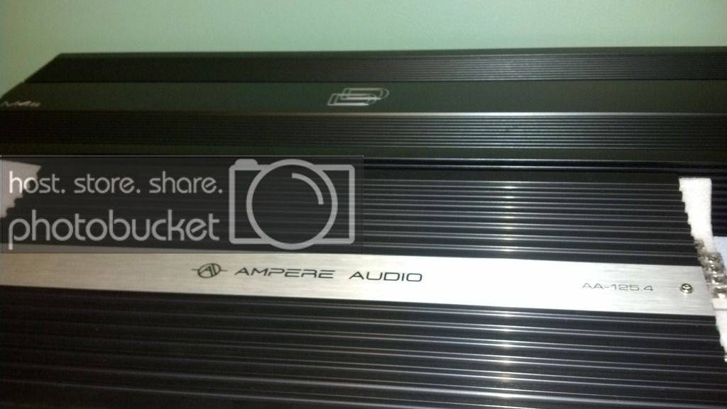

Mids and highs amp will be my Ampere 125.4 run active

Electrical will be six Exide Edge group 49’s. I’m getting the sixth one tonight in a trade for my car.
Wire is all Sky High 2/0 OFC, which is like 4/0 welding cable
