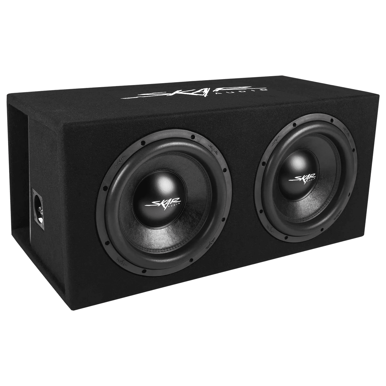

So are you saying with the port being on the side of the box it would sound worse? This is the box, I like how the port is on the side on purpose so that the subs can sit closer next to each other, reducing the length of the box.
I like how the port is on the side View attachment 62305
In a trunk side ported is fine, as long as the port is a port width minimum away from say the strut tower for example. Positioning the enclosure can enhance the output or kill it.
I'd focus on deadening and getting the sound into the cabin for best performance once the enclosure is fully positioned.

So are you saying with the port being on the side of the box it would sound worse? This is the box, I like how the port is on the side on purpose so that the subs can sit closer next to each other, reducing the length of the box.View attachment 62305
As Shredder said, if the box speakers are firing into the trunk, you'll be fine. But, if you fire the speakers into the cab, by dropping the seats or cutting the rear deck, then you would want the port facing the same direction as the speakers.

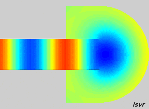

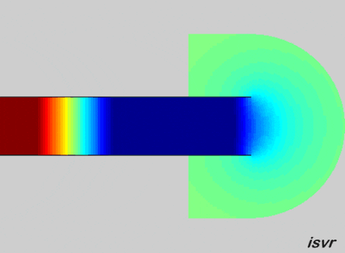

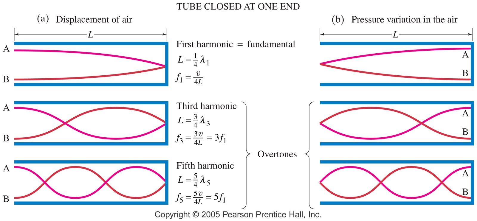

I just always look at everything from the view of an organ pipe:
Distance is tuning. A transmission line type enclosure is based on the quarter wave that is the same as organ pipes that have one open end and one closed end. You can look at a whole vehicle this way, or the distance in between radiating surfaces, and how the distance changes phasing, like subwoofer distance from port opening. It happens in 3-D, but looking at it from a 2-d perspective can help with basic understanding and calculations. For example, you can look at the length of your whole cabin as the internal 1/4 length of the transmission line enclosure or of an organ pipe. Front firing in a trunk without sealing off for a ported enclosure can make the air in between the outside of the box and the inner trunk walls into its own enclosure that can be unintentionally "tuned" to cancel out wanted frequencies from your box. Visualization of sound in pipes or ports or t-lines, think like 1/4 wave tuning and standing waves:
Lower frequency:
Higher frequency:
