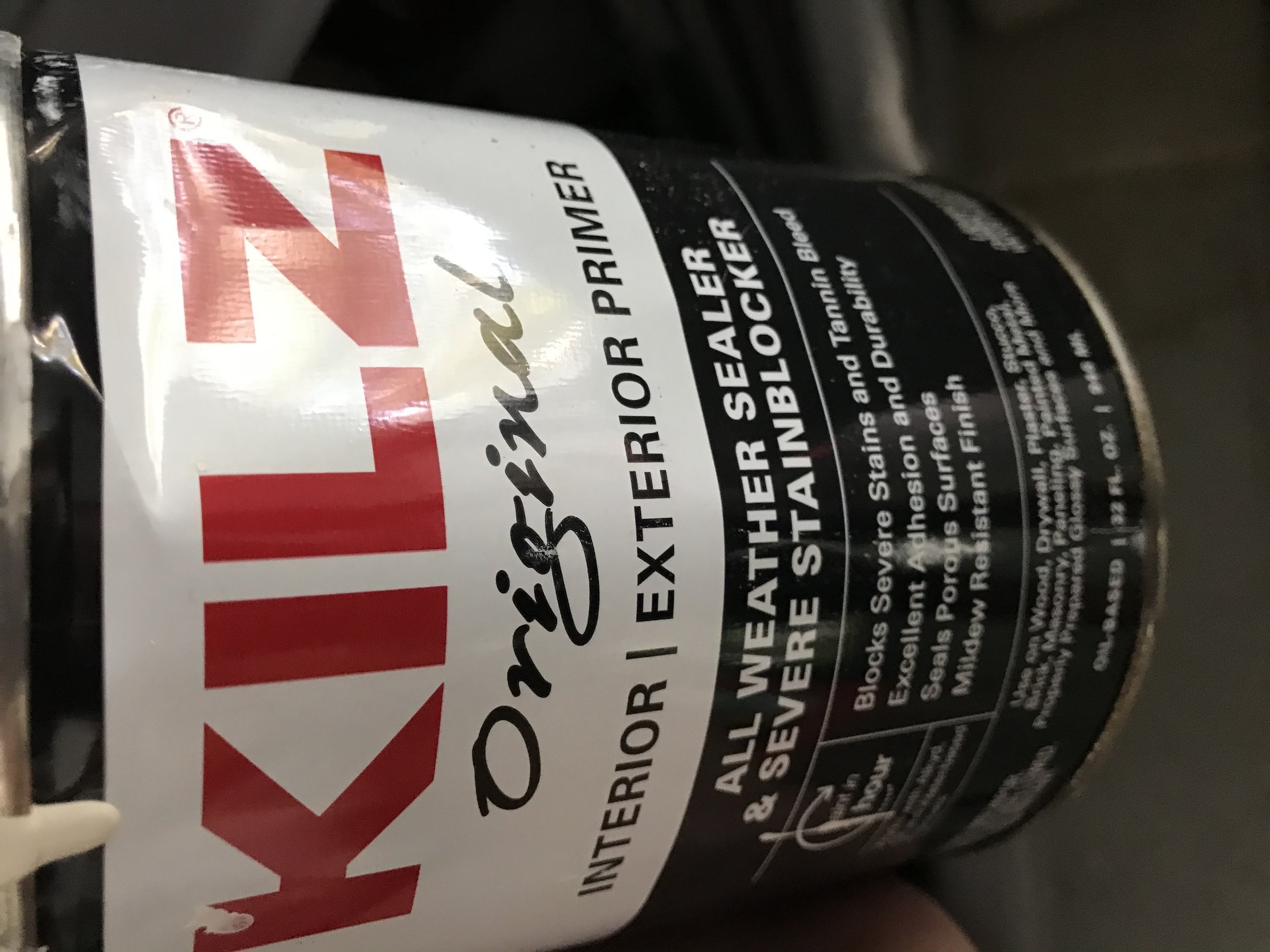

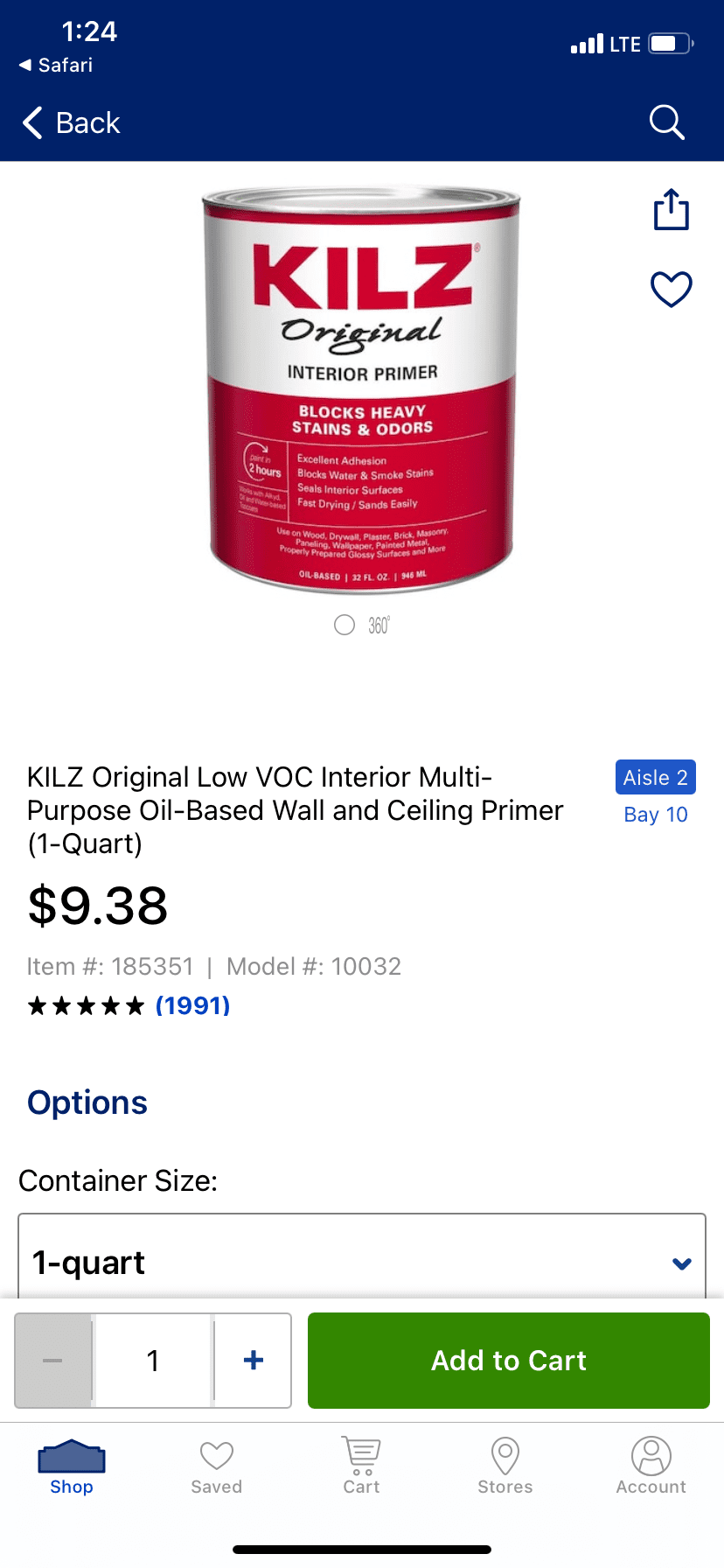

Kilz original is oil based that will work.
Kilz 2 is water based which you don't use on bare wood
