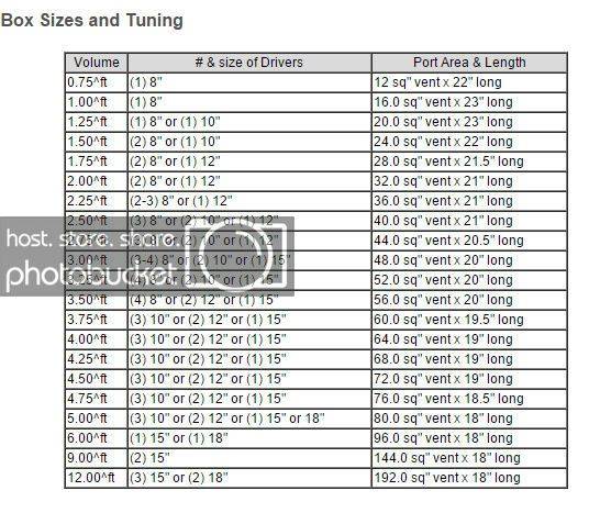

Area of a circle is Pi*r^2 And you measure from center of surround to center of surround, the frame doesn't count nor does that part of the surround that isn't "live".
Box Sizes and Tuning
Or just buy the cheapest subs you can find, cram as many as you can into your car then come back and tell us how that plays out for you.
Thanks for that link....i didnt realize i was that far off box size wize.... i was thinking "ehhh, 1 15 needs 3cu, I can lose all trunk space and get 5cu and just short them .5cu each feed them each 200w less than rms rating and be ok, not knowing soundqubed recommends 9cu for 2 15s... I wasnt being an *** just didnt have anything to go off of...
