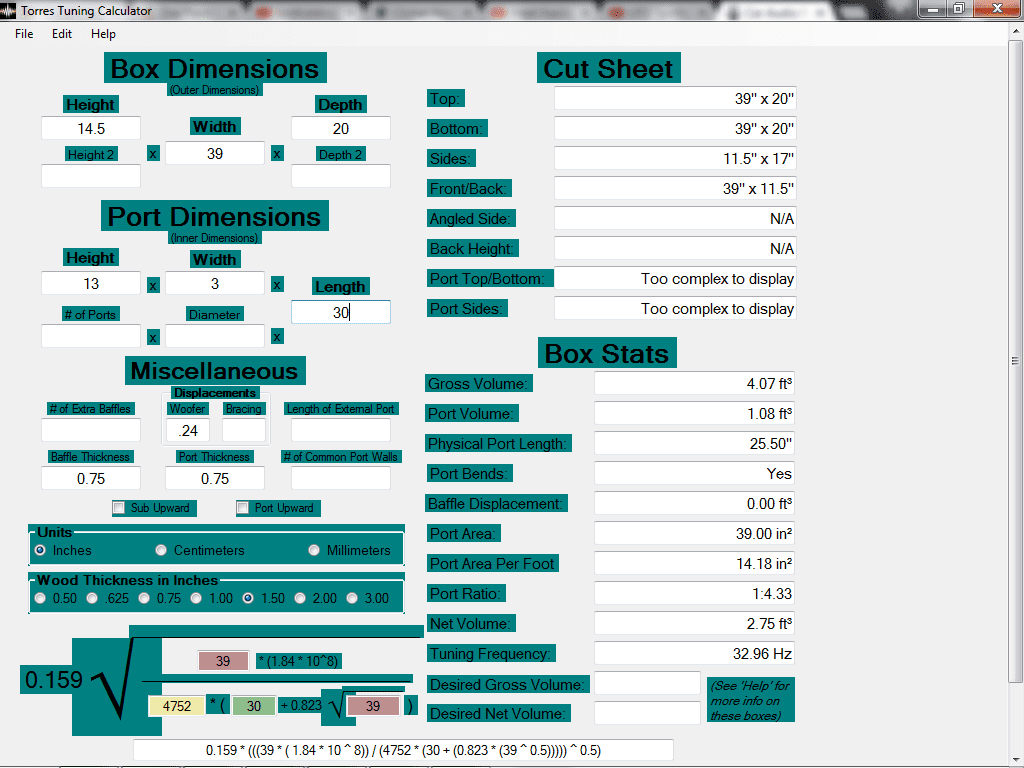

No, you severely underestimate the amount of space woofers and port take up. 4 cubic feet starting out is just enough for a paiir of tens.
Here is an example of a 4 cubic feet gross box, pay attention to the net cubic feet afterwards.
rough estimate of dimensions ive been using are 40"W x 9"H x 26" D... .75 wood thickness .... and if i build into the spare well that should be good for another 1.25 to 1.75 or so... i currently have another battery in the wheel well but dont know how i feel building over it an no longer being able to access it..
You also underestimate how much port area you need. A 4 inch port aint sh*t. You will run into port noise problems and have severely limited output due to that. Theres a port area per cubic feet reatio you want to stay within, simple guideline would be 9-13 for aeros and 12 to 16 with slot ports. With a 4 inch aero in that box you are at 3.
My advice is, Re-evaluate all your knowledge on box building and do more research on proper port area, rear air velocity, proper airspace proper sub loading etc..
