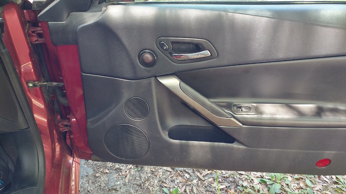

My first "Active" "SQ'ish" build attempt.

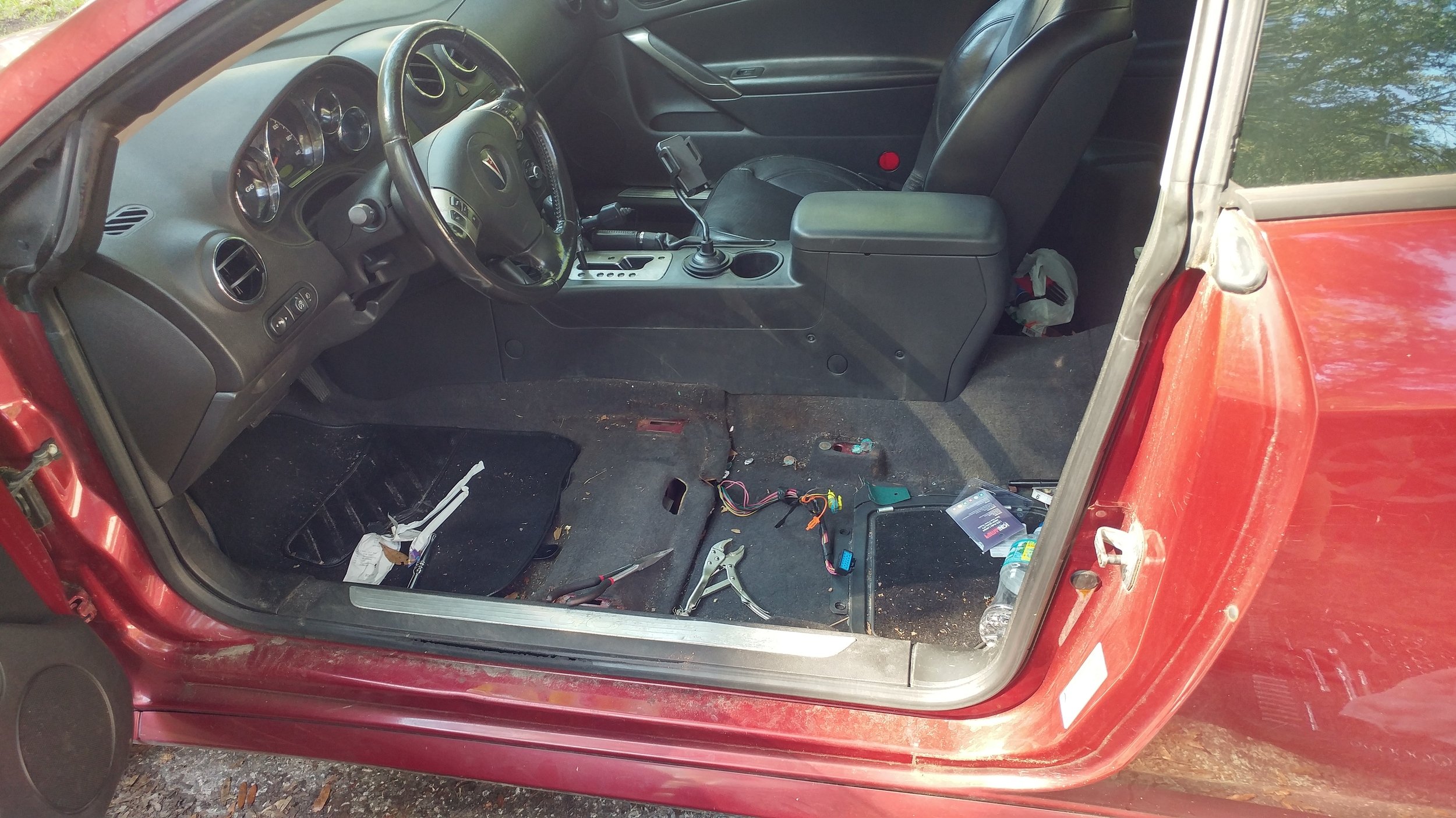

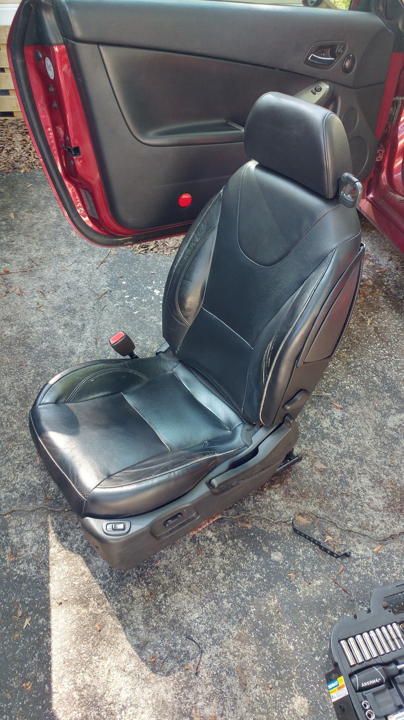

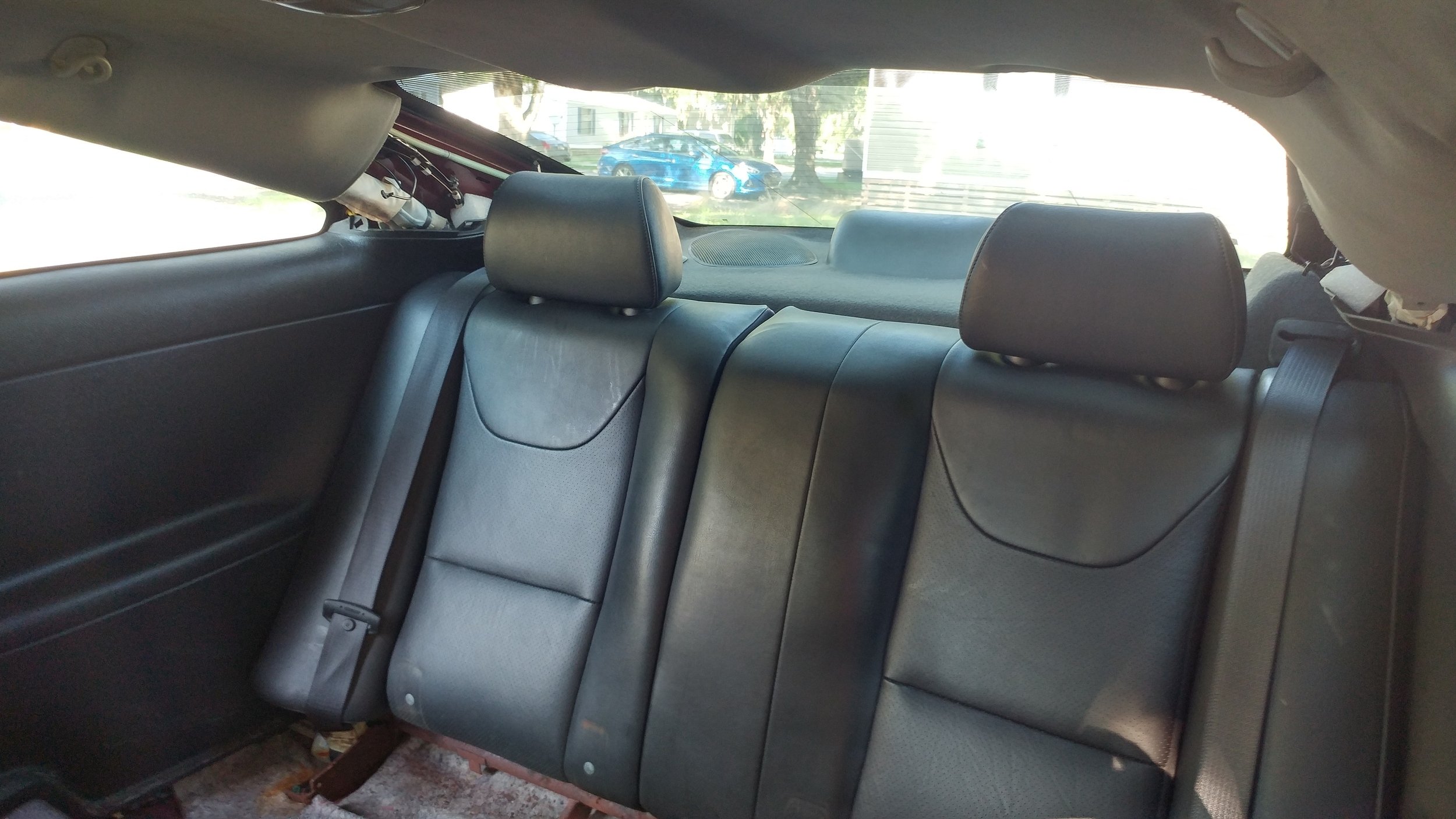

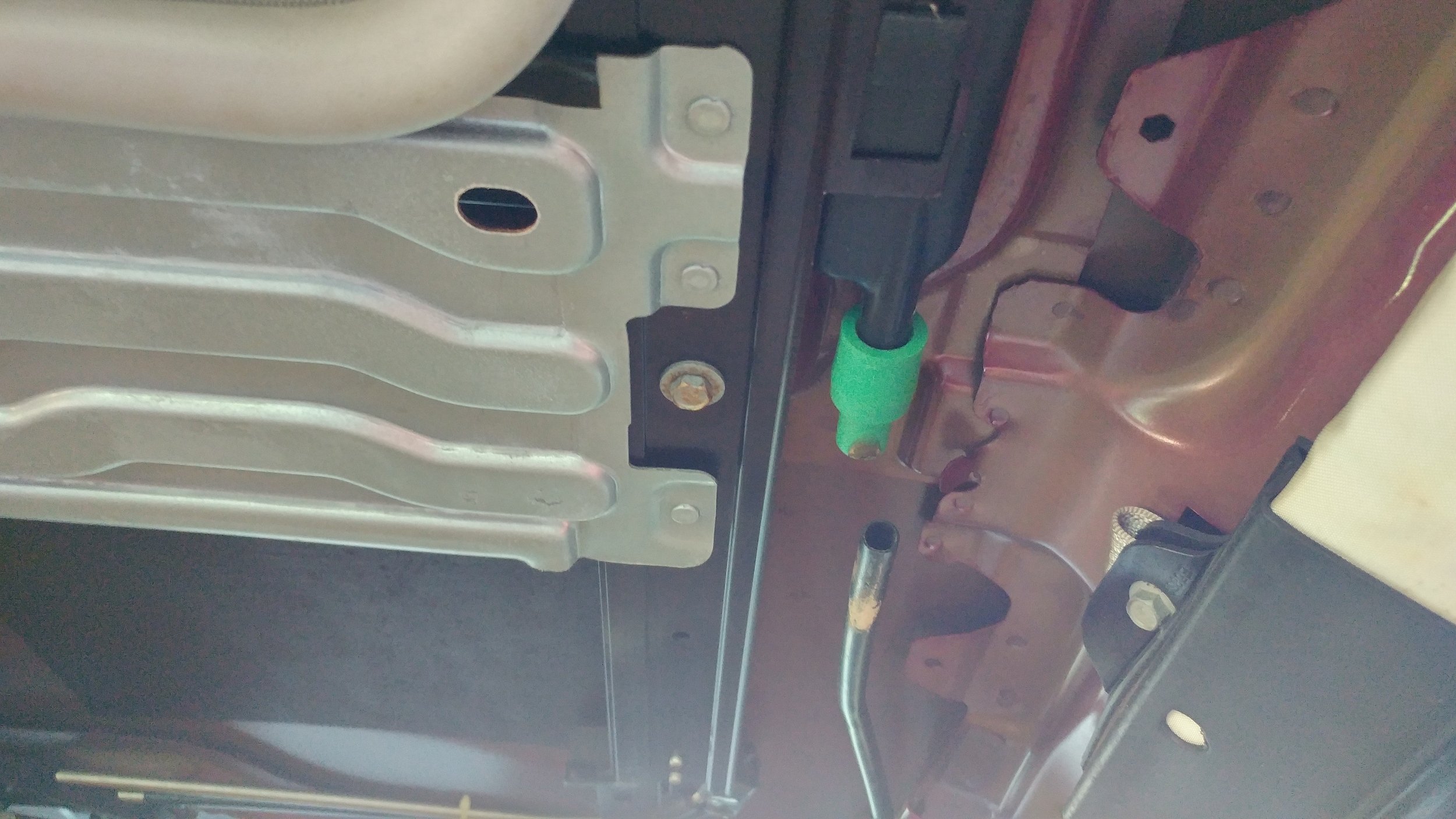

Bills, Bills, and more Bills. Yeah, it's slow going but once everything is here and the sub box is built... the rest is going to go pretty quick. I decided to NOT install anything until I button down the sunroof leak. It has 4 drain lines in the sunroof... I fixed the front two with compressed air. The two rear lines are harder to deal with so I am taking down the headliner completely and I am going to put new headliner material on to replace the gray with black while I am at it.

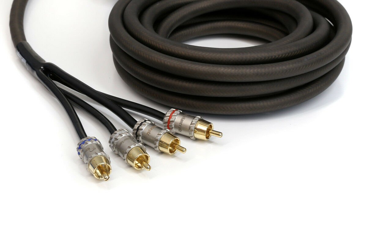

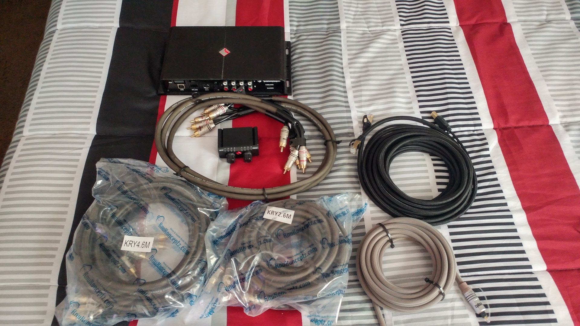

I am in the process of ordering parts to complete my 3Sixty.3 DSP... waiting to be able to purchase the remote for it. I ordered the patch cable to connect the remote to the DSP... RF says use a CAT5e cable... so I got a Black, Nylon sleeved CAT7 cable which should put the kibosh on any and all interference that may have happened with a CAT5e cable. I am going to be running a Class D amp near the DSP and RF says to keep the "CAT5e" away from a class D amp. Should be no issues with the CAT7. This cable will also visually match my USB cable that I bought for the DSP.

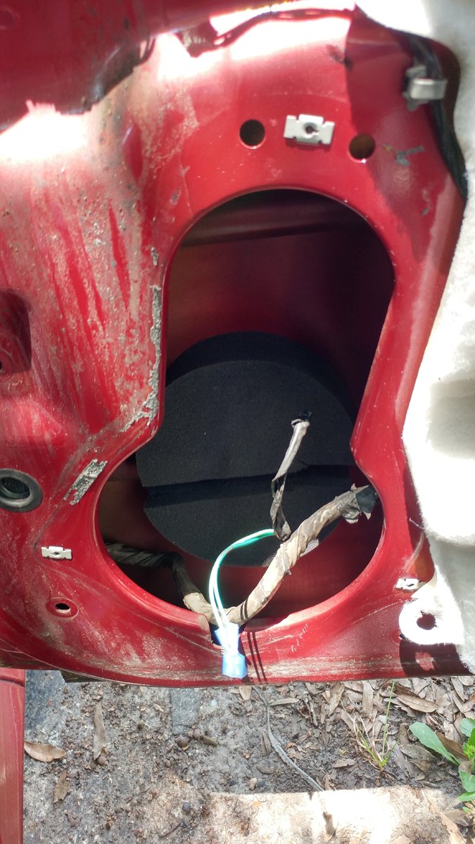

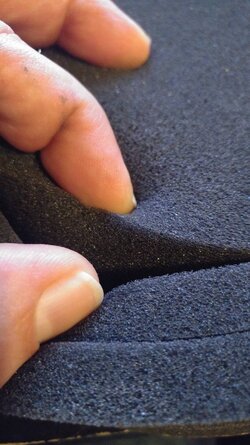

What sort of foam plug are you putting behind the speaker? I’m assuming it’s not an open cell foam plug that will retain water every time you wash the car, or it rains. I haven’t seen the Stinger fast rings, but if they are also open cell foam, your wasting time and money on those too.
It is in fact the Stinger fast rings... the package doesn't say what kind of foam it is nor does the website. Hmmm. Looks like open cell to me. I took a pic... you tell me?
I got my Cat7 cable today. Has a very nice and positive click when plugged in to the 3Sixty.3. The first thing I bought for it was the USB cable also shown in the pic. The car has dark carpet and trim so I wanted the cables to disappear into the car. The USB will be hidden but accessible for connecting to the laptop even after the install is complete. I am trying to plan ahead as much as possible.
The fast rings will hold water after a little while, tried it myself and I don't think they actually work as advertised. The Fast Ring made no discernible difference in SQ with my installation and the only reason I got them in the first place was because they were free with a set of speakers I bought. Not trying to rain on your parade either but I would be surprised if those silver flutes sound better than those high res Sony's you had. The Sony tweeter might have been shit but I bet the woofer was half way decent. The Sony's are made for a car door with a higher total Q and a resonant frequency ~ 60-80. The  Silver Flutes have an fs of about 37.5 and a total Q at a low .24. Without the air spring action offered by a smaller enclosure as they were designed to help the woofer out, the total Qtc of the system with the Flutes (total Q) will be low and bass response will suffer as a result. Attached is a graph I did in bassBox6 Pro showing an AudioFrog GS60 vs that Silver flute in a 1.5 cu ft enclosure simulating a car door so you can see what I mean. It has an fs of 80.5 and a QTS of .67 so the AudioFrog has a stiffer suspension more suited for the infinite baffle environment that is typical of a car door. The Silver Flute is in red and the GS60 in yellow.

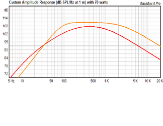

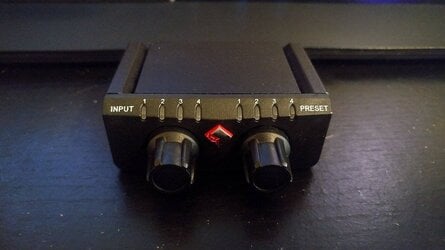

Only one more piece to get for the DSP now. I just got the remote from RF, they shipped it FAST. The last piece is the AptX HD Bluetooth receiver which will connect via an optical cable... which will also be gold tipped and sleeved in black nylon. ;)
