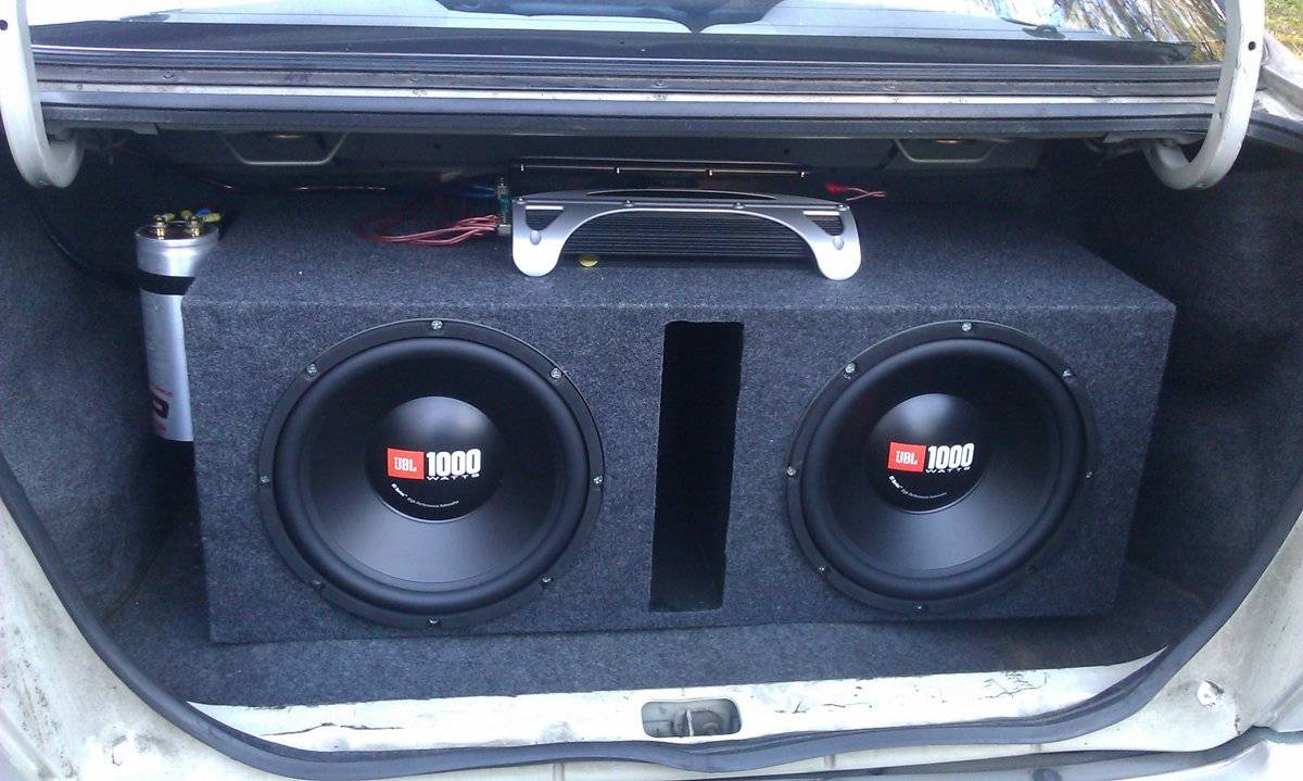

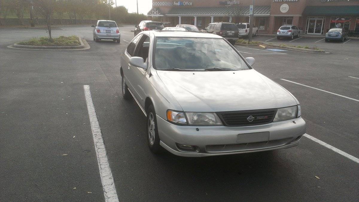

Holy Hey Zeus!!! Ok, my co-worker probably isn't going to sell me his G6 GT. So today, while out on my deliveries, I stopped by a guys house and talked to him about a car he has in his front yard. It is a 1997 Nissan 200sx 1.6L 5-speed car. I have owned two of them as well as the 4 door version, the Nissan Sentra. I am very familiar with the car and have had every interior panel out as well as all the seats. It is a straight forward car and a great foundation for a car stereo build. Double Din stereo opening, 6.5" speakers in the doors and back dash, roomy trunk that can hold two twelves. It's a quiet car that can be sound deadened easily.
The guy told me that he would be interested in selling it so I told him I am interested in helping him free up some yard space. I left my name and number with him and ask him to think it over and let me know what price he would like to start at. He said ok, will do, talk to you soon. I really hope he calls or text. The last person I talked to said I could have his VW Jetta and I was all set to go get it and his wife said no... I was really bummed. I'd rather have the 200sx. It's great on gas.
Her is my Silver '97. I hope he calls, the next system will be so much better.
