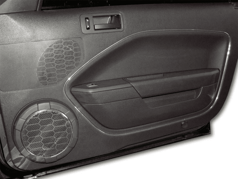

I checked the 2005 GT and it shows the 8" and a component set in the 6x8 area. A 6" or so and a tweeter. Factory 3-way setup!!! Kinda makes me want a Mustang.
