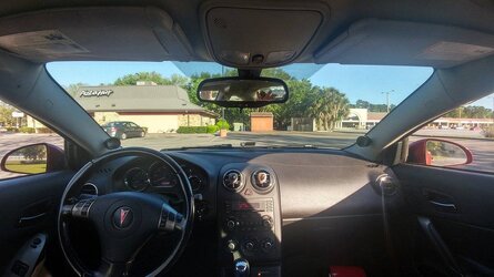

That is exactly the placement I am doing. The 2.75" mids will be literally a few inches away from the 6.5" midbass. The Alpines will be in pods on the far outsides of the dash at the A-Pillars facing the general direction of the drivers head.

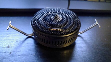

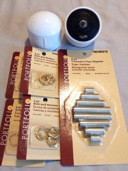

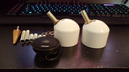

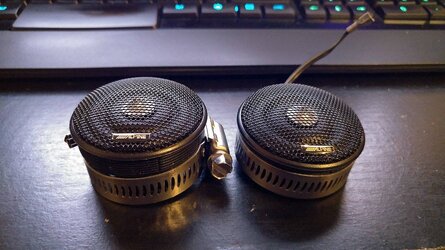

I got the materials to make my tweeter pods. I am surprised how well these Alpine tweeters fit inside these 1 1/2 inch pvc pipe caps. The other items are from the lighting section and all items are from Lowe's for $14.94 after taxes. I am going to slot the mount hole on the pods to give more adjustment. I will be able to swivel and PIVOT <-- in Ross Geller's voice. The pods will be satin black and each tweeter will be soft mounted in the pods with RTV Black at four points, not all the way around the circumference, so the can be removed without damage but secured without fear of falling out. Being that these Alpine tweeters are perimeter vented on the back of tweeter, this will also allow them to vent as they were designed.
While working on my tweeter pods my buddy came over and we went out to the car and did some test placements of the pods. They look like the doo doo! The are so obtrusive. He said why don't you put them where the factory tweeters are? I said I don't want to drill the grills... he said why and popped the tweeter grill right out of the door with the factory tweeter. The Alpine fits right in the hole!!! They looked so factory in the holes. At first glance I don't think anyone could spot that they are not factory. Yay, more wasted money on parts I will never use.

I got about halfway done with the pods lol. I will be pulling the stereo out of the Jeep when I sell it. I will see if the eXcelon tweeters fit in the pods... I think the tweeters are of similar size. Not a big deal. On a good note, I was able to make them swivel and rotate so that design idea works flawlessly.
