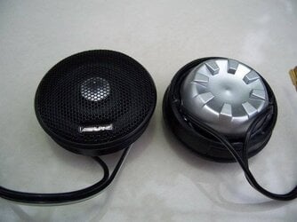

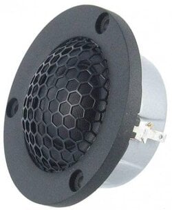

Calling all imaging experts!!! I was looking at my G6's dash and I have room all day to mount the tweeters on the dash or A-Pillars. Should I do this? The 6.5" mids will be in the lower door, there is no way around that but will having the tweeters on the dash or A-Pillars and the Mid-woofer down low mess up imaging? Will it matter with the DSP?
Second thought... On-Axis or Off-Axis for the tweeters with the mid-woofers being off axis in the doors? I mean do I aim both of those little fu**ers right at my face or slightly not directly at my face?
This is what I have been looking at... either the Alpine Tweets or the ScanSpeak Tweets but pods like this for sure for either tweeter. I'm pulling the trigger on the highs like REAL soon... REAL sooooon.

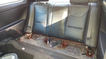

Took out the lower back seat and rear deck cover. What a pain in the Ass!!! I replaced the Monsoon 6x9's with some cheap speakers. I was able to reuse the factory connector and spliced it to the new speakers. Luckily the new "throw away" speakers had the wires for the tweeter running externally so I was able to clip them and splice into them. Basically they are wired just like the Monsoon 6x9's were. I think I will make my own rear deck cover. Something able to be folded so I can install and remove it easier. I used some of my credit at the stereo shop to buy some used Sony 6x9's just for now so I don't hear all the crackling from the factory speakers. They are working well. I am going to make a removable third brake light as well... maybe Velcro to hold the factory housing.
I found out the right rear quarter glass had been busted out. I found the glass pieces under the lower seats... along with the source of the moisture (the under carpet padding). Obviously he drove the car for a while with the window busted out... including in the rain. Other than surface rust on non important parts, there is no structural rust. Since the seat bottoms are out I decided to use my Lexol leather conditioner after I cleaned the leather with leather cleaner. It smells MUCH nicer. That Lexol smells so good and as a bonus, the seats aren't slippery now. Once ALL the moisture has evaporated I will put the seats back in.
Been thinking about this for a bit today. The pic above... Would it be stupid to build an amp rack here and not put the lower back seats back in? You know what... It's a good idea. Amp rack where the back seat used to be :)

I don't know why... but my brain kept telling me that the amps need to be in the trunk. They do not. There is a lot of room right there. I could mount the second battery, hide all the wires, make a beauty trim panel, make everything removable. I hate having people in my vehicles in the back seat anyway.
I generally dont give very many a ride any more if any at all. Keeps the Insurance liability issue down quite a bit.Id utilize all the space Im willing to give up for sure.keeps things simple and a bit easier to access what is needed and room for ? needed.Its amazing what kind of custom work you can do with plywood, MDF or even ABS plastic, or fiber glassing, or Plexy for a custom finish

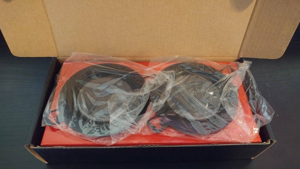

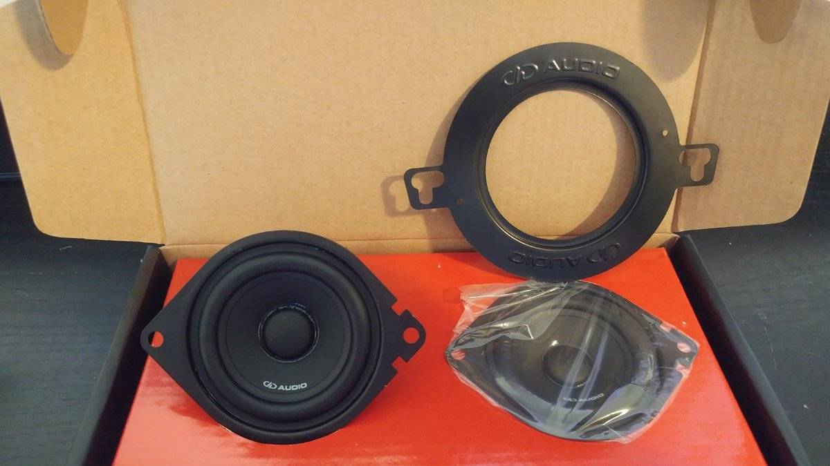

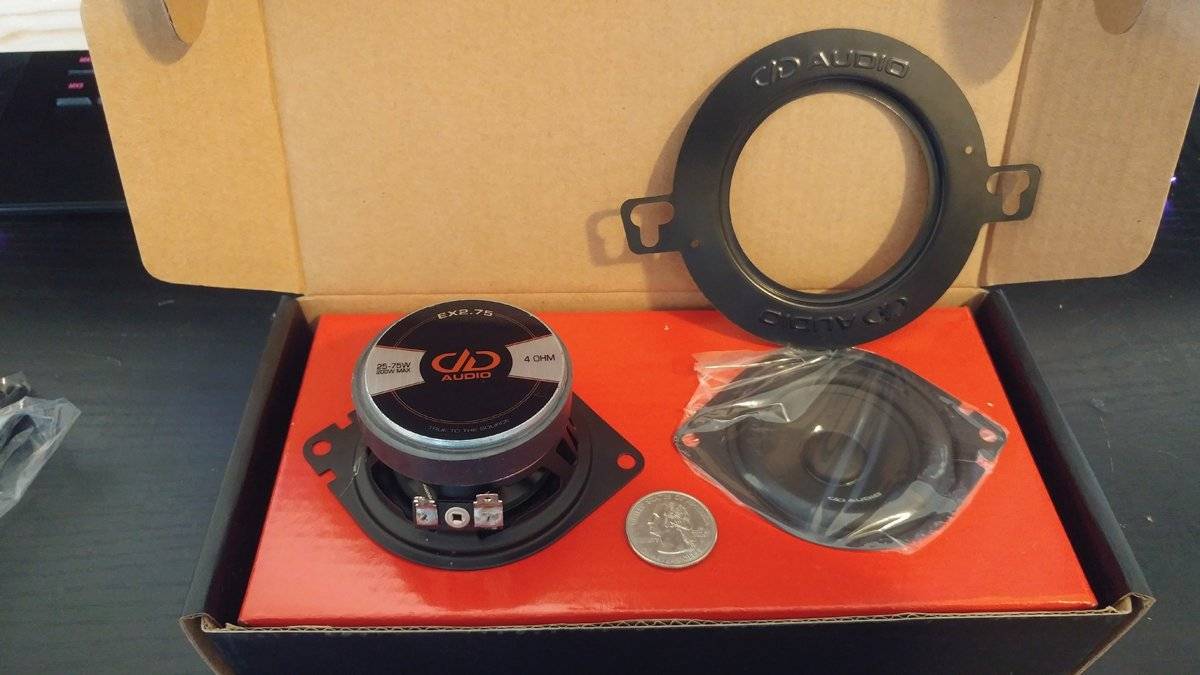

As I said... this is slow going but today I got the first pair of speakers for the Active Build. AND..... It is going to be a three way build!!! I was waiting to pick up my paycheck which wasn't at work yet so I stopped by the car audio shop where I had the credit. I ask the installer if he ever came across 3.5" speakers that didn't have a tweeter on them. He said only in a component set. I said yeah, that's what I found but I don't want to buy a 3 way set. He paused, said hold on and came back with these. These will do perfectly in the factory G6 3-way speaker pods. I paid the tax on them after they used up my credit. They said they were in their sop less than an hour lol. What do you all think?
Here are the speakers. They are DD Audio EX2.75 midrange speakers.
Specs: EX2.75
2.75"
25 - 75 watts rms
200 watts max
4 ohm
F.R. 160hz - 20khz
dbSPL 87

Those should do very nice.I think I have a really nice set of 5.25 DD mids sitting. Ill have to look.
