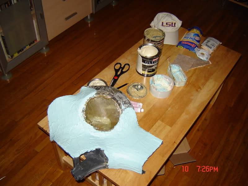

heres some new pics from today, applied a coat of bondo gold then ran out, went to store and found bondo ultimate, supposed to be a little lighter weight and easier to sand, hence the different colors, the lighter blue is the ultimate, definitly worth the extra 2 bucks, more sanding to come tomorrow, and probably the next day.....
[/img]
Bondo blue is the shiz man , definately worth the price difference. Just have to let it cure a little longer before you start knocking down the ridges. Sands almost to easy //content.invisioncic.com/y282845/emoticons/smile.gif.1ebc41e1811405b213edfc4622c41e27.gif
