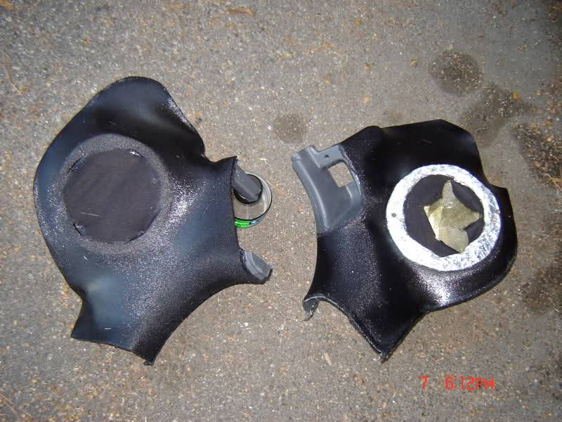

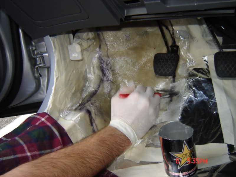

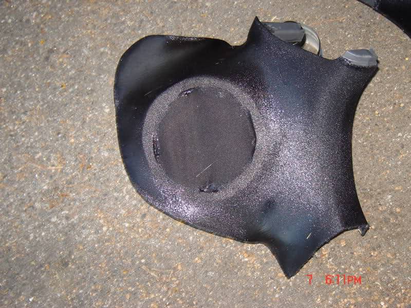

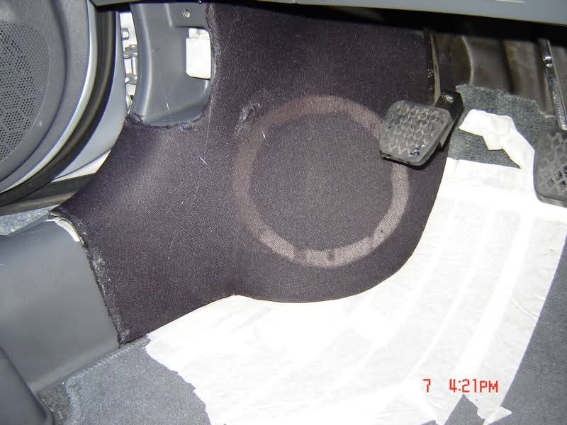

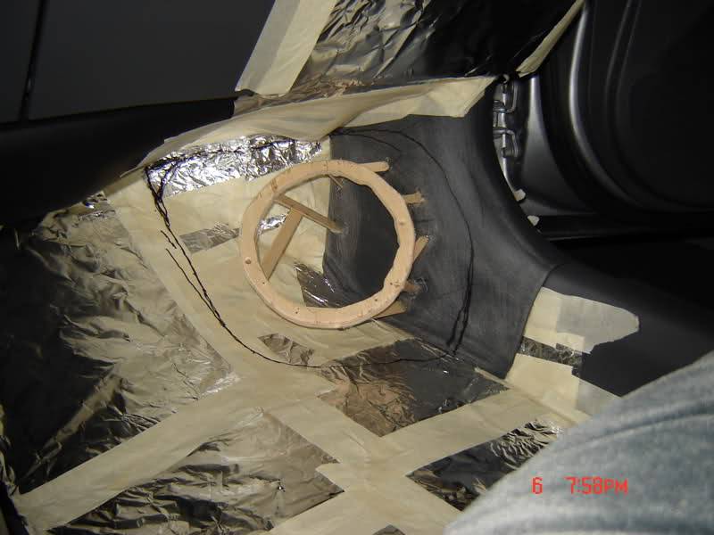

i started fabbing kick panels with my friend paul and dtour. we got lots of pics of the process so we will get those pics up in a few hours.
i have a good feeling that they will come out very nice. tommorw we will finish the kicks and get the vdub detailed. hopefully my new amplicator will come in the mail soon.
stay tuned, good updates to come.

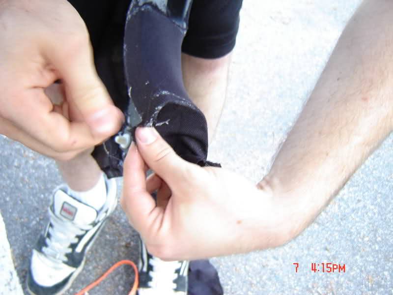

Well here's the pics, will finish the kicks today and have more pics tonight....
[/img]
[/img]
[/img]
[/img]
a pillars are still not done yet, and we decided that the facctory kicks were needed to make sure that the kicks retained the stock look wich was important.
more pics on the way.
pull kick make a mold then cut kick the mold to were u only have the part that shows and mold the rest and then u get the look of factory and a lot more airspace
Could get a whole lot more airspace if you vented them into the frame rails too //content.invisioncic.com/y282845/emoticons/smile.gif.1ebc41e1811405b213edfc4622c41e27.gif
that too. if we have to then we will vent them somewhere. irrigeardless its not big deal. they were IB and sounded great, but them damn door locks had some gnarly vibrations around 100hz - and now they will be on axis quite a bit more - so it will be interesting seeing what kind of difference they give in the two alignments.
happened a lot on lower bass guitar notes. *sigh*
