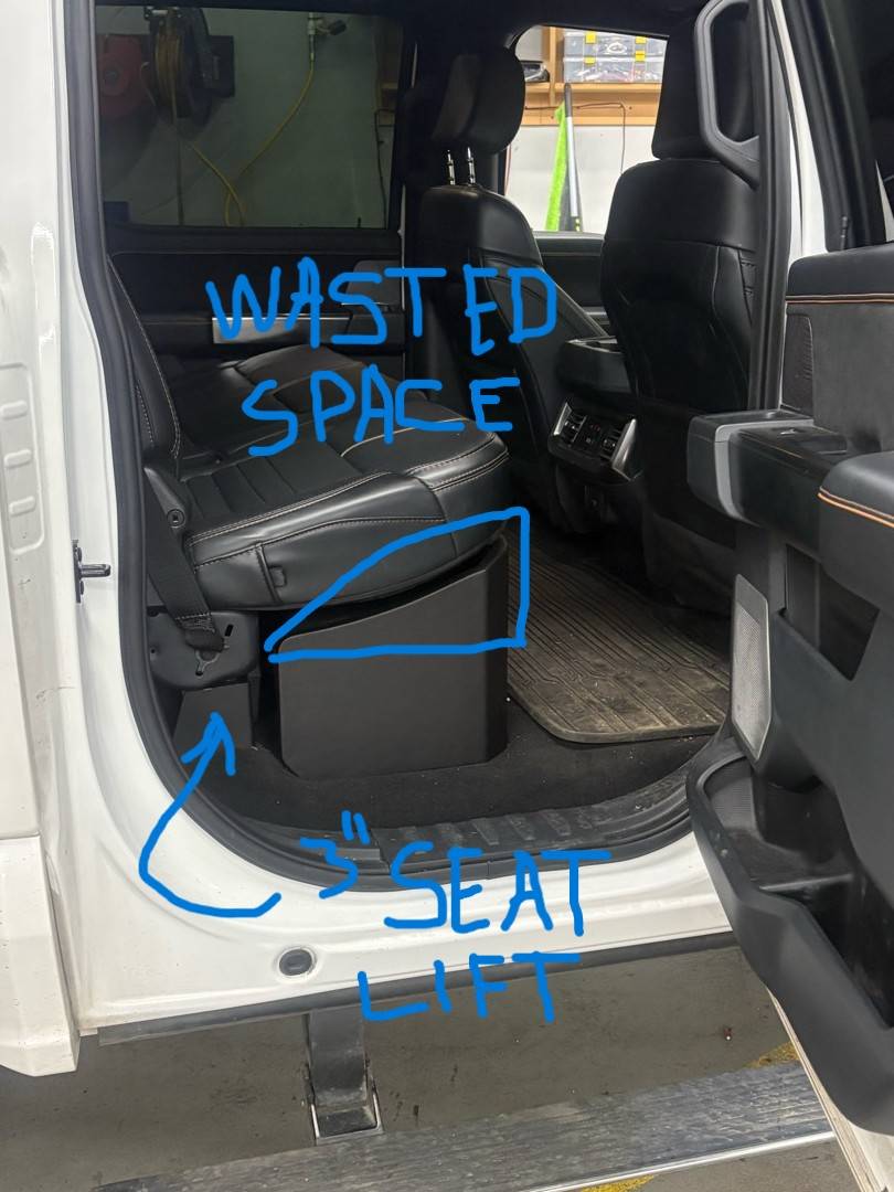

They did a re-tune with my notes and dropped the door 6x9 down to 60hz and upped the volume (not sure what software or parameters they can control for each channel, but he said they could independently control channels) so now the system sounds more full. They lowered the point where the subs peak so there is more bass at lower volume and it helped the sound a good deal at low to mid volume, but now the subs get muddy when cranked. I may have just made a bad decision going with the 4 - 8"s rather than the 13.5 i had before. the enclosure they built is kind dorky- and too tall, I may build another before I abandon the 4- 8"s set up. Thanks for the advice.
