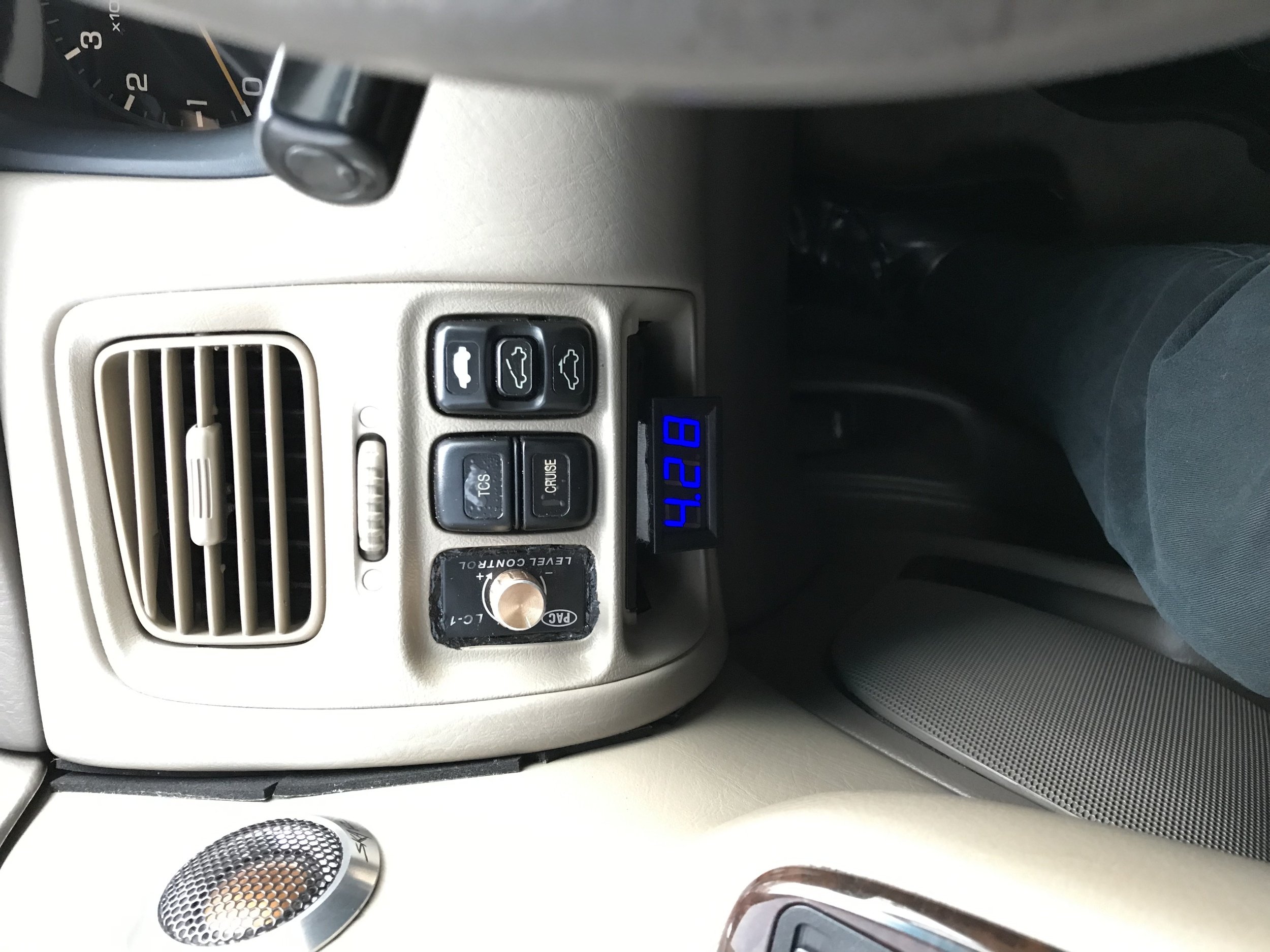

This is currently what my voltage at the amps is at with the car off (notice how dark the volt meters screen is) View attachment 31392
