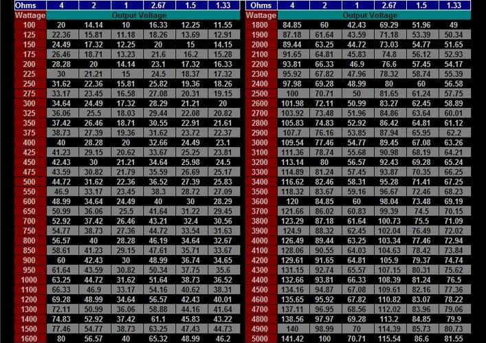

Hang on to this...
So i was doing it correctly. Thanks for confirming. :). Was told i might be able to give my sub a little more in its sealed box but ill see
Those numbers on the chart are exact. You can use a volt or two more if you don't hear distortion. For subs I would use a -10db tone and the corresponding exact voltage on the chart. For that little extra headroom.
