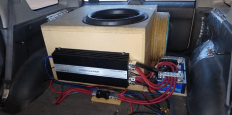

Battery to frame, in back and up front. The amout of wire I've thrown at the same problem makes my wallet cringe. Dual output lugs on the alt just makes excessive wire more needed imo. Fyi... thats a Jp63 setup above done by someone who doesn't do it twice. 3 runs of 2/0 from the alt to the battery delete with excessive wiring in back (cmaxx in the rear) and what you see is a battery delete. Playing with power and doing it right is baller territory. The piece de resistance...
Imo a jp63 needs a ton of electrical having a 600a draw on paper. Above you see 3 runs of 2/0 to the battery delete. I wonder what's clinging to the frame on the run back from there. I started a thread about this build but I'm just a fly on the wall. I suppose we'll see.
This was a legit 3K setup so take a look and draw your own conclusions...
