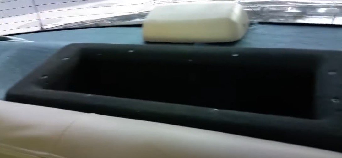

Don't have to remove the seats. Just cut the rear deck.

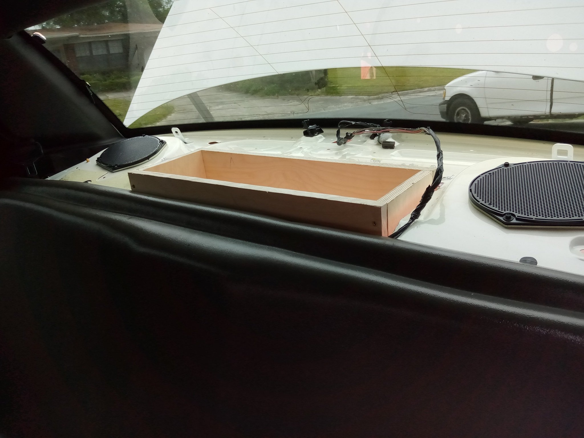

I would go back to the board with your box. Maybe its me but that box doesn't seem big enough for 4 12's.
The trunks on those town cars are huge so if you have the space use it
Slot port it like the one shown or do two round ports up through the existing speaker holes.

4th order bandpass porting up through the rear deck (like Pop's video) is your best option to get sound up front in a car like that but it is not a simple project and would be easy to **** up or make something that looked super ghetto. Shitcanning the back seats and doing a B-pillar wall would be an easier project IMO.
I also don't think 8 cube is quite enough to do 4 12s right and I suspect you won't have as much volume as you think you do, so might want to revisit that topic as well.
