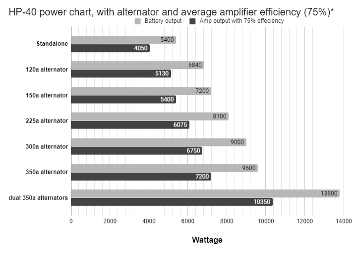

I'm getting a 370 amp alternator and a lithium hp-40. the chart says it can take a 9600 watt amp with a 350 alternator, so why not get stronger amps if i am spending more on a battery?

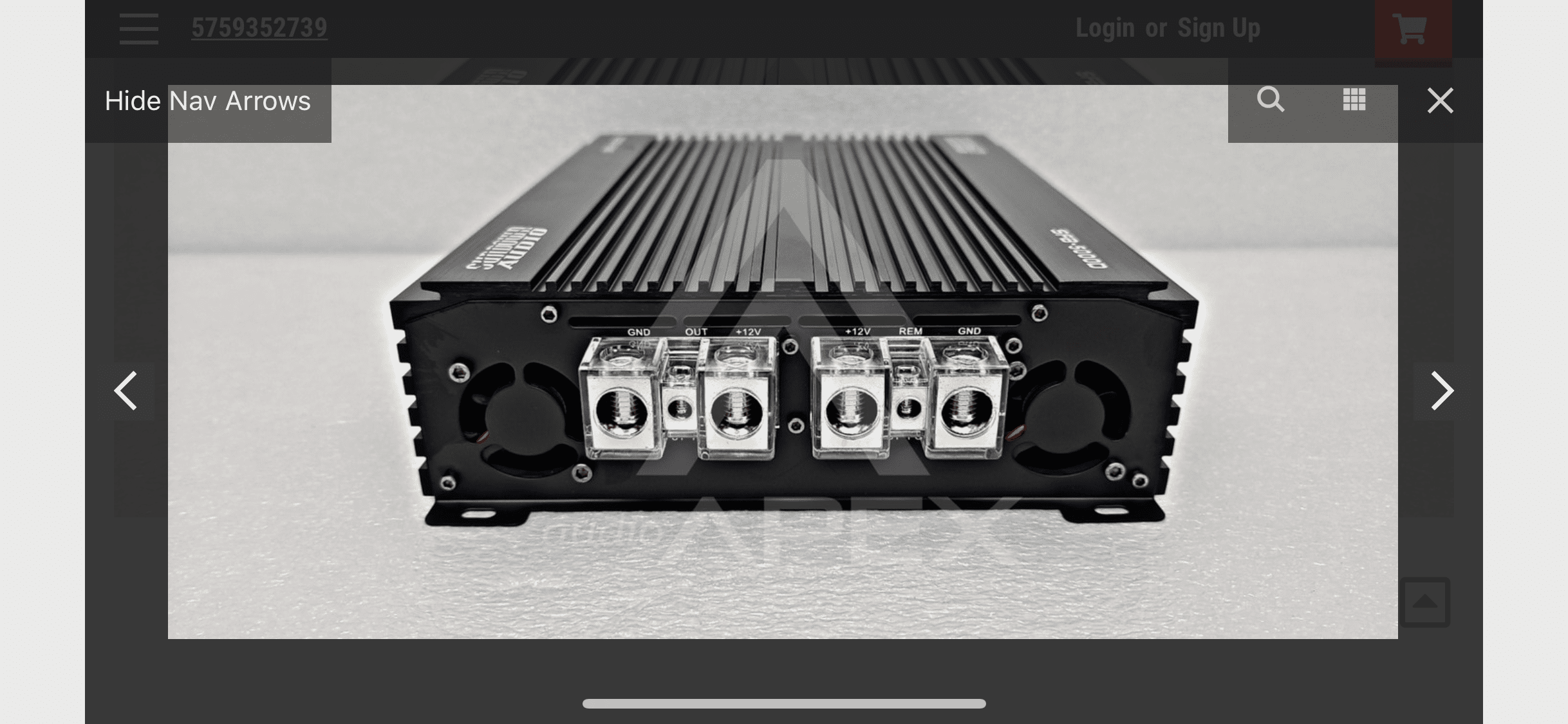

Is this wiring as simple as it looks? You can connect the power through 1 amp then pass it to another from the outputs? Man I wish I could sell the 4 ohms I got, but I keep getting lowballers
27819
No it has dual inputs. Amp needs two powers and two grounds. Only the remote wire has an output.

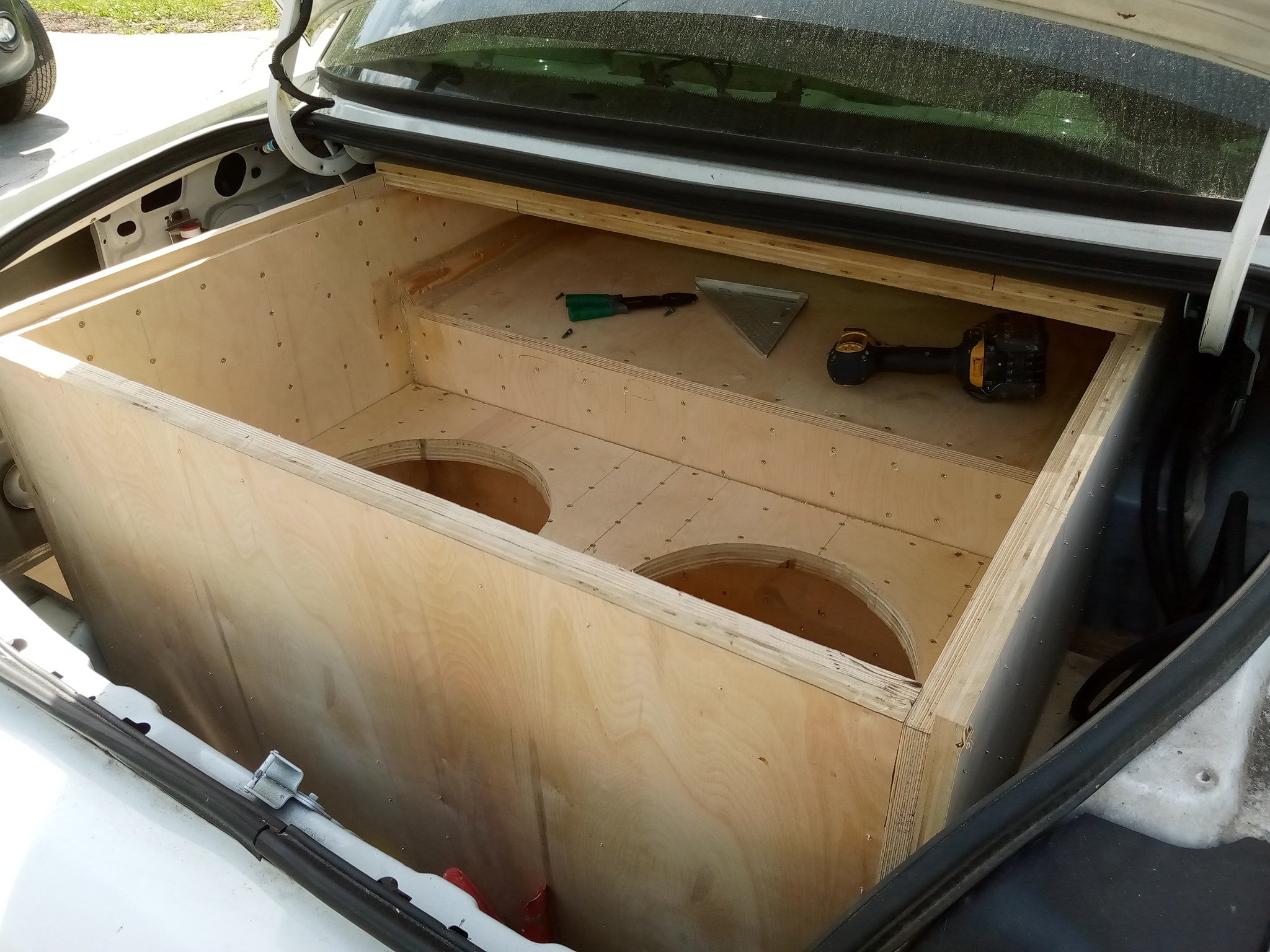

Those town cars have sealed off trunks don't they? Best bet would be put the two 12s in a 4th order blow through.
This is in a crown vic with two 15s. Port through the rear deck.

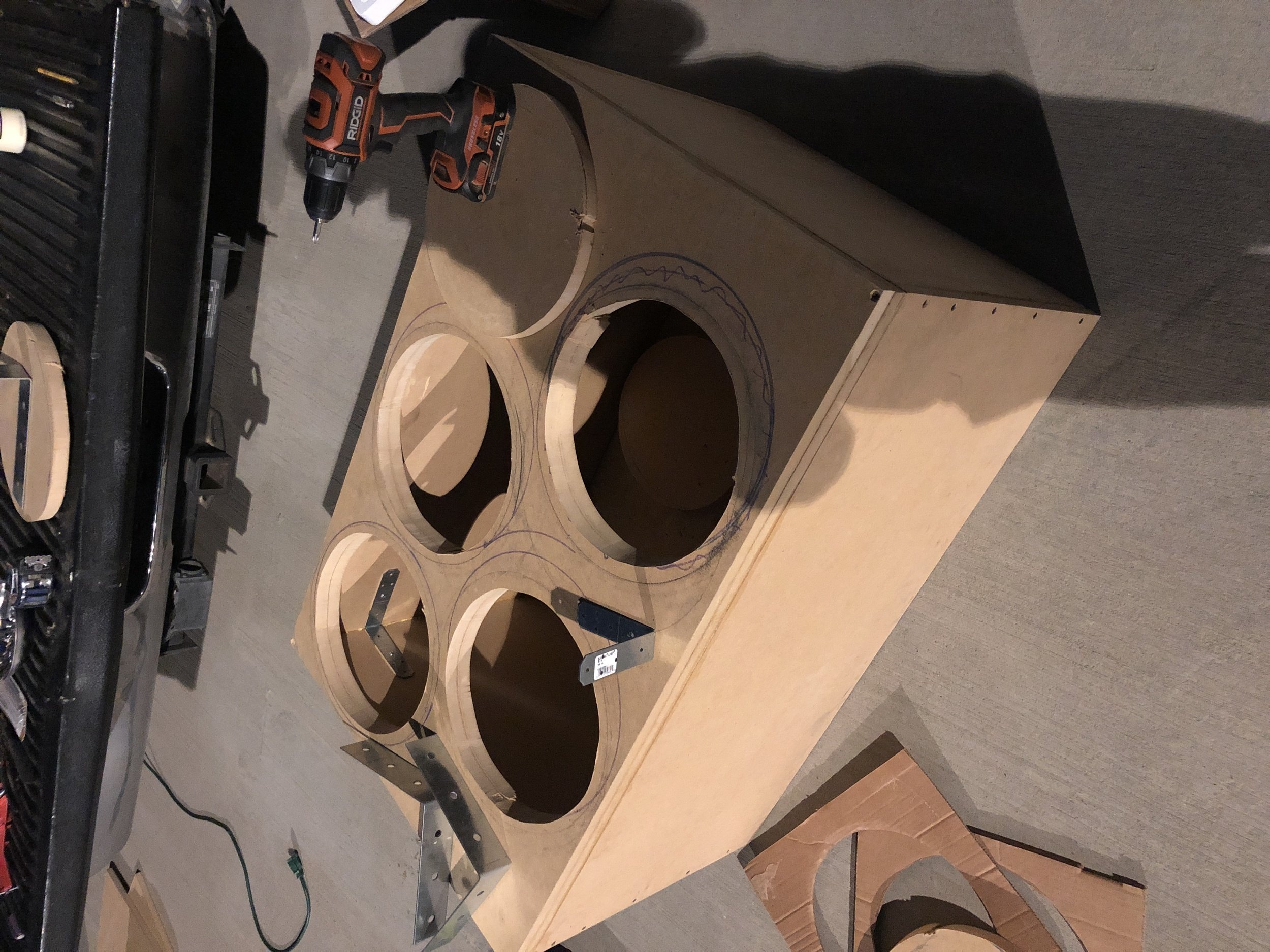

Dang I wish I had posted here before I started. I got all sorts of advice elsewhere that wasn’t the best. Here’s the box I built already
I know I’m gonna get good SPL with 4 12’s. I’m still debating if I want to tear out the back seat.
Good luck with that. The specs they publish for that look extremely dishonest, and trying to run 10,000W off a 40AH LiFePO with 2C rating before losing performance and cycle life seems a terrible idea.
Also be aware that Jacob rates those subs at like 1500W for a reason and if it isn't Sundown or the authorized dealer who sold you the subs telling you to run double that power to them you're not going to get warranty service if you blow them up.

Please tell me thats not a sealed box for X12's

Hahaha and hell no, not a sealed box. The cutout under the drill on the right is where I am gonna bust a hole for the port. I wanted a 12” tube but it’ll be tight so I’m going with a 10”
i plan to put a couple 1” dowels for bracing
Wouldn't be over powered though. I run a full bridge 3k on my single X15. No where near too much power after impedance rise and voltage drop. IIRC I clamped around 1130ish rms.
I don't think a single 10" aero port is going to be enough port area or get your tuning low enough with the length you have to work with.
