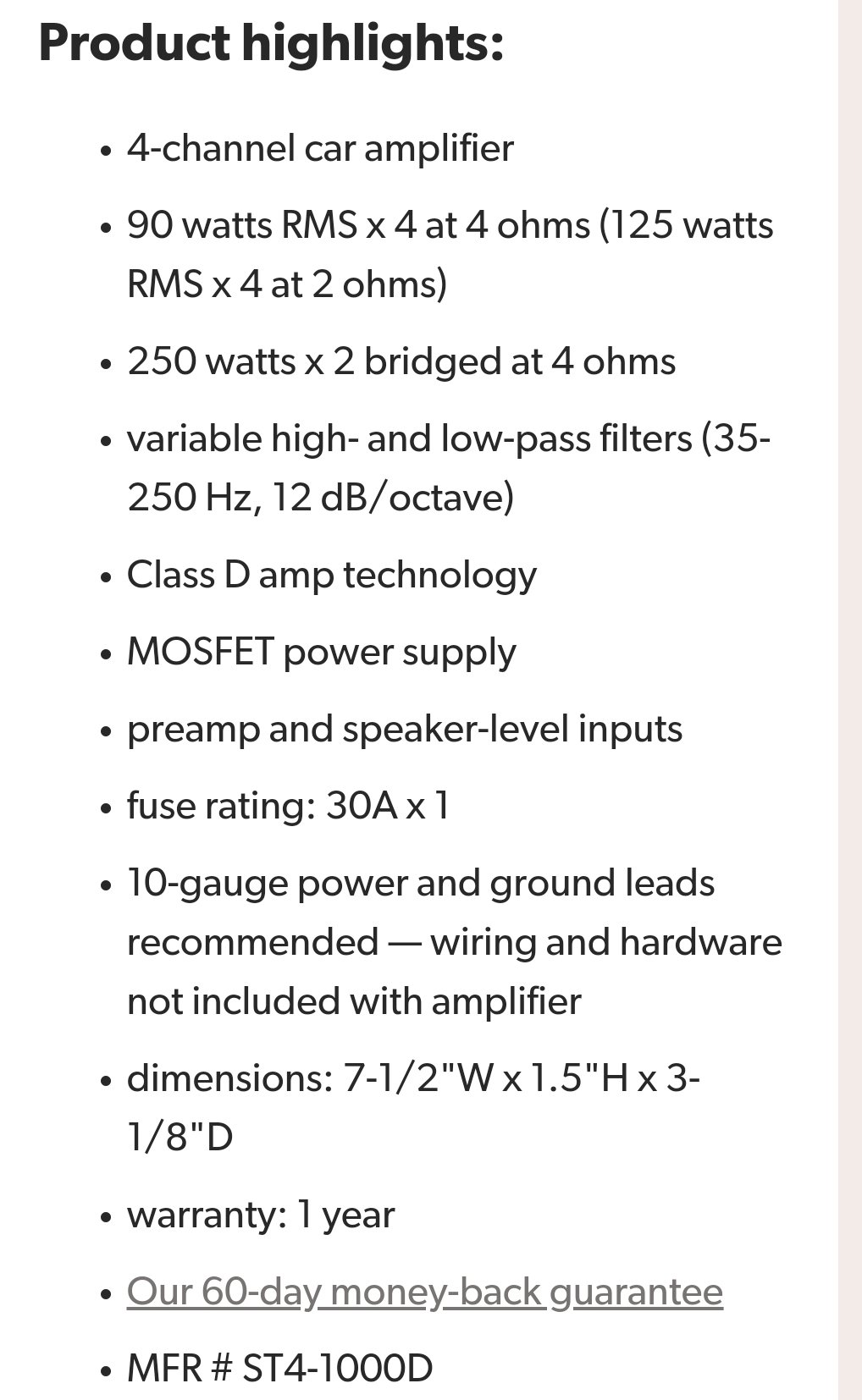

From there run 2 of these amps
25584
25585
This would let me run 90 watts rms to each tweeters and each 3.5, and then bridge the second amp to run 250w rms to each 6.5. Now, I know soundstream does not get much love. However, ordering through Crutchfield gives me confidence that even if its shit I can get my money back. These amps are tiny, and I could mount them behind the glove box, and would give me more power for a little more money and sacrificing amp quality. The DSR1 would also allow me to tune my subs with a dsp as it has 8 outputs.

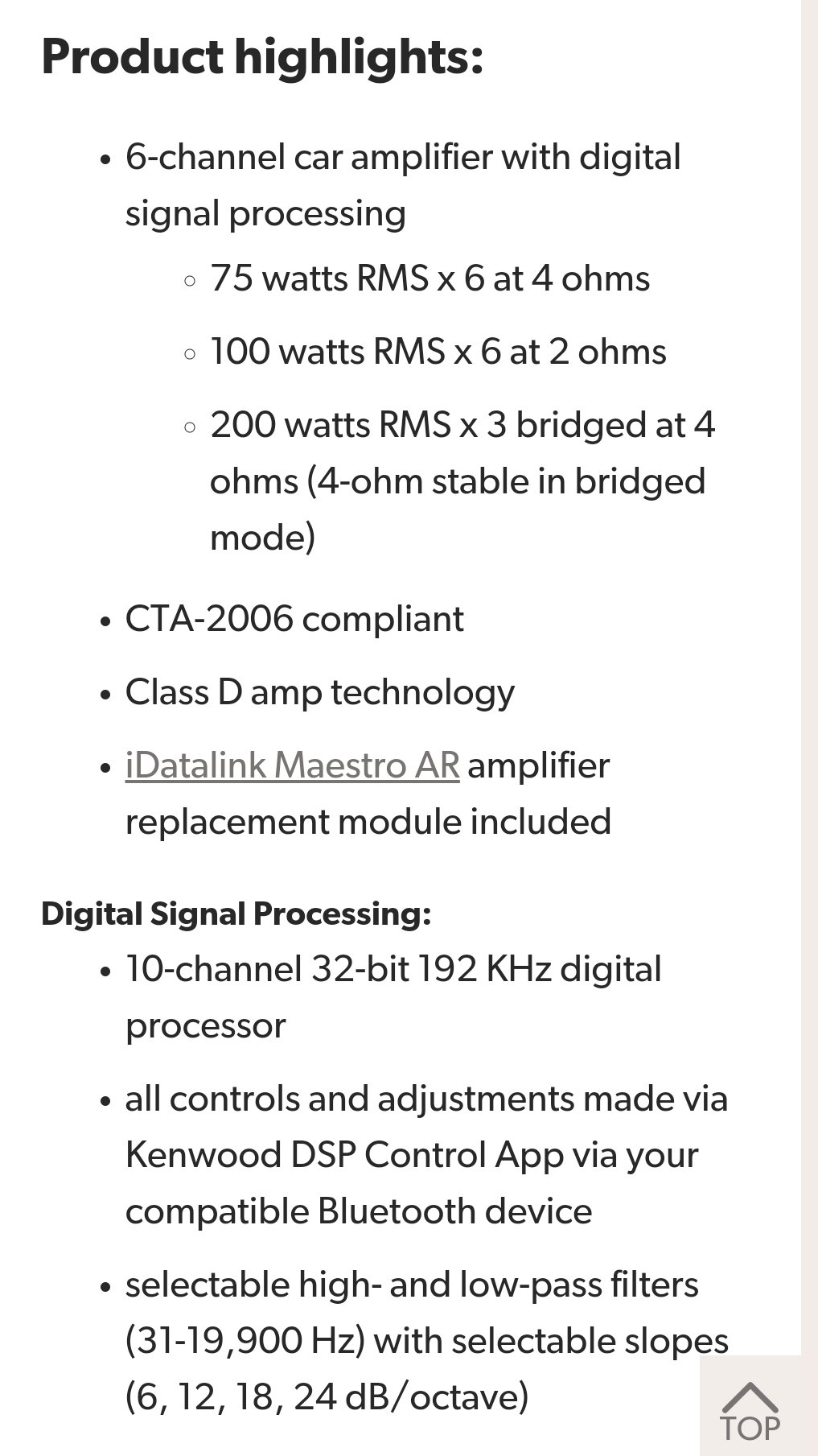

Option 2. $500. Run this amp
25586
25587
This option gives me a better quality amp, and possibly a more reliable dsp. Its cheaper, but mounting area will be more of an issue. The big thing is that it limits all of my speakers to just 75w RMS.
So. What would you recommend?
you’re right about the soundstream, but it isn’t a horrible amp actually. you could do worse for sure. I wouldn’t try to run it at a full 90 watts rms per channel personally. I’d probably match it with 75 watt rms speakers or less, and it would work decent.. That Kenwood looks intriguing to me. I have zero experience with Kenwood amps, but it looks like something I would definitely try. It seems like a decent option.
Thats kind of where I'm at, they both feel like good options. I think 75w to the 3.5s and tweeters would ultimately be fine, and that's what I would get with the Kenwood. However, this would allow me much more power for 6.5s. Even just putting 150-200w rms to each 6.5 I think would allow me to pull more out of my system vs 75 watts. But maybe not, maybe 75w is enough for the 6.5s from the Kenwood. Thats why I'm asking here, I'm really not experienced enough to know.
I’ve seen that soundstream in some other people’s cars before that I’ve built sub enclosures for, but never ran it myself. They seemed to perform OK, but I’m not sure about getting 90 watts rms from it. None of the soundstream amps I’ve seen had a DSP involved in the system either. I have zero experience with kenwood amps, but I would think kenwood would definitely be the higher quality product.
Oh no doubt the Kenwood is better quality. I have never ran their amps, but I've read great things about their excelon lineup. Its strictly a power concern. The mounting options on the soundstreams are a bonus as well.

I have a hard time believing that a 30 amp fuse is going to allow for more than 300-350 watts total maximum RMS power. I'm not sure if I'm buying those ratings at all with the soundstream. I think you'd be looking at more like 60 watts per channel or something. How do you produce 500 (250 x 2) watts with only 30 amps of fusing? 30 x 12 is 360. 30 x 14 is 420. Maybe you'll get 500w @ 16v lol. I smell something fishy.
