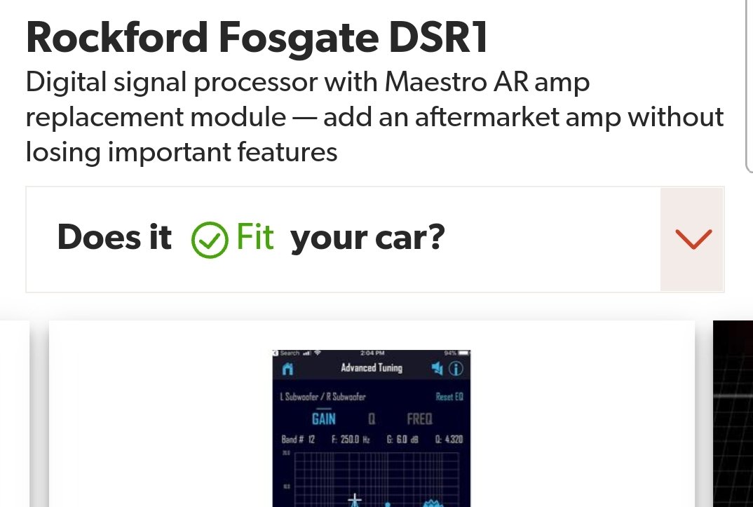

Alright so I'm thinking...
24743
To integrate into my factory wiring grabbing signal before the amp so it isn't processed, and allow me to tune it for my active setup.
