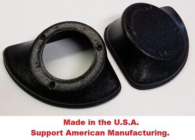

Wow, 4.5" in the doors and 4x10"s in the rear package tray, 2.34" in the corners of the dash. REALLY old school! 4.5" drivers in the doors. Sounds like it's time to get out the hacksaw, cut new holes. If you can, then go for the 6.5" NVX comps up front and since you'll have bigtime bass in the trunk, maybe some matching 6.5" or 5.25"coax drivers from NVX in a small-sh pod on the rear tray cross tem with the HP to the rear at around 200 hz. You don't want them venting out the back as the subs will destroy them. Closed up, they should do fine from 200 hz up.
Can always build a new tray and use those pods, screw them down, do a little glasswork, could be pretty nice. As for that Taramps 3000, it Is fine. Their smart bass is the go to for sort of budget fullbridge model.
