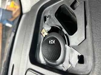

Do you know anyone who would know what size spade connecters the nvx speakers use? I know I asked before but the customer service didn't know and they don't check their email. Also my hardware store doesn't have it. Is their a form I could ask in?
The larger side is 5mm the smaller side is 2.28mm, as measured by my calipers.

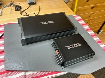

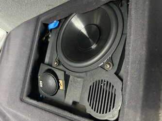

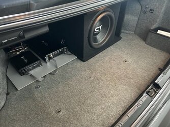

Hi Doxquzme, just wanted to share with you that I finished my system. It far exceeded my expectations, everything worked perfectly and it sounds amazing, just wanted to thank you again for all of your help. Have a great new year!
Nice build, looks awesome! Glad it worked out, ENJOY!!!
