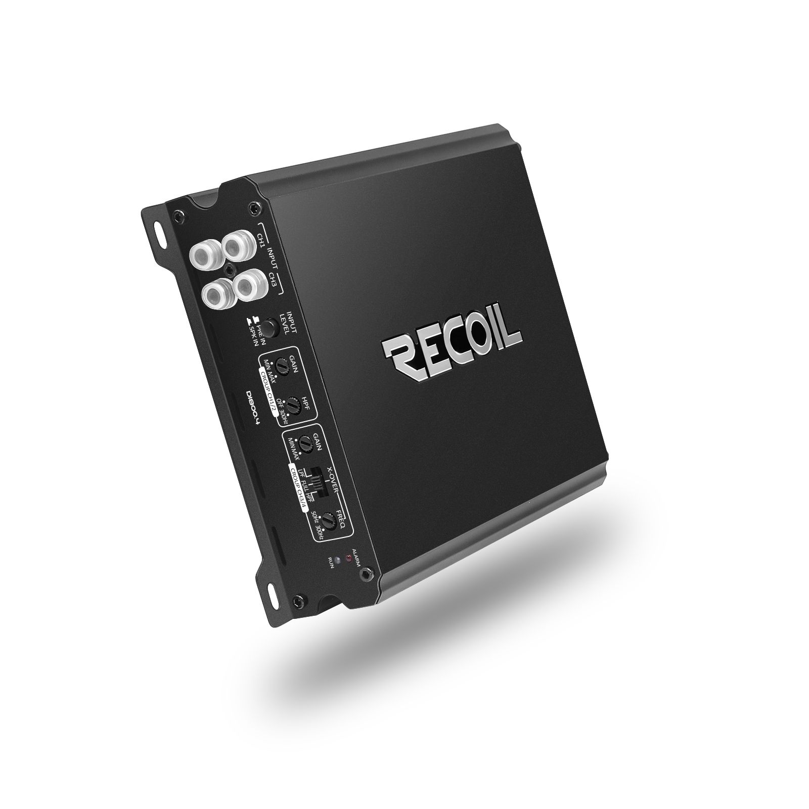

I think you linked the wrong amp. The subwoofer is 1 ohm, that amp only does 2-4 ohm. I am going to list the exact system Im doing below just to confirm it with you.
Amazon product ASIN B09D2GSBGB
https://www.amazon.com/gp/product/B0BZ4JS2Y1/?tag=caraudiocom-20
https://www.amazon.com/gp/product/B00N84TRRW/?tag=caraudiocom-20
https://www.amazon.com/dp/B08TBSYYCX/?tag=caraudiocom-20
The di800.4 is currently unavaible now. Do you know if it will ever be back? I want to use that particular amp because I all ready ordered the other recoil amp. Also what gauge wire does that amp take (di800.4)? Also, is a 120 amp fuse good for the subwoofer amp? Thanks!
THe 4 channel is 2-4 ohms stable and is available on the Recoil site, direct.
$125.99
The RED 1200.1 is 1 ohm stable so you're good to go on that too.
