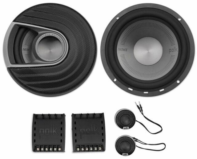

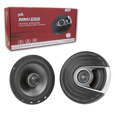

Front speakers. For the money. CDT, Polk MM and NVX "X" series are solid performes.
Reg. $500 on sale for $299
Rear
Front Polk $220
Rear $120
