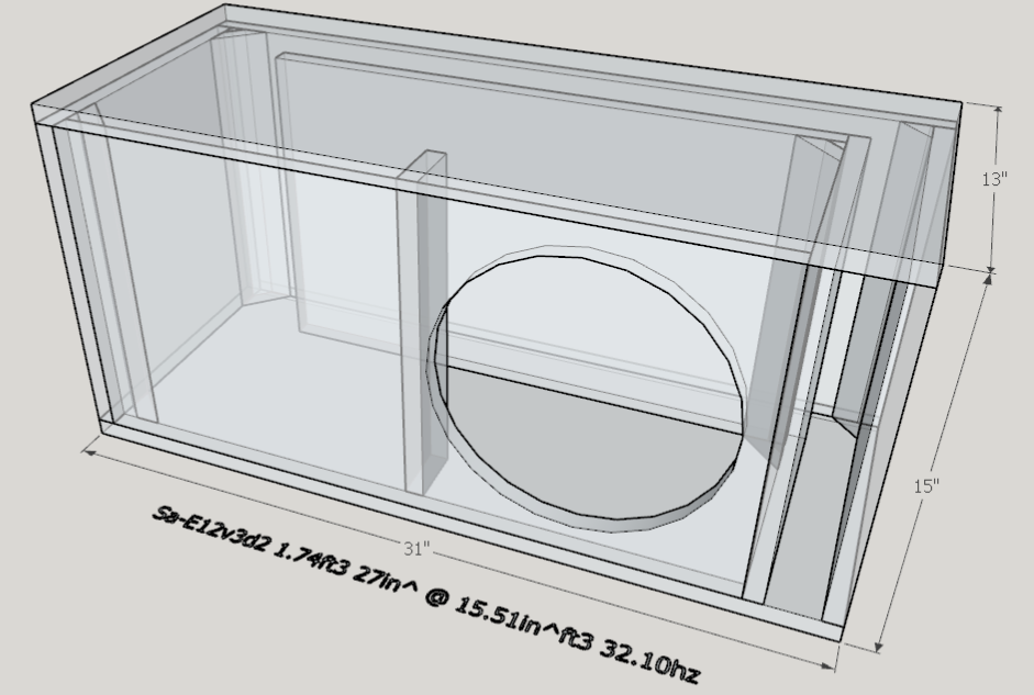

Make sure this'll fit... I stayed close to Sundowns recommended box specs.
If you'd like plans Pm me and we'll go from there.

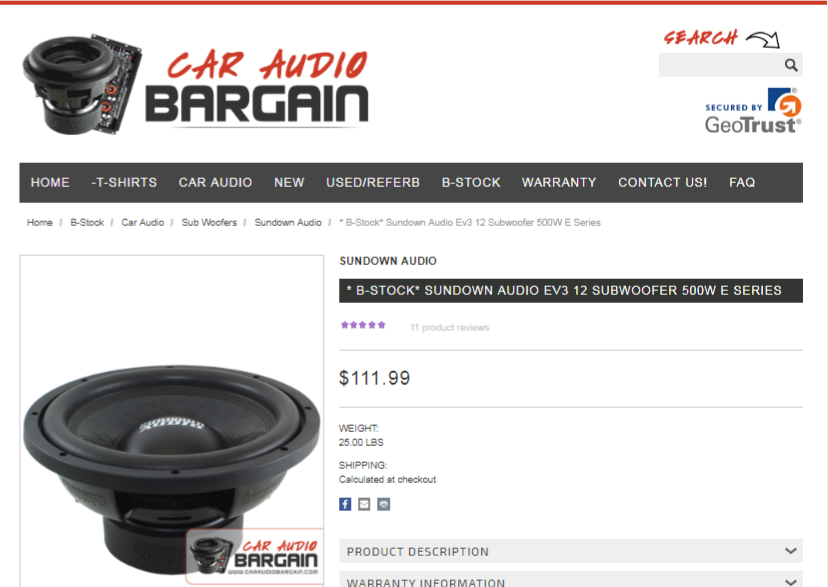

Ok... idk your budget but an 12ev3, in a diy Enclosure and a S1-850 amp  is a fairly inexpensive decent bass option IMO.
There are cheaper subs that would easily out preform what he was originally looking at in the right box of course. Idk 260 plus wiring kit and some MDF seems well within his 500$ budget. I'll take a stab in the dark and say building a box is the issue. No idea what it cost to have a box built but even if all ya have is a circular saw and a jig saw it can be done... Really not too difficult to build box if that's the issue. Especially if someone else has done the design work.
So I've totally disregarded the DS16s after a little research, but I am totally brand new to all this, so pardon my ignorance 😂 - but you guys are recommending just the single 12" sundown with the S1-850? I could get a box built I'm sure, should I go sealed, vented, or bandpass? Should I go for a system with individual parts picked? Do prebuilt systems just not preform as well or are they overpriced?
